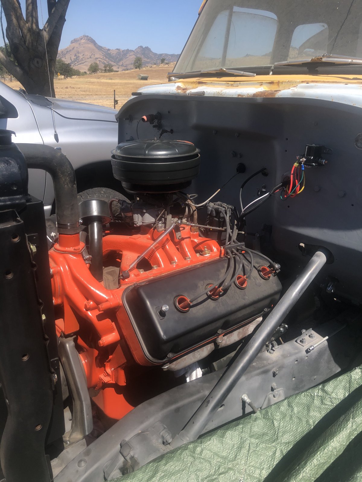

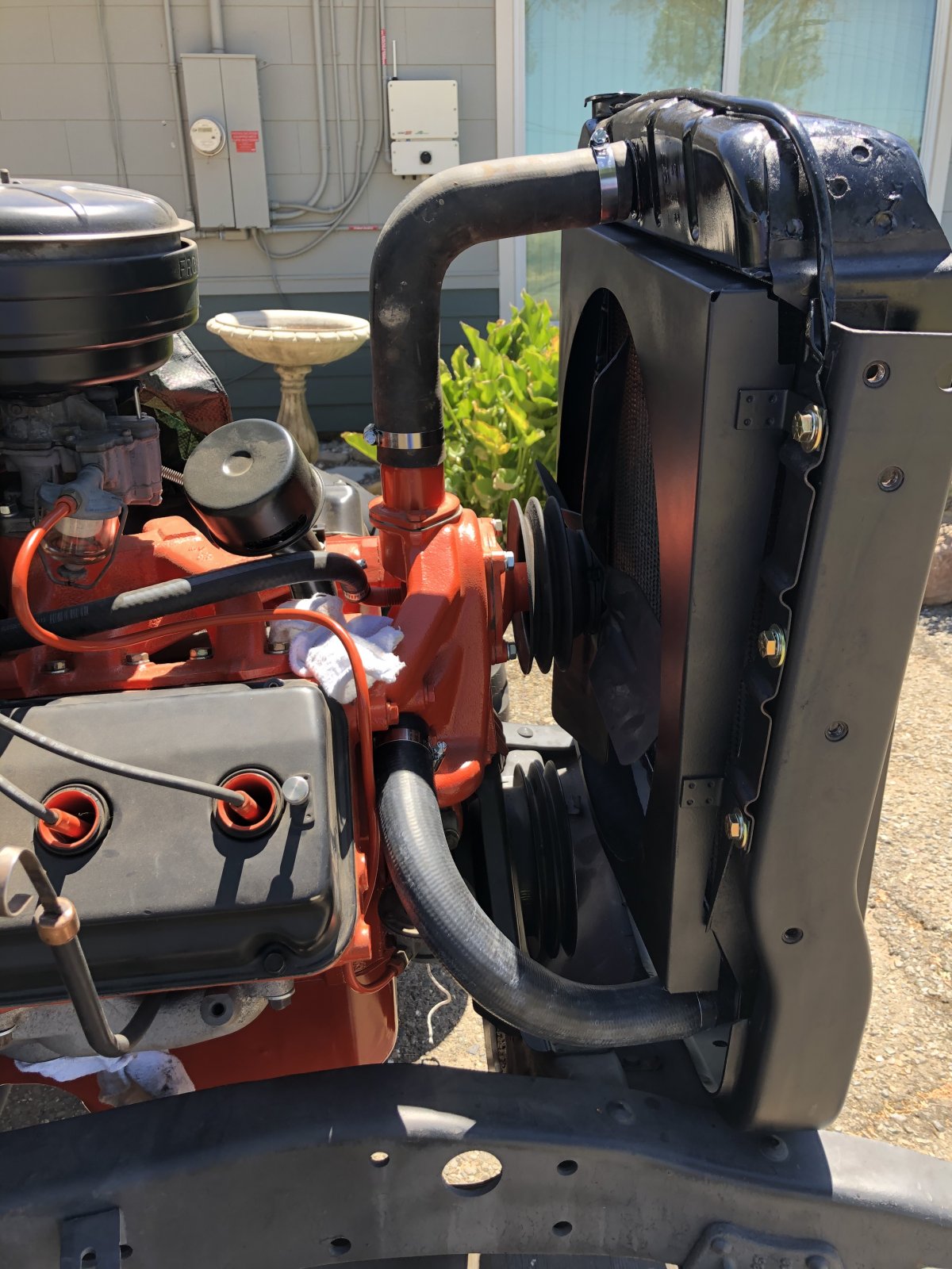

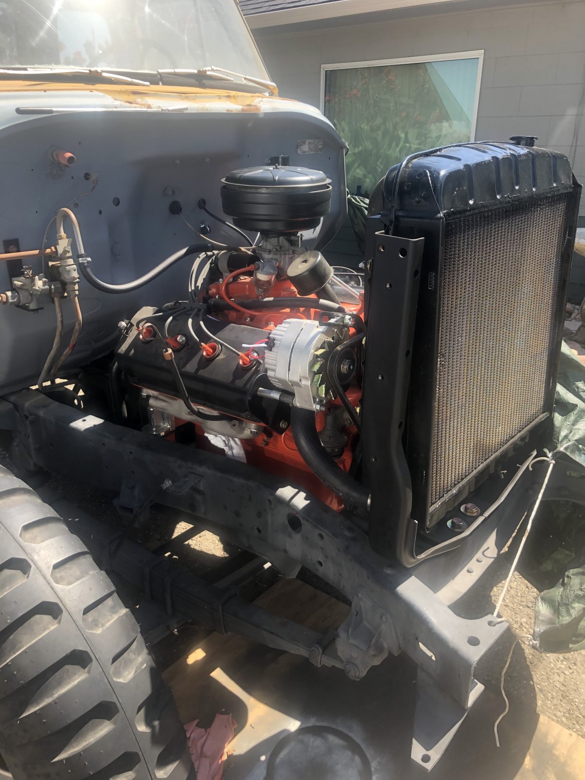

    784985D6-90C3-4A2E-97AA-0DBA67901040.jpeg 9290245A-E143-4112-9847-E53D50BDDE81.jpeg
    Jokester. It’s a 1954 Hemi just rebuilt bored 30 over. That’s it! Everything else is original. Recored radiator, it’s huge! Original shroud. Fan is moving lots of air in the right direction. It’s on a C1 truck. Stat is 180. I tried 185 and had same heat issues. Runs 160 without the stat. I gotta be missing something!

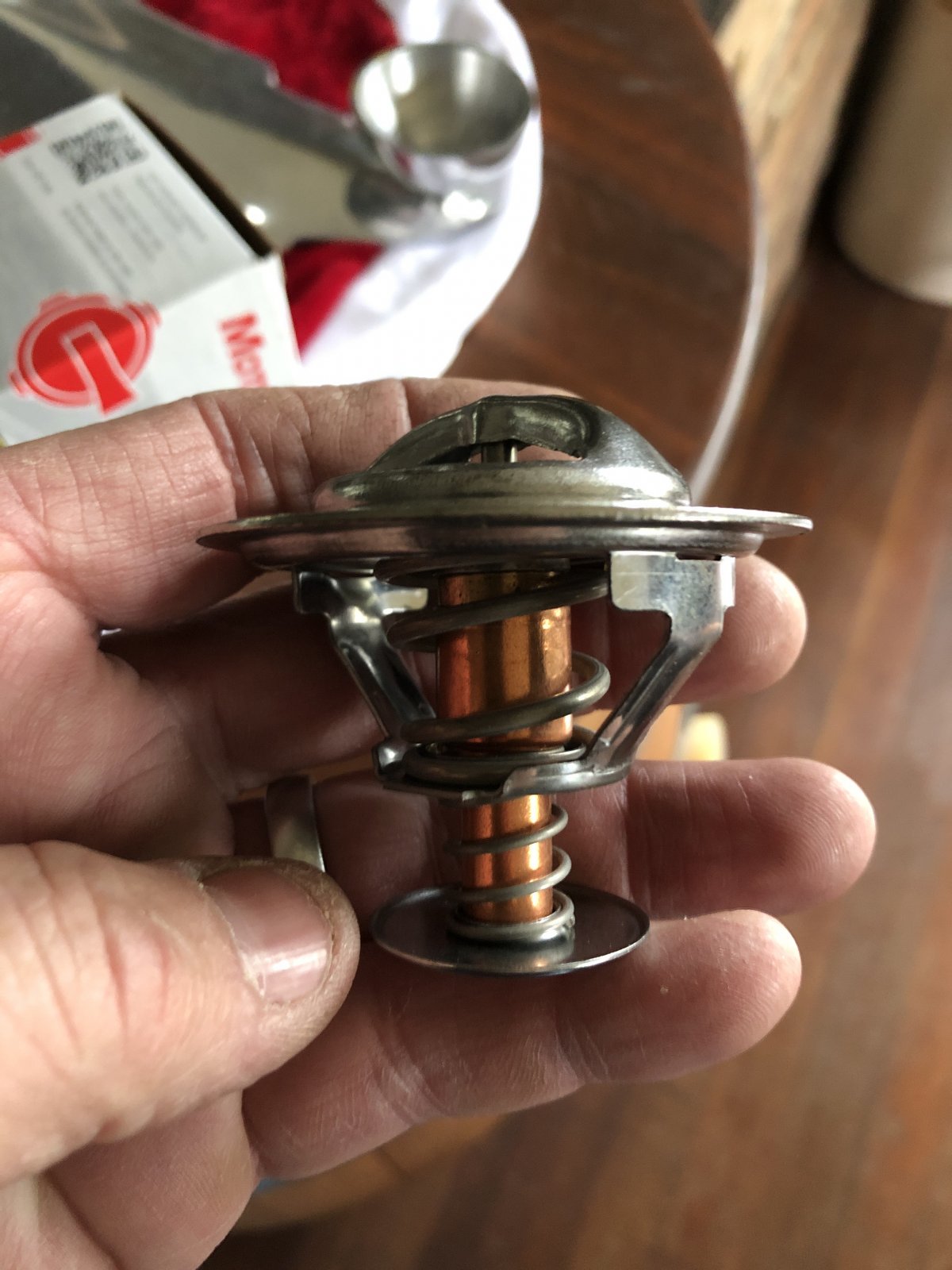

    I wonder if that is the correct thermostat? The reason I am asking is, as the stat that you have pictured opens, the bottom half is supposed to block off the byp*** line. That type of stat was often employed in later model cars and may not be correct for your '54 Hemi. It may be preventing the stat from opening correctly by bottoming out in the housing, and hence why you don't have a problem with the stat removed, but do with it in.
    You may need the style on the left.

    Drill a 3/32 hole in the flange of the thermostat. This will allow for steam, and any remaining air to escape.
    I have seen engines with air in the block make steam pressure behind the thermostat without opening it. One little hole fixed it.

    That Summit photo is not a high flow unit for a MOPAR. I use one in my Y block they have the same outside diameter.
    With a heat gun check the temp before the thermostat and after should be the same with a high flow, top of the radiator and at the bottom, there needs to be a drop in temp.
