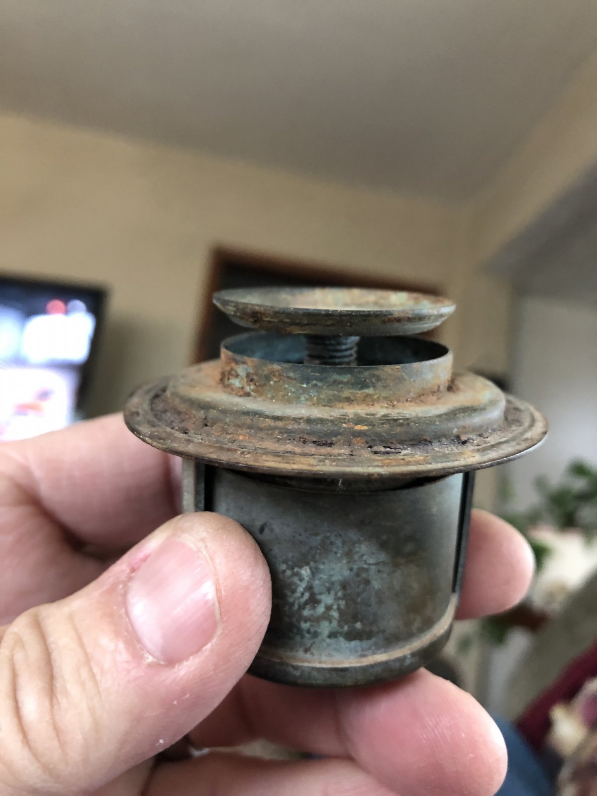

    Just for the record, water boils at 212 degrees when its not under pressure. If the temp is 220, I would expect it to be boiling.
    Drill the hole (I always drilled an 1/8" hole, but 3/32 would work too) in the thermostat like others have said. The hole allows the air pocket trapped under the stat to escape. The hole needs to be in the flat part inside the sealing ring (like the little br*** spot on the Summit stat shown), or get a stat like the Summit one posted. You already have 2 stats, drill the hole in the 185 stat, you have tested it and you know it opens at 185.
    Dan Yager likes this.

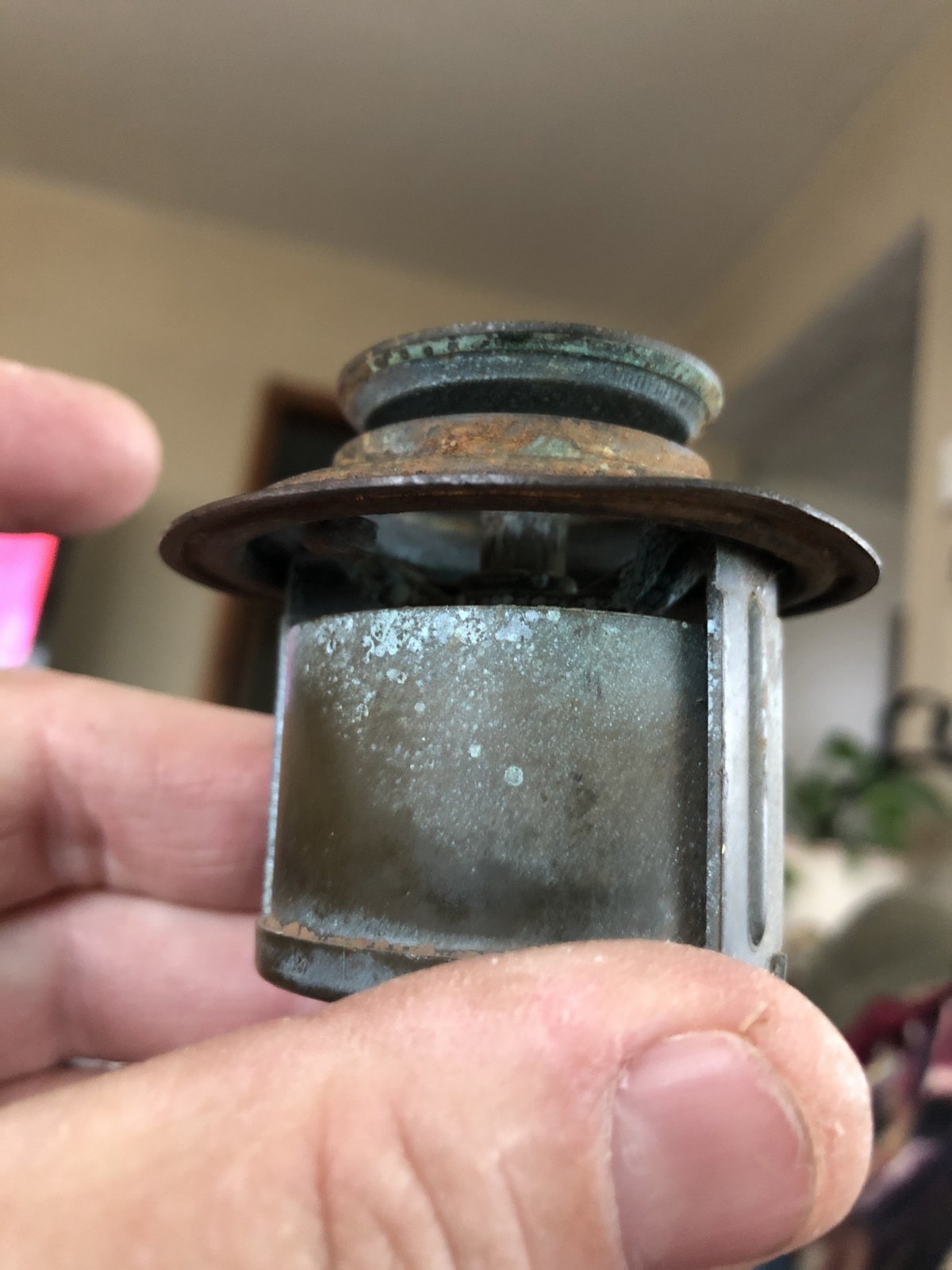

    Gene koning I’m going to drill the hole! I found the original stat and the opening is twice the size of the one in there. Should I look for one like the original! More flow? Pic included
    connielu likes this.
  6. gimpyshotrods
    Joined: May 20, 2009
    Posts: 24,636
    gimpyshotrods
    Put that one back in. Drill the little hole first.

  8. gimpyshotrods
    Posts: 24,636
    gimpyshotrods
    The "correct" thermostats for these old engines are, in many cases, out-of-production, and have been replaced with subs***utes that "might work". The trouble is, might is also might not work.
    When in doubt, go original.

  12. sunbeam
    Joined: Oct 22, 2010
    Posts: 6,422
    sunbeam
    If post 36 shows the orginal stat the one in post 15 is the wrong one.
  13. gimpyshotrods
    Posts: 24,636
    gimpyshotrods
    Yup, and sadly this is not uncommon.
    Many of the "also fits" thermostats that I have seen simply are of the correct diameter, so they seal, and do not exceed the external dimensions of the original, meaning that it will "fit".
    Will it "work" properly, or just "fit". That always remains to be proven.
    If anyone has ever tried to buy the actually correct thermostat for a 351C, you will know what I mean. The ones that the parts store drone will sell you will lead to an instant overheat condition.
    Wanderlust and Dan Yager like this.

    I have condensed this down to the posts that are the key to your solution.
    1) Radiator cap pressure only controls the boiling point of the system, not the actual temperature.
    2) If you don't have the issue without a thermostat, then the thermostat is likely the problem.
    3) It is more likely to be that the new thermostat is not opening properly, or at all.
    4) If it runs at 160 sitting still with the old thermostat, your radiator, pump and fan are most likely adequate.
    5) Make sure the thermostat is opening correctly when installed, and drill the byp*** hole in the plate.
    I would be very surprised if your problem persisted after doing these simple things..........:)

  30. Dan Yager
    Joined: Jul 1, 2021
    Posts: 175
    Dan Yager
    Mr48chev. I’m hearing your words. The original stat I posted a pic above says it’s a 165. I have not researched a bunch on the 241 rebuilt temps but I need to do I can really see what hot is. Radiator is huge and big air is moving through it. When the temp hit 220 with a 180 stat it wasn’t puking water at all. Maybe I’m just paranoid. Ha!
