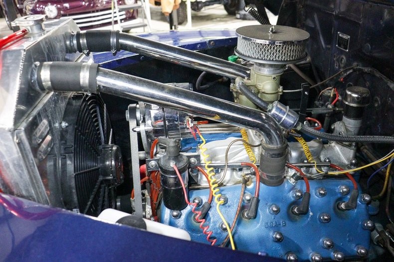

    Hey everyone, hopefully I'm not jacking this post but it seems like the correct one to ask my question. First off, just joined, I'm new with cars, and just got myself a 1947 Ford Super Deluxe with a flathead V8. Previous owner installed an aluminum radiator. It has a pressurized rad cap (maybe 12 psi?). No engine overheating problems but the rad cap keeps building a lot of pressure. First drive, cap blows off and lose about half my coolant. Refill, make sure the cap was on correctly go for a shorter drive, cap is on but smoke is coming out of oil filler/breather even with engine temp around 170ish. Next morning, I go out to see if I need to add any coolant and just check it out and I take the rad cap off and it blows a bunch of cold coolant out of the radiator. Lots of pressure in there. Anyone know what is going on and why it is building so much pressure? Thanks for the help! Radiator and flathead enfine 47 Ford Deluxe.jpg

    Unfortunately that doesn't sound good, especially if the pressure remains after it cools down. Could be combustion pressure getting into the cooling system (head gasket ?).
    Also, check that the overflow is not obstructed.
