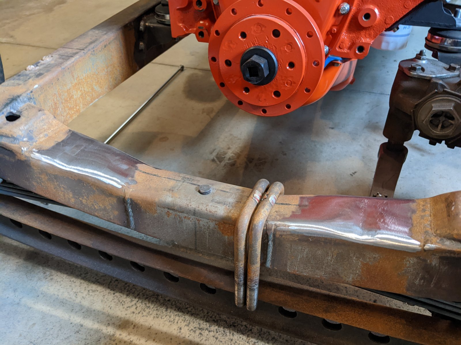

    My grille shell & radiator combo sits up about a half inch too high. Upon further investigation, I found that the bottom angles on the radiator are sitting on the cross-member.
    What's the solve for this? Modify the Walker radiator (unused), or the cross-member?

    You need a rubber cushion between the bottom of the mount and the cross member. HRP

    Id cut the crossmember but ive modified both crossmembers and radiators in the past. Less steps to deal with the crossmember

    Radiators have to replaced someday, crossmembers don't likely. Thus I would mod the crossmember and keep the radiator stock. Your future self will appreciate when he is installing a new radiator someday. But before you go to the h***le make sure your radiator wont sit too low after the mod and make the hood run down hill when all is ***embled

    It's a 32 Ford roadster with a pinched 32 frame. The cross-member has been modified, but that modification did not affect the height of the radiator mounting pads.
    I am running a full hood. On the radiator side, the vertical edge of the hood is 1/2" (exact same measurement as the Gap I have underneath the radiator mounting tabs) too long to fit stock hood dimensions - there will be a half inch Gap at the bottom. The back edge measurement where it meets the cowl is perfect.

    No cushions between cross-member and radiator, there's a 1/2" gap there now.
    Body directly on frame.
    I ground some material off of the crossmember to at least give those bottom corners some clearance - they were contacting.

    You just ground all that? No cutting and welding? That crossmember is only 1/8” thick and it looks like you ground through most of that.

    If that is all done with just grinding the parent metal is going to be awful thin and will probably create stress cracks along the corners...
