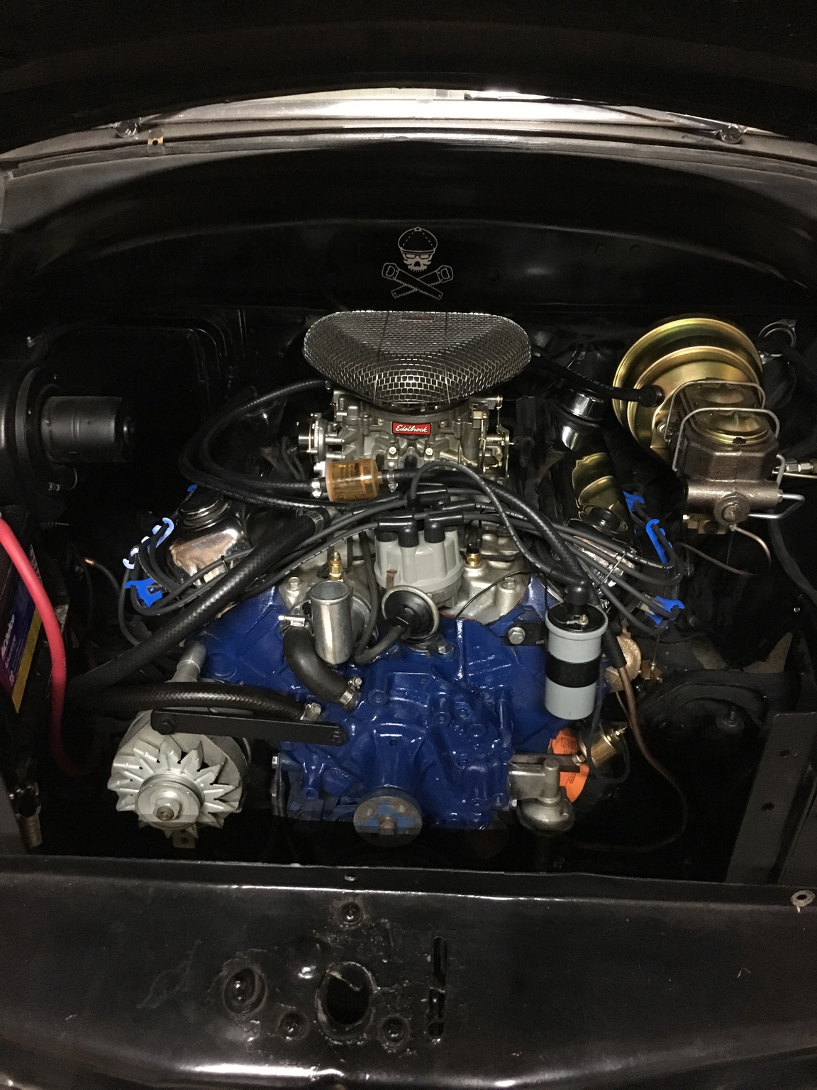

    Adding some info. It's a 53 that uses to have the V8. If I put the new radiator in, I have 1.5" from the very tip of the water pump.
    This is a bit of a story. Sorry in advance for the rant. Hope you guys can offer some insight.
    So, I destroyed my old radiator. I attempted to solder up a leak and I overheated it, making some solder puke out. No big deal, I ordered a new one. It is identical in size and mounting points.
    I also picked up an electric fan and shroud.
    I wanted to run an electric fan because I don't like the 4 blade non-clutch fan on my 351W. I thought a shroud and fan would cool way better.
    The problem is that I didn't measure first... there is no room for the rad/shroud/fan. I modified the shroud to fit and can't return it. The radiator is about 2.25" thick. My shroud is 1" and the fan is 3.5" deep.
    At this point, these are my options.
    1. Run the fan as a push fan. If I did this, should I still use the shroud to funnel air at the motor? I wouldn't have to cut anything, and could use what I already have.
    2. Go through the expensive task of getting a shorty pump and pulley. I would still have to move the radiator towards the front of the car AND buy a thinner fan even after spending $ to shorten by 1.5 inches.
    3. Just install the radiator and the original fan
    4. Run the original fan with the electric as a push, no shroud.
    Here's what I fabbed up even though it does not fit. :/

    If you're set on using the electric fan set up then this is probably useless, but if you're open for other alternatives this may help. I had to change my plans.... I am not sure how much difference there is in room between a 53 and a 54, but on my 54 I was able to get my radiator mounted in the front position with a water pump from an early 67-69 small block (not the short water pump) and used a 16 inch mechanical fan, with a 1" spacer, to put it one inch from the radiator with no shroud. I originally had mounted my radiator away from the engine in the back position with ideas of using the electric fan, but when I went to add the AC condenser I had to regroup and move the radiator back forward and get rid of the electric fan.. NO chance of fitting an electric fan on mine no matter what with AC. I had even purchased the Champion 16 inch slimline fan first, but just no space. ( I have the fan for sale :)) Currently in Florida's 90 plus heat the engine temp hasn't gone over 200 with AC on and no shroud.. (I used a Champion 3 row radiator.) I used simple L brackets to the core support and the radiator side brackets to move it around. Probably moved it 4 times before I got it to clear everything, but AC condensor was my issue. Without AC it should be fairly easy. I attached a pic to show the distance from the block flange to the outer water pump pulley using the 67 water pump in case that can help you or someone else figure your spacing. 68 small block water pump.jpg Radiator mounted in the forward position.jpg Condensor and radiator pic 2.jpg

    Finally got done. I'll share what I did, maybe it can help somebody out. I got a Spal 14" thin fan.
    I fabbed this up with a summit shroud and some 2" angled aluminum.
    I used my template to see where I'd need to cut. I cut a few inches off, about 1/4" behind the support that goes to the top. This allowed me to drop the radiator down and also move it forward.
    I used this time to clean up the block.
    Here's what I'm left with after the install. I used 4" bolts and 2 5/8" 7/16 ID spacers it mount them to the original holes (stretched out a bit)
    [​IMG][​IMG]
    Please excuse the length of my upper heater hose. The system is very happy and runs no hotter than 185 in bumper to bumper traffic.
