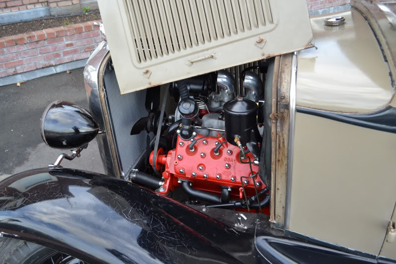

  9. What located the motor where it's at now?, the K member and trans?. To me it looks like the motor needs to go back and the firewall re worked in the lower area.
    Automotive Stud likes this.
  10. v-v
    Joined: Jul 24, 2007
    Posts: 94
    v-v
    from Finland
    Firewall mostly. Didn't want to cut it too much.

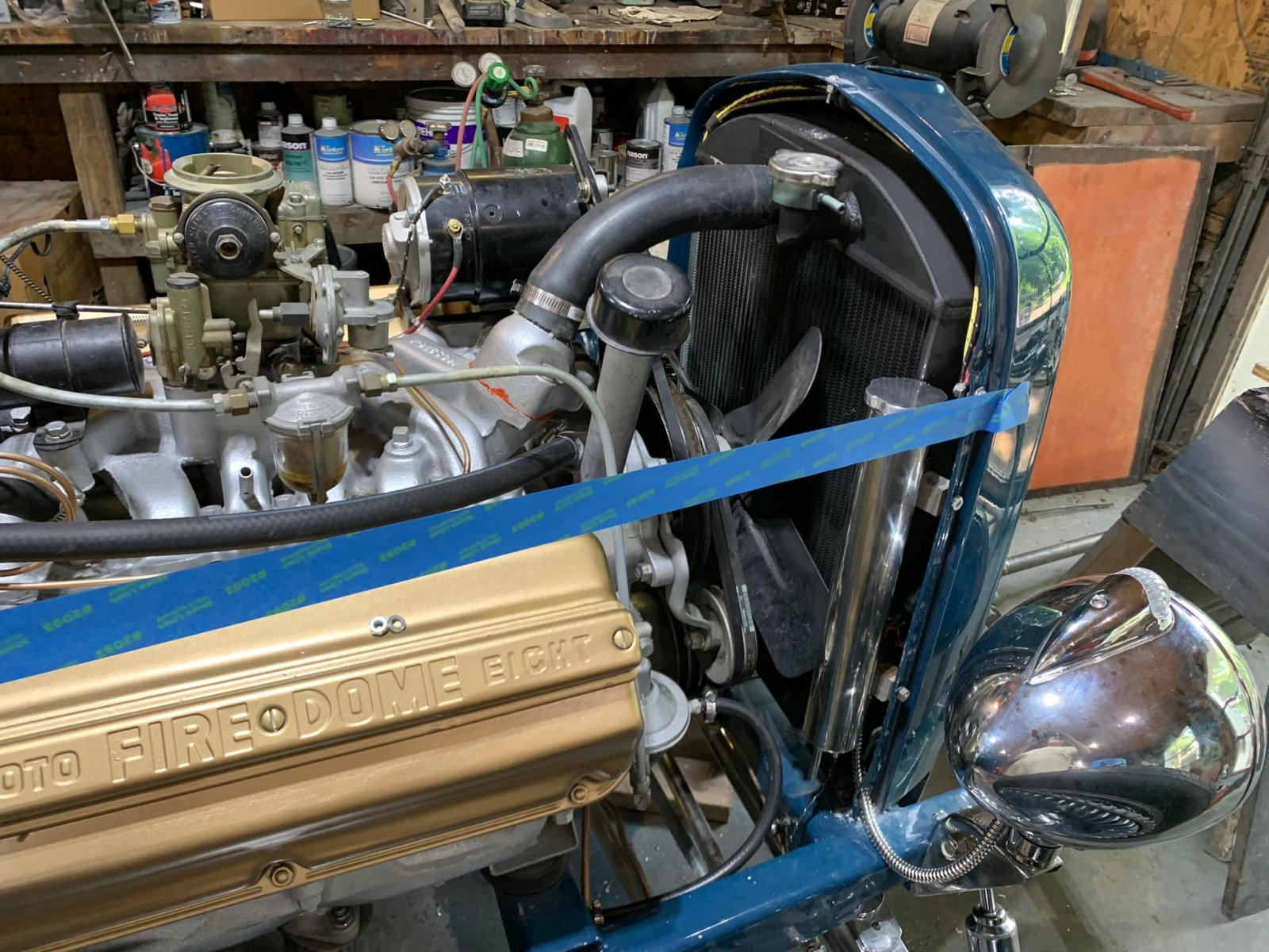

    Apples to oranges, but a DeSoto Hemi slides in a '29 on '32 rails with plenty of room for stock fan and pulley's. I'm gonna make a hood top from aluminum, to fit the (longer by about 3" wheelbase) and be happy. A0E92606-6FA1-4EFD-8904-78331A7088BF.jpeg
    GordonC likes this.
  12. There's a few AV8s on here, one I do remember was for sale in the cl***ifieds. It was a '30 Tudor with a 8BA and he did cut just under the rib to get it in there (if I remember properly), or you can just flip the firewall.
    Something like this:
    caprockfabshop and Budget36 like this.

    It will be a tight fit at best. You have to "steal from Peter to pay Paul". In my channeled coupe, I used the stock A frame and modified the firewall, moving the engine back enough to fit everything. It was easy for me since I had to have a driveshaft made anyhow. It snowballed into new engine and trans mounts, pedal relocation, steering reconfiguration, new seat moved back, removed a few inches from the package tray. It all worked out in the end but that's what needed to be done to run full fendered with a stock hood, fit everything and be comfortable. I am using a 6 blade mechanical truck fan. I'm only 5'10" tall and the car is very spacious.
    caprockfabshop likes this.

    With the extra length of the 8ba you're going to need to recess the firewall. A 59AB is SUPER tight fit and is shorter than the 8ba.

    Can you get a shallower fan, maybe even a plastic one and possibly trim to suit ?
    I have a similar problem but have run without a fan for the last 5 years, although I will get it fixed one day and possibly do have more room in a ‘32 with 8ba.

    The only other option to gain any space would be to remove the 8ba distributor and install an earlier design. Of course that’ll require a cam change.
    I’d break down and reconfigure your firewall instead.

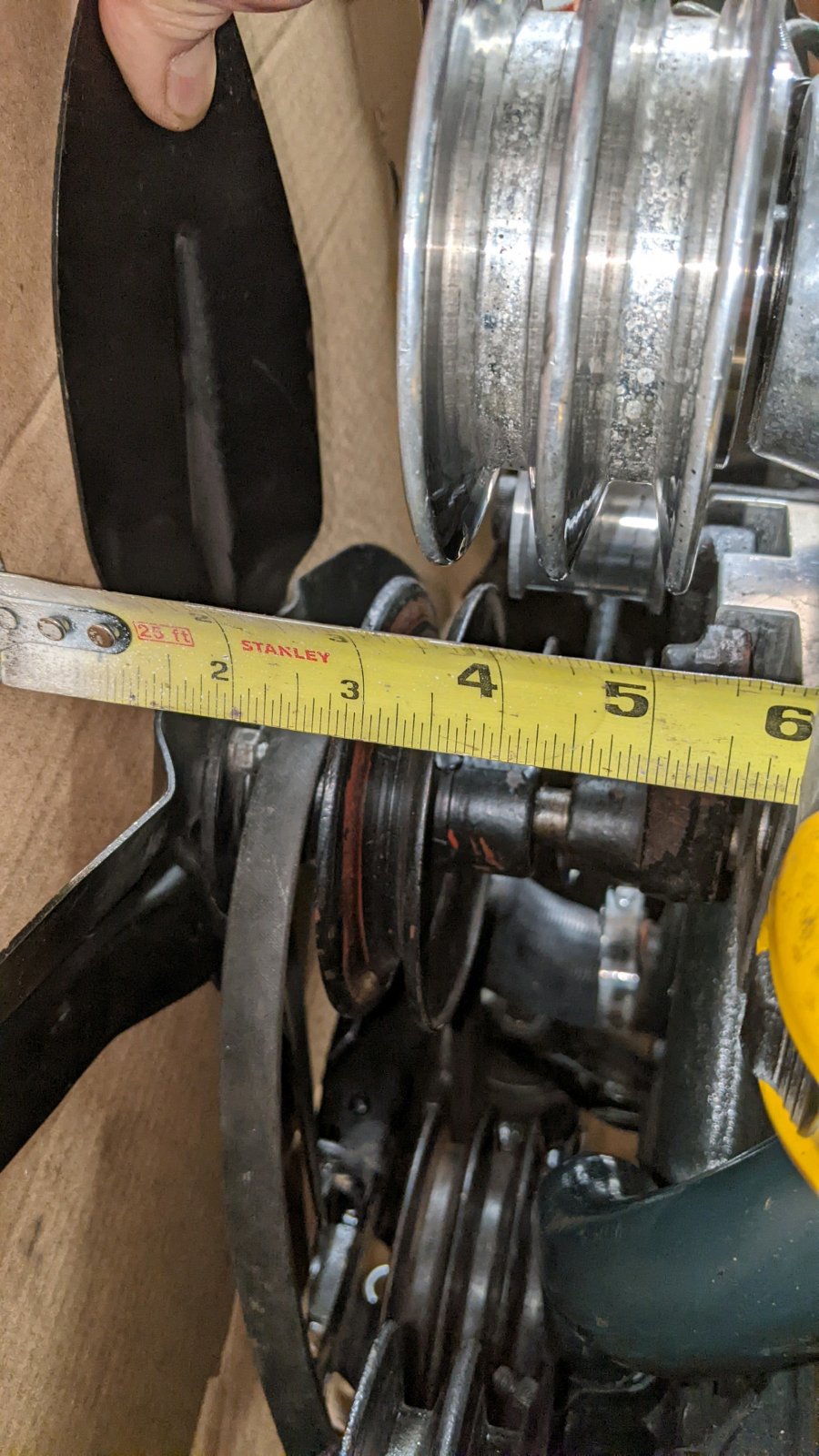

    PXL_20220912_120344271.jpg At first I thought the measuring tape was inches, he's got plenty of room. After looking again, I realized it's centimeters. At that picture angle it looks like 15 centimeters which is just under 6 inches. My '32 with an 8ba in the above picture, only has that amount and I made it work..
    I removed the original larger fan and bolted on a 4 blade 17inch diameter fan, it just clears the radiator by 1/4 inch.
    v-v likes this.

    Looking at your first picture that is a custom crank pulley with four sheaves . You have a lot of options to push the fan, even if it means fabricating a fan mount.

    Looking at the pictures, your motor is up approx. 2" with those spacers, I'm ***uming that is needed. In a game of inches, in may benefit you if you can drop the motor a bit to give your clearance of the hoses and upper tank.
    I'm trying to find a thread that V8coopman on Fordbarn made about using a 59AB fan for a tight clearance like you have. Either way, it looks like you will need to cut down the blades in order for everything to fit in there.
    Here is his post:
    https://www.fordbarn.com/forum/showthread.php?t=278828

    It's not too clear in the picture. Am I correct in saying it's a four sheave crank pulley?

    I would be concerned about the 1/4" space to the radiator. The radiator fans when they are running could flex forward and move into the radiator. I ran to clearance issues like this on a pickup I was building and found out the hard way. A new radiator core and a cut down fan spacer which provided a lot more room resolved the issue.
