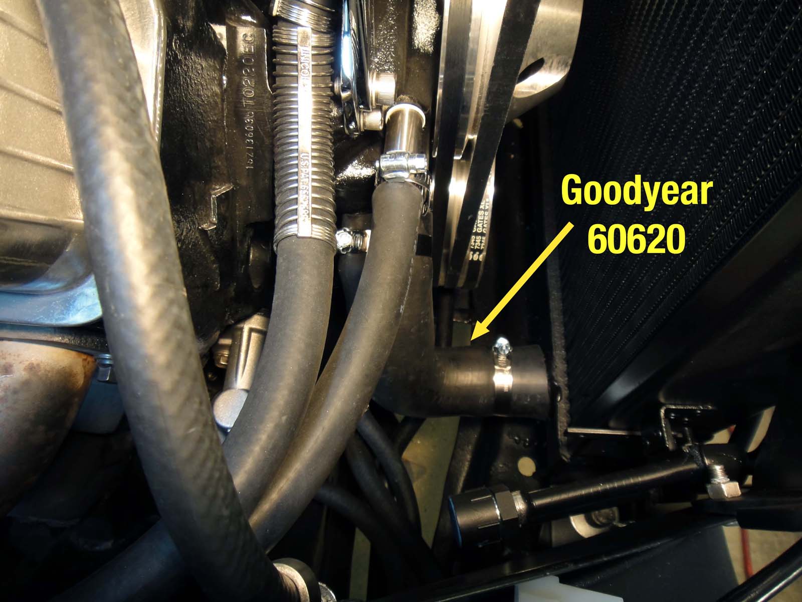

  16. bob35
    Joined: Aug 26, 2011
    Posts: 75
    bob35
    from DFW, TX
    I used Goodyear P/N 60620... which I think is a similar fit to 55-57 chevy lower hose... in my '35 Ford with SBC. Not quite the same... but maybe similar fit problems. I had to trim off both ends, and it was still really tight, and was bent a little more than the molded bend. So I got one of those inner hose springs out of a different lower hose, cut it to length and stuck it inside. It was a real pain to get on, but worked perfect, and I don't have to worry about it kinking and restricting flow. I've attached a pic, in case it helps.
