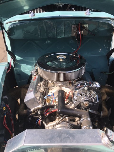

  9. The Aluminum pipe piece came from the metal supply house, schedule 80. Yes, the alt is way over there, the po installed it using those brackets....the fan pulley comes of to change the belt.

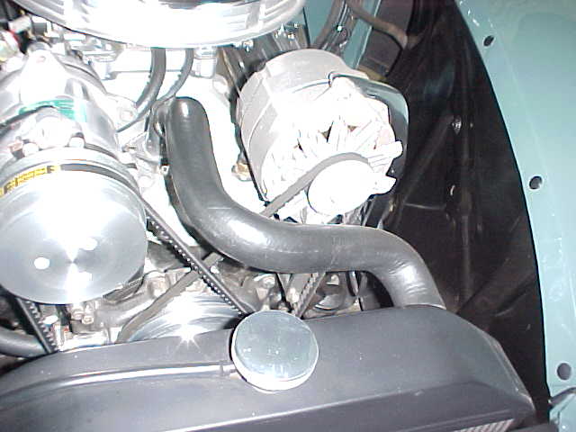

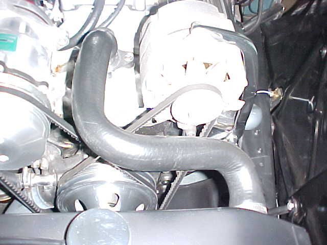

    On 40's with a small block and a walker I use 7885 from Napa for the top hose-have done a dozen this way-can send a picture if needed
