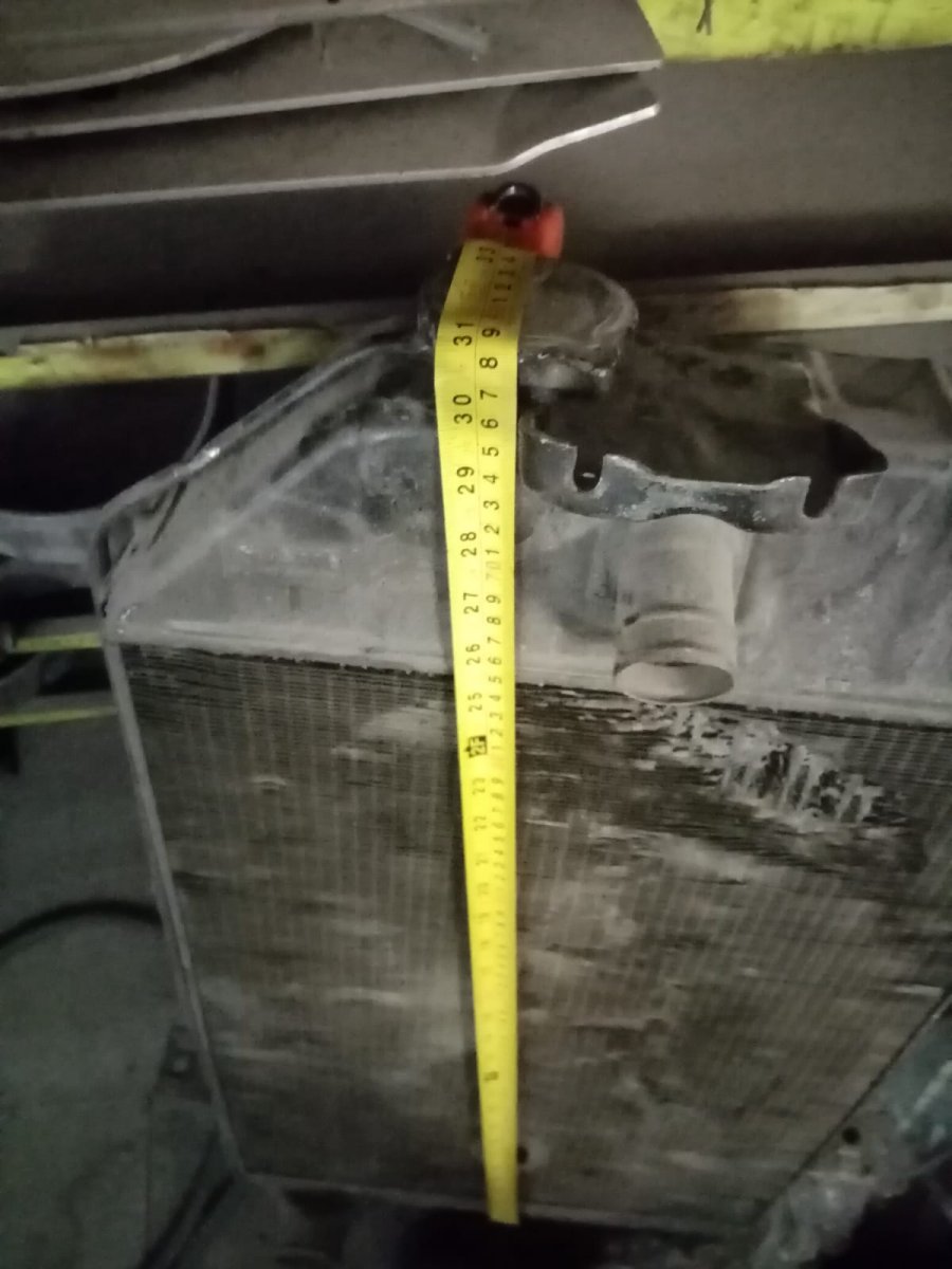

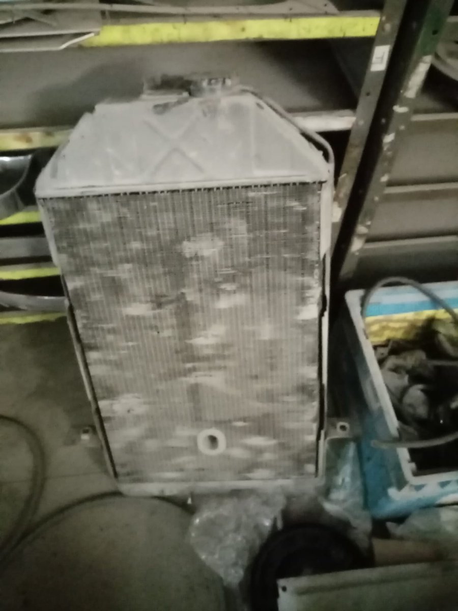

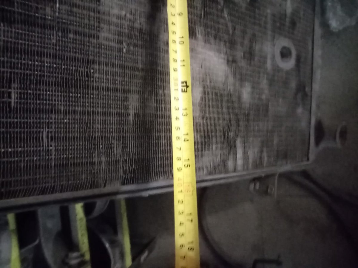

    Have been looking for a 37 - 39 ford radiator for a while now in the U.K. just for mocking up my project , and today I was offered one that the guy said came with his 37 coupe . Could any help me possibly id it please to make sure it definitely is a 37 .

    '37 Ford would have two water inlets/outlets and no crank hole. Tanks don't look right.

    Bottom is also wrong for a ‘37. Pretty certain the tank doesn’t go below the mounting tabs.

    Weird. The top bracket for the rods that go to the firewall, look correct. Even the mounting tabs "appear" to be in the right spot. But, obviously there are not enough water outlets for a flathead. And, every one I've seen has the crank going under the radiator, not through it. Maybe it's for a Prefect, Anglia, or something.

    Me thinks it fits a '41Ford 4 cylinder pickup truck.

    37 Ford car?
    No.
