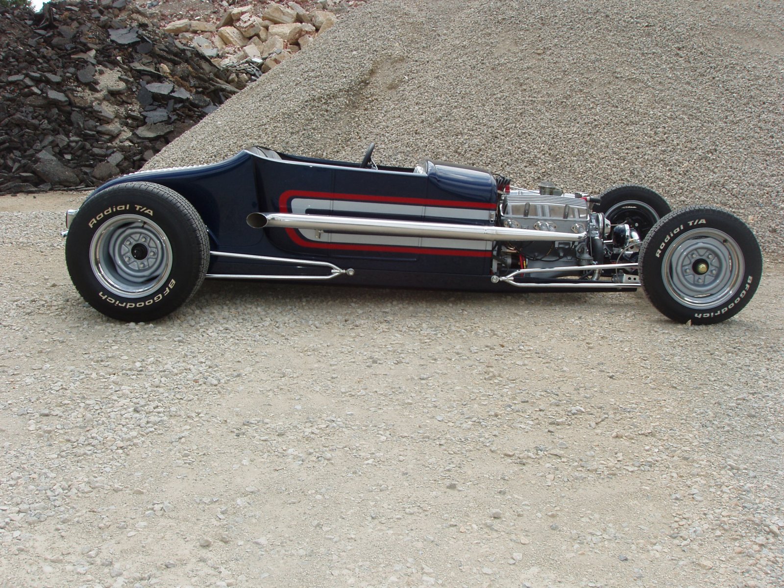

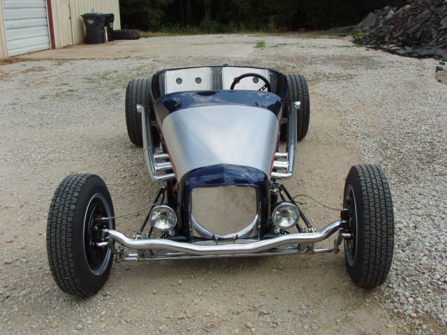

    454 radiator. 2 fans. S/S tubes inside the frame rails. Runs cool. All cooling tube conn 2014-07-14 09.41.20.jpg 2014-07-14 09.41.22-1.jpg 2014-07-14 09.41.22-2.jpg 2014-07-17 15.32.22-1.jpg 2014-07-21 10.20.18.jpg 2014-07-21 10.20.22.jpg 2014-07-21 10.20.26.jpg 2014-10-09 17.17.58.jpg ections double clamped and re tightened after 1st trip. 350/350. LOW marine intake. Sectioned oil pan. Custom rails with 1 " radius on the bottom. Dropped floor. 201 Halibrand.

    Do the fans push or pull?

    We're you able to put a bubble flare on the cooling tubes, I've seen a few different ways to do it.
    Cooling tubes thru the frame rails is a new one to me, usually see them run on inside of frame to help shed heat as you're driving.
    Also interested if the fans push or pull, if pulling, does it vent out behind the radiator box

    I'm doing the same on my '29 roadster, but I'll be using an electric water pump (no way to run a mechanical with the Potvin blower). Are you running a thermostat? I can't tell what that chrome thing is where the thermostat would be located and you're obviously pulling the coolant out the side of the intake/heads. I imagine it holds a few quarts more coolant and the lines going back and forth probably help in keeping things cool. I'd like to see the decklid as that's one of the things I'm hesitant on (louvering the decklid) and it looks like you've done just that. Did you do anything under the radiator to promote air flow or are you just relying on the fans?

    I wonder in long-term use it would be hard on the water pump? Or if there would be any issues pumping coolant that long of a distance.
