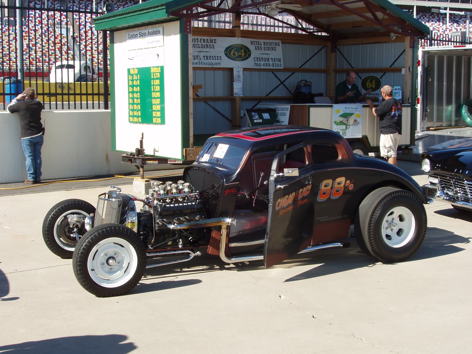

    Up front flow is important to me. I see too many hot rods with grille shells higher than the cowl. When building the black 27 I was a little bit worried about cooling but it has not been a problem. I think the small upper hoses help. Limited room I used a 17" electric fan and a good schroud. track roadster 6-14-16 001.JPG track roadster 6-14-16 005.JPG GOODSGUYS   PACKARD 018.JPG

    Joined 2012. Was not aware this site is for hard core traditionalist. My first thread. 33 Willys. The HAMB guys had a field day ridiculing it. Won Detroit Speed " Builders Choice " at the Goodguys S E Nationals. Also won " Best Drag Car at Doug Herbert car show and " Peoples Choice " at Mooresville Drag Strip car show. 2012-05-14 11.07.16-7.jpg img189.jpg

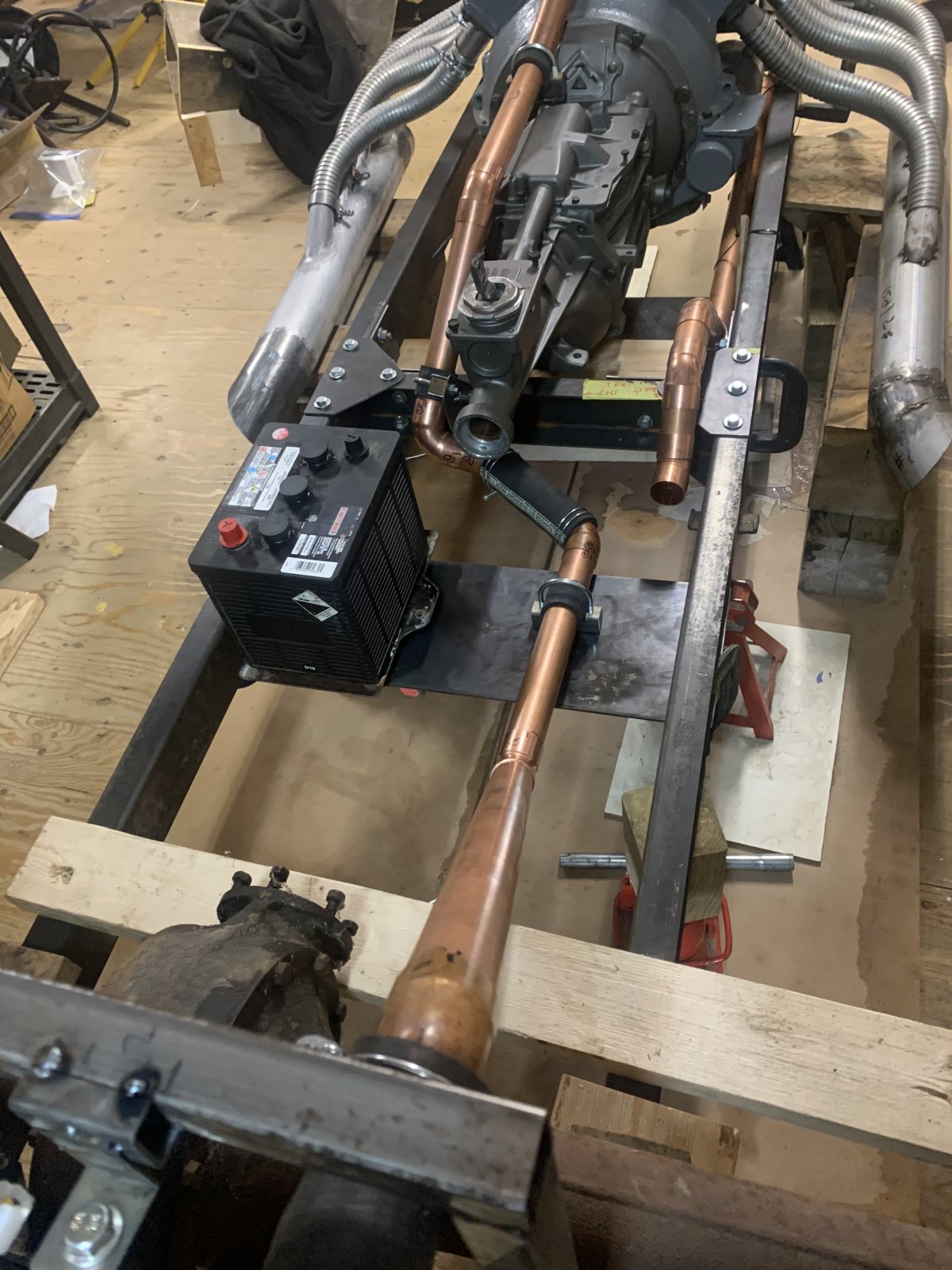

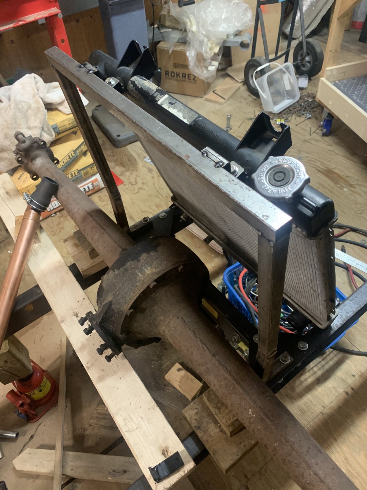

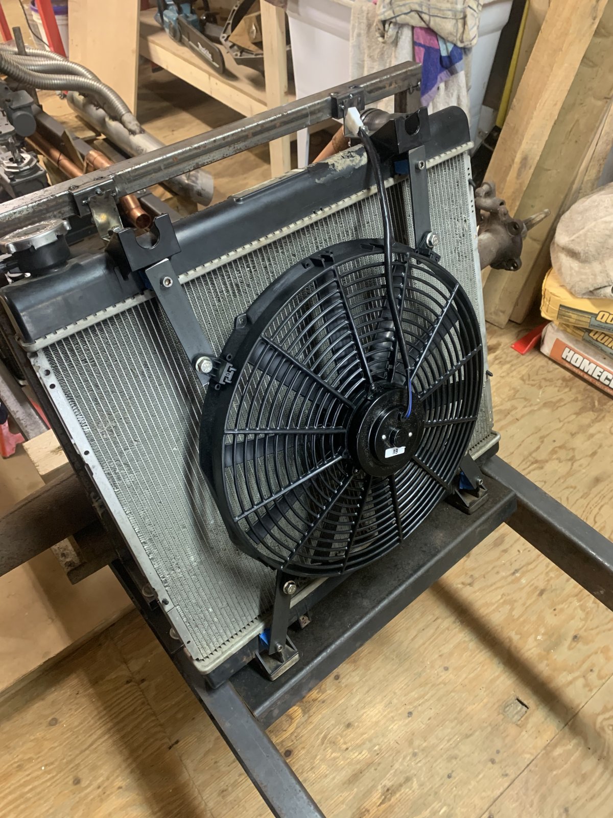

    Not sure how I missed this thread when doing searches for rear mounted rad setups. Hoping mine will work…Lol!

    Ziggster, That fan setup isn't going to work for beans. You need a proper shroud that covers the entire radiator and forces the air to be drawn across the core and through the fan. With the fan standing off the core as far as you have it, it will just recirculate air behind the rad and be very in-efficient.

    Agree. Just in mock-up stage. Picked up the 3’x3’ alum 18 ga sheet on Monday for the shroud. Fan will be a puller. Thermostats on the flathead are set for 170F and have a temp switch for the fan set at 210F on and 195F off. Rad is from a Dodge Dakota pickup. Same rad was used for the V6 and V8 IIRC. Way more capacity than required for the 100 hp flattie.

    2 aluminum 1” thick cookie sheets from a kitchen supply spliced together with a hole cut for the for works wonders as a shroud.
