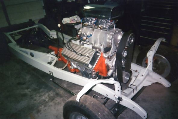

    Here is my 34 frame which has the stock radiator mounting points in front of the spring mount...The mounts to the rear of the spring is where the stock flathead was mounted Build picture 1.jpg

    Yeah, those holes are about where the radiator mounted on previous generations of Fords.

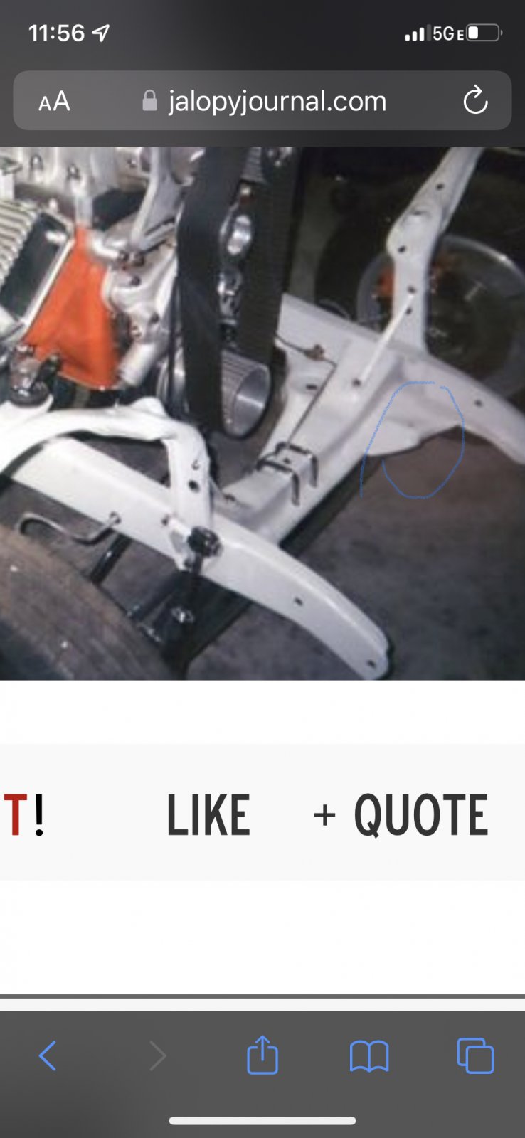

    So what are the holes on top of the spring channel for?

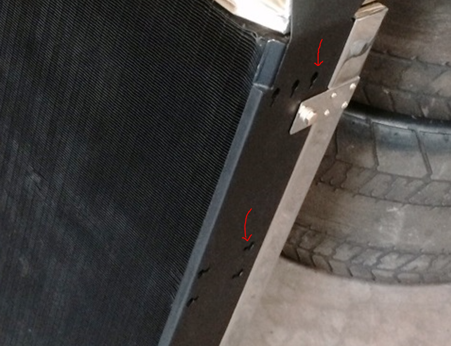

    CCA6EFAD-79A0-49E9-9931-D4F01B3F427D.jpeg This is the radiator mounting holes right?
  12. rusty valley
    Joined: Oct 25, 2014
    Posts: 4,380
    rusty valley
    The top holes mount the fender support brackets that go thru the inner fenders. Yes, you circled the radiator holes

    The big holes are for motor mounts .

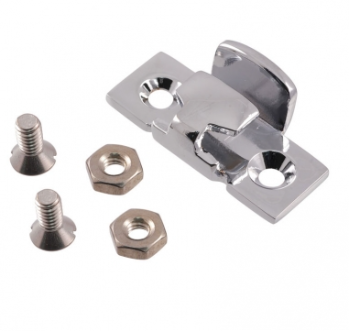

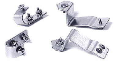

    The grille mounts to the radiator using 4 brackets, 2 per side. My 34 used these, the 33 is similar.
    The screw heads slip into the slots that hopefully your radiator came with like these on my radiator
    The hood attaches to the cowl using this bracket which I believe is the same 32-36, then you hood hinge bar slides over the bracket on the cowl and

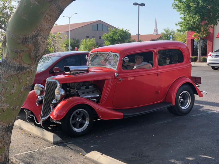

    These are the holes you mentioned? Also note location of radiator, that’s correct?

  23. rusty valley
    Posts: 4,380
    rusty valley
    Well, NICE model 40 you have there for sure, but think of the money you save by not trying to find 4 good fenders,...that would buy a lot of beer
