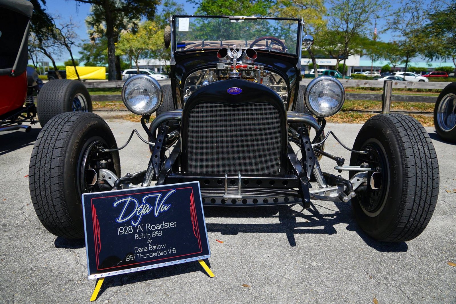

    I'm not using a 32 shell,but this may help;;
    First time for me back in late 1958,I needed a radiator for my 28 Model A hotrod,powered by Thunderbird Y-block, I was building over about 3 years{ did get it finally running by 1959 an then drove to high school} still have it !.
    I had a local radiator shop do it way back ;@ South Miami Radiator. The guy there did a great job Br***/copper fitting up a custom fit too my 3in. chopped "A" shell. He used two cores back to back too fit ,some type of small car cores, with the modified stock "A" top tank for out lets a 16lbs PSI.
    It lasted near 40 years{ with the same guy doing a repare a few times].
    The new replacement I got over 10 years ago.
    I'm using now is alum Champion*,not custom order, but they list the size height n wide,just one they make in there catalog for "T-buckets/w/V8 Ford out lets"* was close enough. At the time those were on sale with shipping @ $ 150 at the time.. I did need to bend ,trim n cut the a little the alum mount tabs, so I could bolt the 28 shell.
    It's been working well,only prob I've had was my own fail to put make a new fan shroud right a way { old an lazy me},so got hot in stop n go traffic.
    Did make a shroud,frankly it took me too long,**** not a teen anymore ether.
    So point is you don't have too have a high $$$$ perfect fit;;=T-bucket Rad size for T-shell ,I though would be too small? But after looking a sizes given in catalog. Happen to be right hight for my 3in. chopped 28"A" shell,but only 1in. less then ideal wide!= That is only 1/2in. each side anyway for the "A" shell, my stone SS guard covers covers the small air gap that could barely be seen at all, if light was just right/an after adding the new shroud,looks great I think. So hunting size vs for 32 shell,may save some $ an cool well too ! Some pics below before I added new fan shroud.
