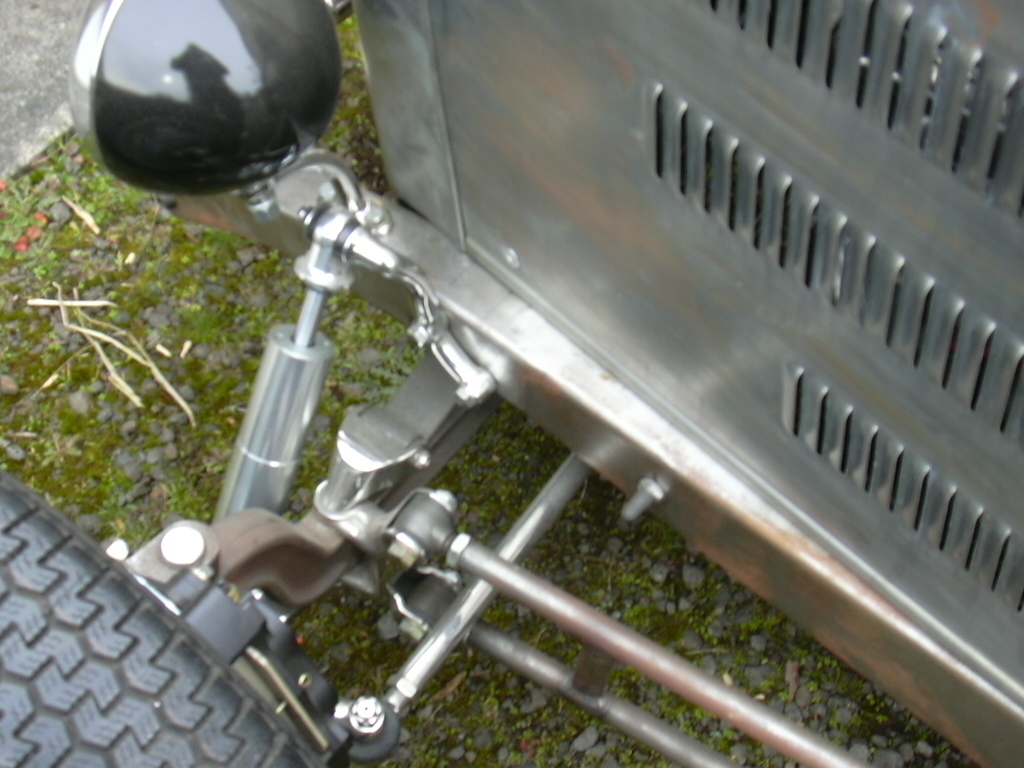

    The mounting surface is dropped down. The tab sticks out. I show a stock front crossmember. The pic of the mounted parts has a custom crossmember built to stock dimensions. The shell and radiator are stock. I think the fender fits under the shell. I remember twisting the radiator to get it in place. It did not drop straight down. I don't have anything with frnders on now to check.
    As a suggestion: I would use extreamly light springs to mount the radiator. The repo springs will tear the radiator apart if you are not running fenders. The fenders add a lot of torsional stiffness to the frame. That is why the are always cracked and always in the same place. The trianglation of the radiator rods hold the top inline with the cowl. If the frame twists, the radiator must lift on one side.
