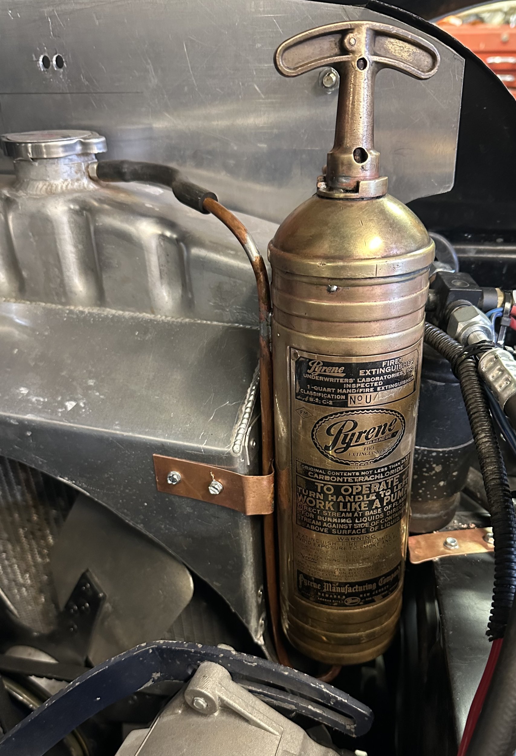

    I bought this old brass fire extinguisher at a swap meet and want to make a radiator overflow bottle out of it. Has anyone used this type of extinguisher to do this? If so how did you get it apart to remove the pump inside. I plan to run the lines through the fill plug. If you made one please post it up and give me some pointers on what you did. Thanks Brian. Fire Extinguisher.jpeg

    Here’s what I did . Left the pump inside , sealed the top , and the bottom …. As you can see ran lines outside . Maybe there’s a better idea , but this works …. IMG_0405.jpeg

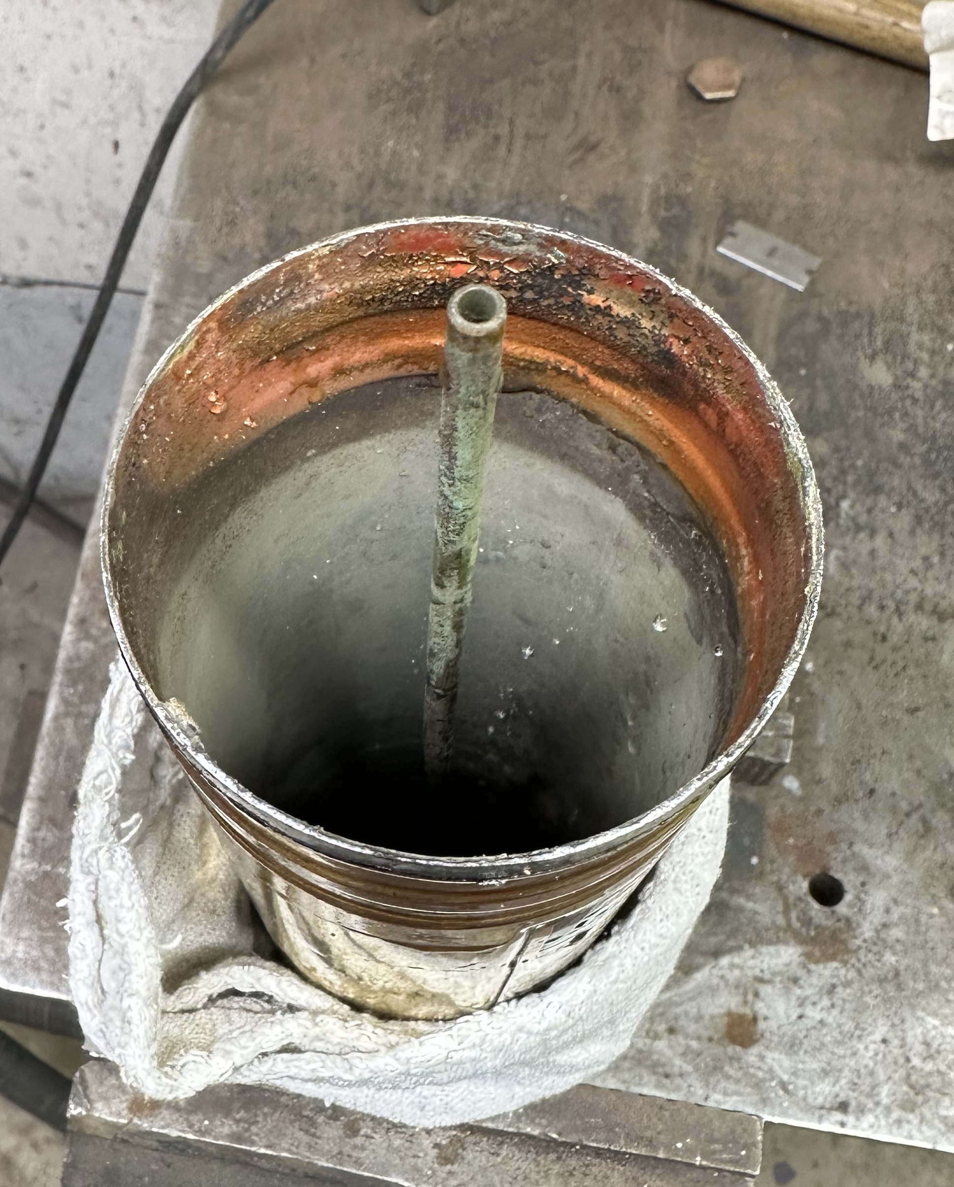

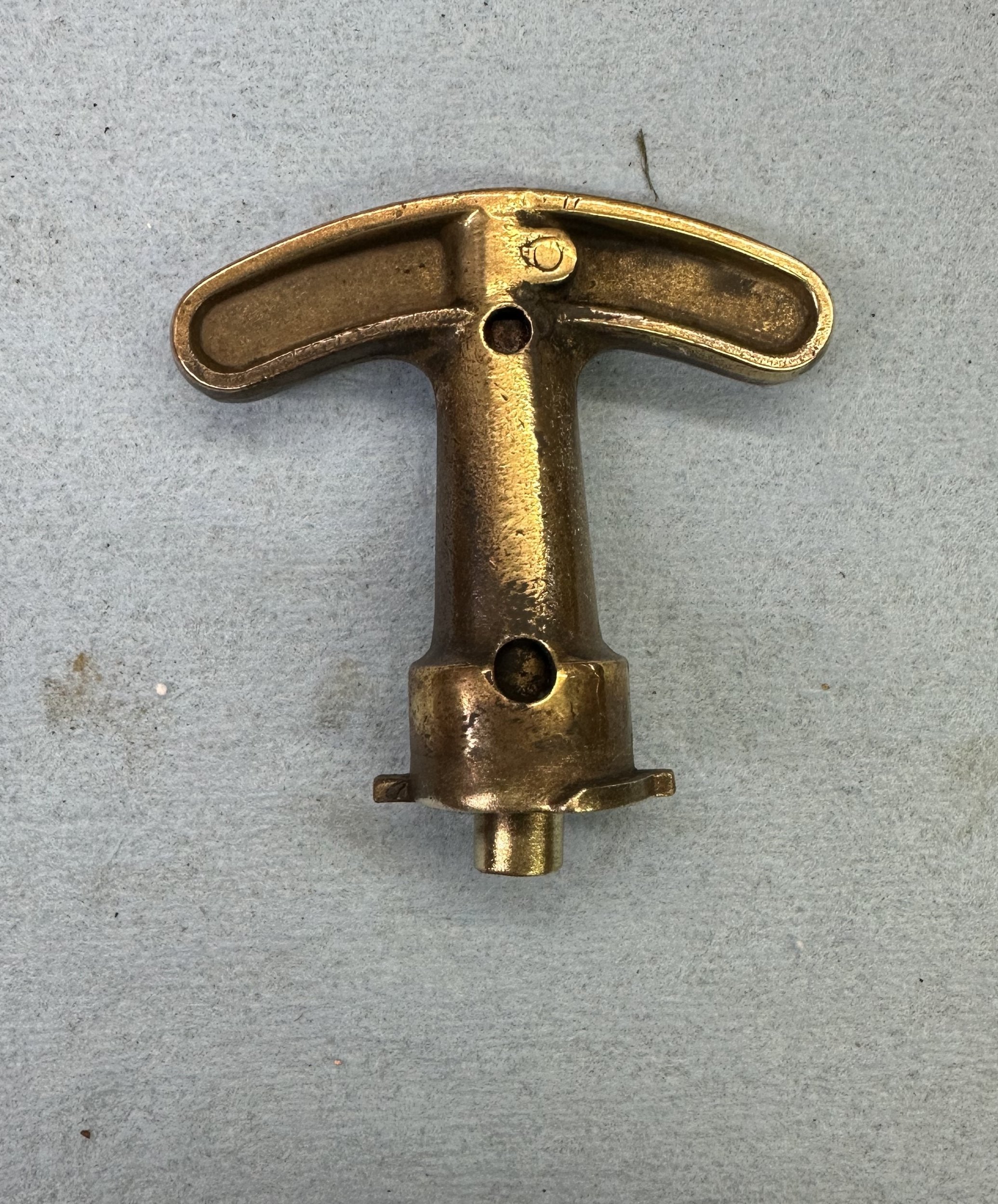

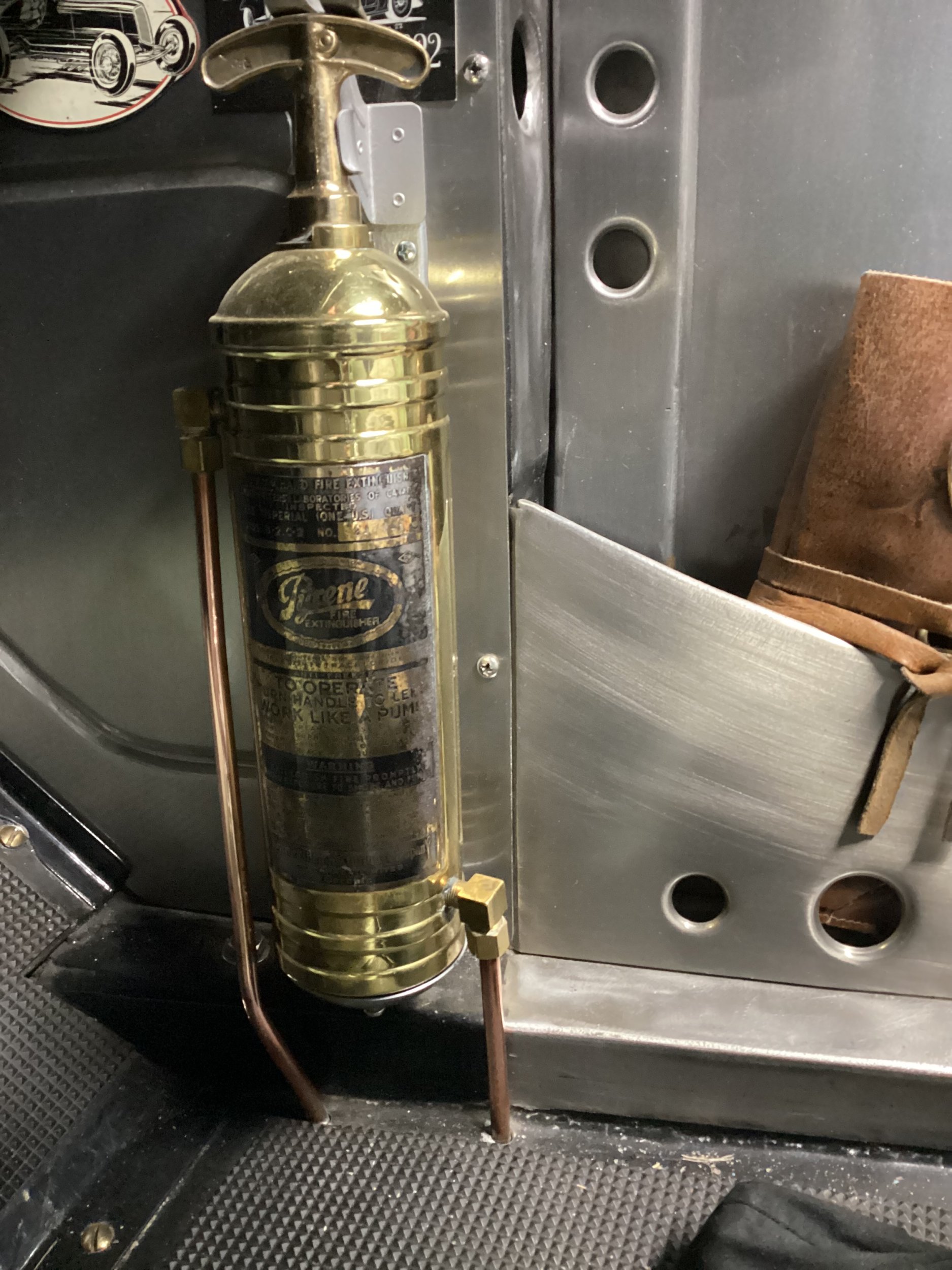

    Yup.....I did one. Unsoldered the top, gutted it to the point that I could keep that "T" handle on it, and re-soldered the top back on. Drilled a small breather hole in the fill plug, and drilled & tapped the discharge nozzle for an 1/8" pipe fitting with a 5/16" barbed hose fitting on it. Mounted it with the barbed fitting facing down. That way, it filled from the bottom, and drew out the bottom, just like a modern recovery tank.
