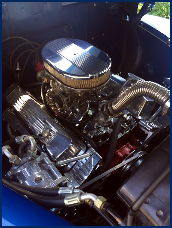

    I purchased a Overflow tube for my 46 Tudor and the way the radiator & AC condenser is set up there isn't any room next to the radiator but while attending a cruise night one of the guys had his on his firewall. My question is...Should the overflow tube be placed as high as the top of the radiator or should it be lower than the radiator top?
