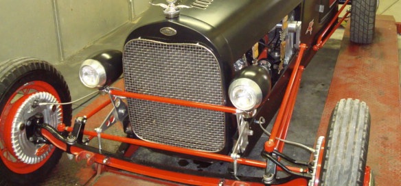

    This is polished stainless shaker screen. Never have had any issues with overheating. fullsizeoutput_4e.jpeg
