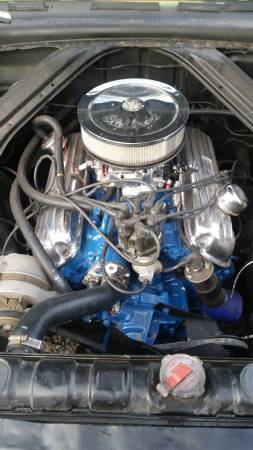

    This is a 1963 V8 Comet:
    This one has no fan shroud. Since it does not, you can see the fan blades well behind the top tank of the radiator.
    Even the thickest (3-row) radiator is not thicker than that top tank, so there is plenty of room for a mechanical fan.
    There is room for one with an inline-6, too, even with a 3-row radiator. If you have an inline-6, they do fine with the 2-row radiator.
    The only way that you would have the fan too close to the radiator is if there is a spacer between the water pump and the fan that is too long, or you have a water pump and accessory drive from a much later model Ford, that is inappropriate for this ch***is.
    Ford made close to 25 different accessory drive setups for the small-block Ford engine over the years, before they even went to the serpentine-belt stuff. Only a few of them will properly fit this car.
