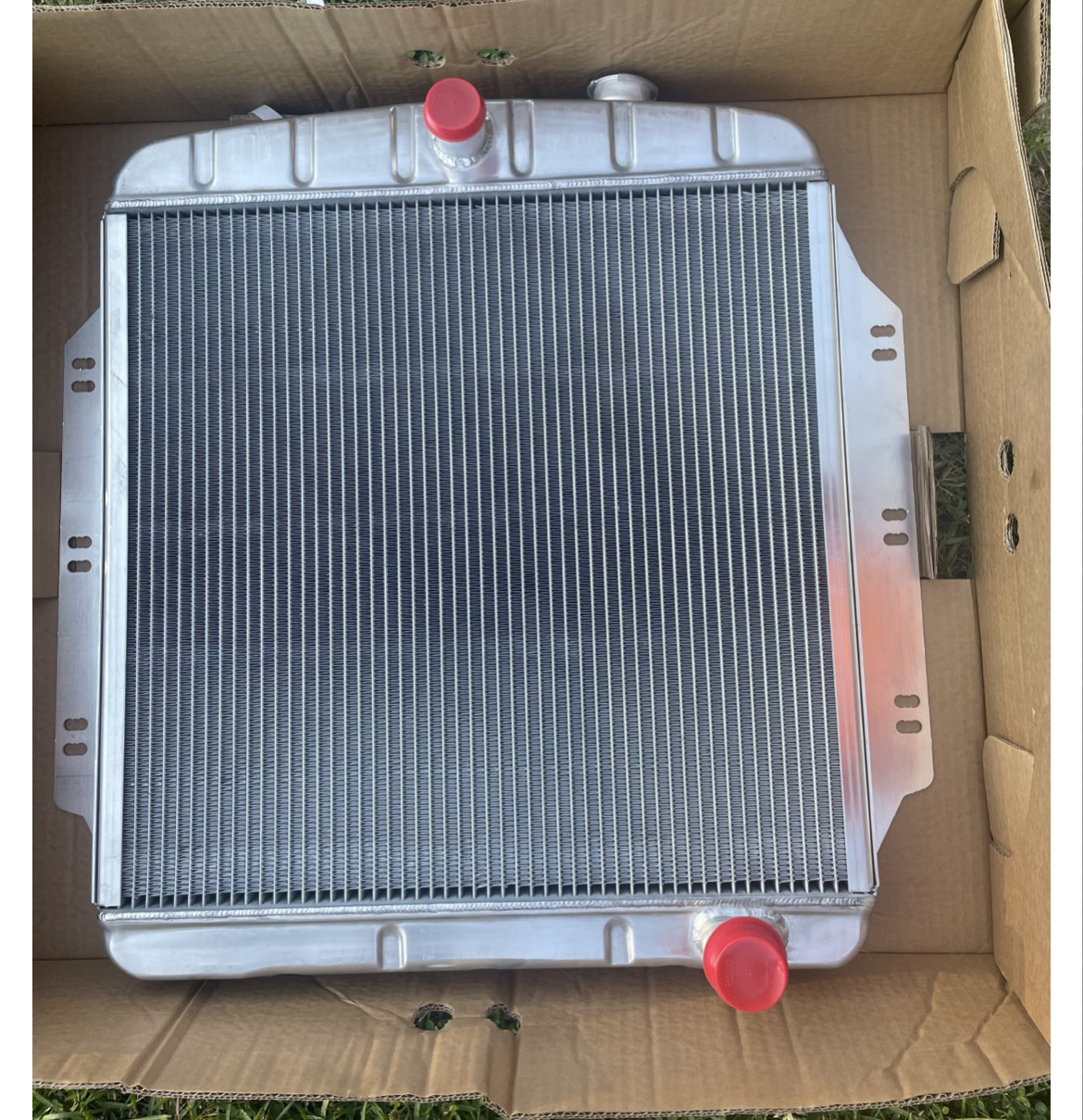

  14. Here’s one of the stamped aluminum radiators I’ve used from Brice Thomas
