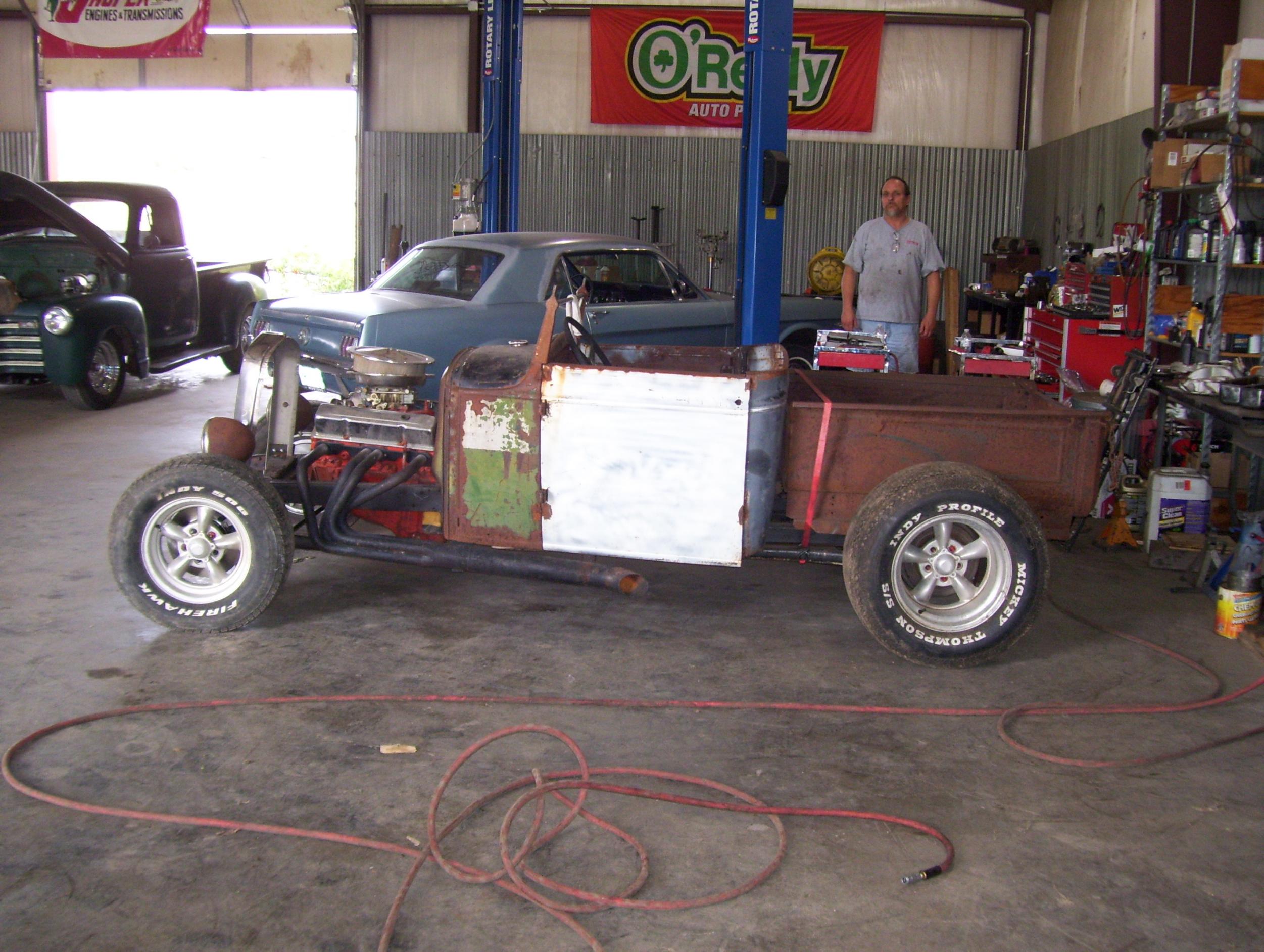

    i have searched till i have gone cross eyed!! and i haven't found anything to answer my specific question.
    Q: how much HP/CID are you cooling with your 65-67 mustang Radiator??
    i have 31 A pickup no hood, i will have a 9.8:1 C/R 350cid chevy, double hump heads, aluminum intake, mild hyd.flat tappet cam, 750 holley, headers, th350. MILD engine to my standards
    your thoughts and FIRST HAND expieriences would be apprieciated.

    1. the reason im askin is im really limited on space the guy whos started my project Z'd the frame at the firewall(creates a lot of problems).
    the mustang rad. is the lagest that will fit with out my shell being stupid tall(above the cowl by alot).
    2. i dont see how anybodys rad in a given space will do exceptionaly better than the other!?!?
    if it comes to it i will, but i dont want to spend mega bucks on a rad for this truck

    as far as it looking bad, this thing has ugly covered LOL. ive seen them in these shells, i agree they dont look the best but im ok with it.
