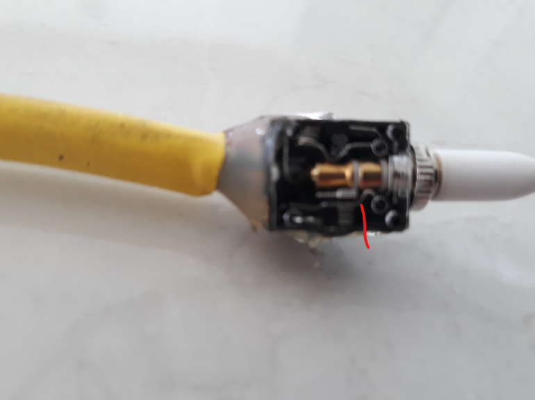

    If you have a working AM Radio, [and not scared of a bit of wiring] You can connect a 3.5mm phone-jack between the Tuner and the Pot [Volume control]
    Here is a basic schematic
    With the 3.5 aux input unplugged the Ring shunt and the Ring are connected together [so the Tuner is connected to the Volume.
    When you plug in a 3.5 aux input the Ring shunt and the Ring are disconnected and the Ring [and Tip] get the signal from the Aux input
    2 x resistors are needed for the stereo Aux input to convert to mono.
    With this the FM signal from a phone or whatever will still have that old timer "mono" sound
    Here is a Phone Jack [they are small] All you need is a 3/8" hole in the dash or glove box for it
    Here is the same Phone Jack with a Aux input plugged in [You can clearly see the Ring Shunt and Ring disconnected]
    This is the same Phone Jack soldered to some "shielded cable" ready to fit to a Radio [We made these in pairs, and saved this]
    A Phone Jack costs about $2-50
    @lostn51 AND @Andrew Samson
    If you are electrically challenged and have a working Radio that you are reluctant to open up, then consider the Redirad solution
    https://redirad.com/
    It is a simple box connected inline with your aerial, and you use a 3.5 Aux input cable to your phone. [You select 1 channel on your radio for the Aux input, then plug in your phone]
