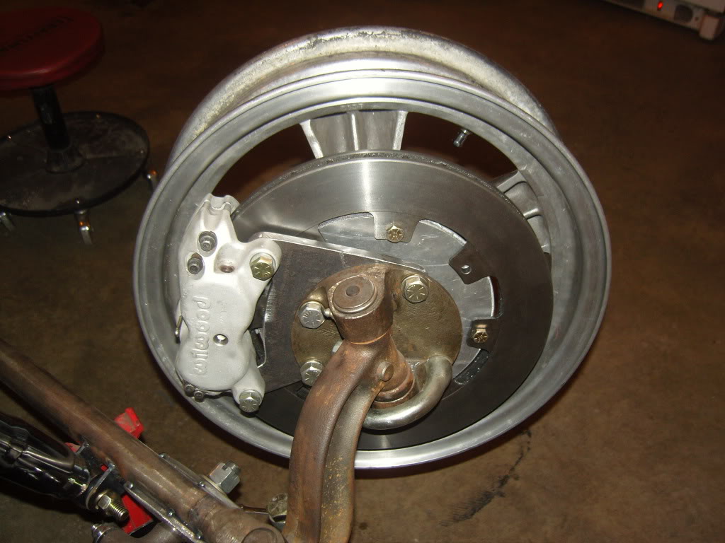

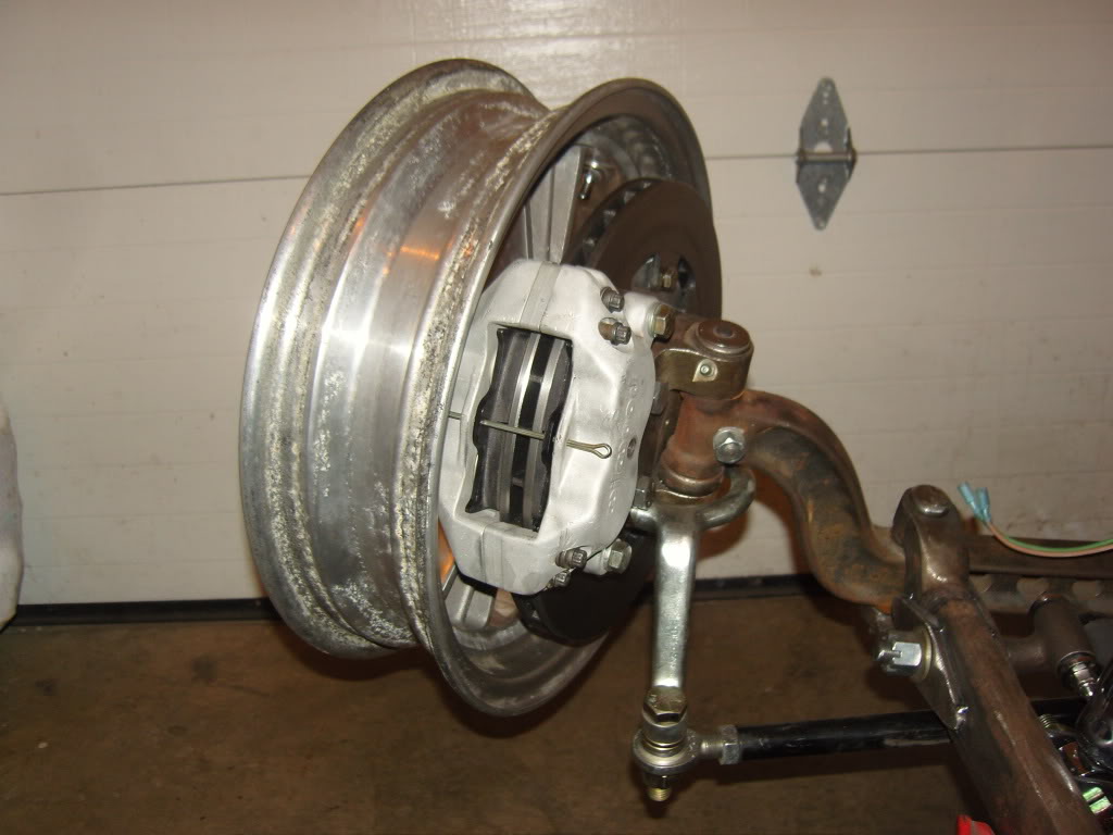

    I'm not running the radir's but here's my take on brakes. I wasn't real big on what's offered for spindle mounts. I built my own set up with wilwood calipers and rotors. The only part I needed machined was the hat setup.
    I haven't used these yet but I'm sure they're overkill for my truck.

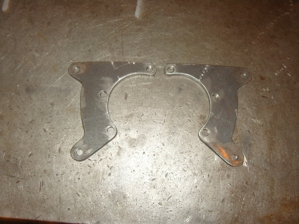

  18. Mat Thrasher
    Joined: Nov 5, 2007
    Posts: 1,168
    Mat Thrasher
    The hat is just a 1/4" plate. I had them cut into 8 x 8 squares. I did a rough center and drilled the holes to mount them to the rotors and then cut them into a rough circle. A buddy of mine found center off the outside of the rotor and bored the ID on his bridgeport. Lastly he put the hats on a lathe and cleaned up my rough cut OD.
    The calipers are used willwood dynalites that I found at the swap meet in Canton. I bought new rotors in Canton also. I believe this stuff is pretty standard circle track stuff. I bought new O-rings and pads at summit. I used 3/8 plate to make the calipers brackets. I got real lucky and the offset worked at perfect.

  19. Ok more specific question, how is the spindle mount rim and rotor mated?
  20. Mat Thrasher
    Joined: Nov 5, 2007
    Posts: 1,168
    Mat Thrasher
    My wheels weren't drilled for rotors when I got them. They did have a nice big area to mount the rotor though. My buddy just set the hat on them and drilled and tapped 4 bolts holes in the wheels.
    Where are you at? If you're close enough you're welcome to come over and take a look.
