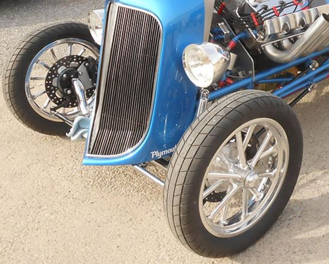

    I just did some brakes using the Hurst/Airheart 150 calipers from Speedway. These are not on the Raider 12 spokes, but they soon will be. Pretty simple deal, and the owner has since plumbed and hooked them up and they work extremely well.

    That caliper bracket is clean!

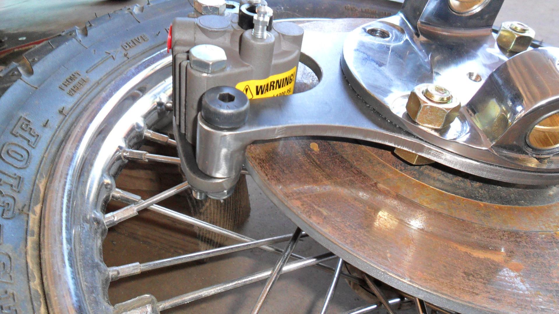

    I'm determining my requirements to use a 18x3 Radir 12 spoke spindle mount with my existing brakes and rotors.
    Here is a Pete and Jakes exploded view of a spindle mount with brakes.
    I'm looking for component #17.
    Mat Thrasher states on this thread that he fabricated this "hat". I agree with him on that I'm not real big on what's offered for spindle mount brakes.

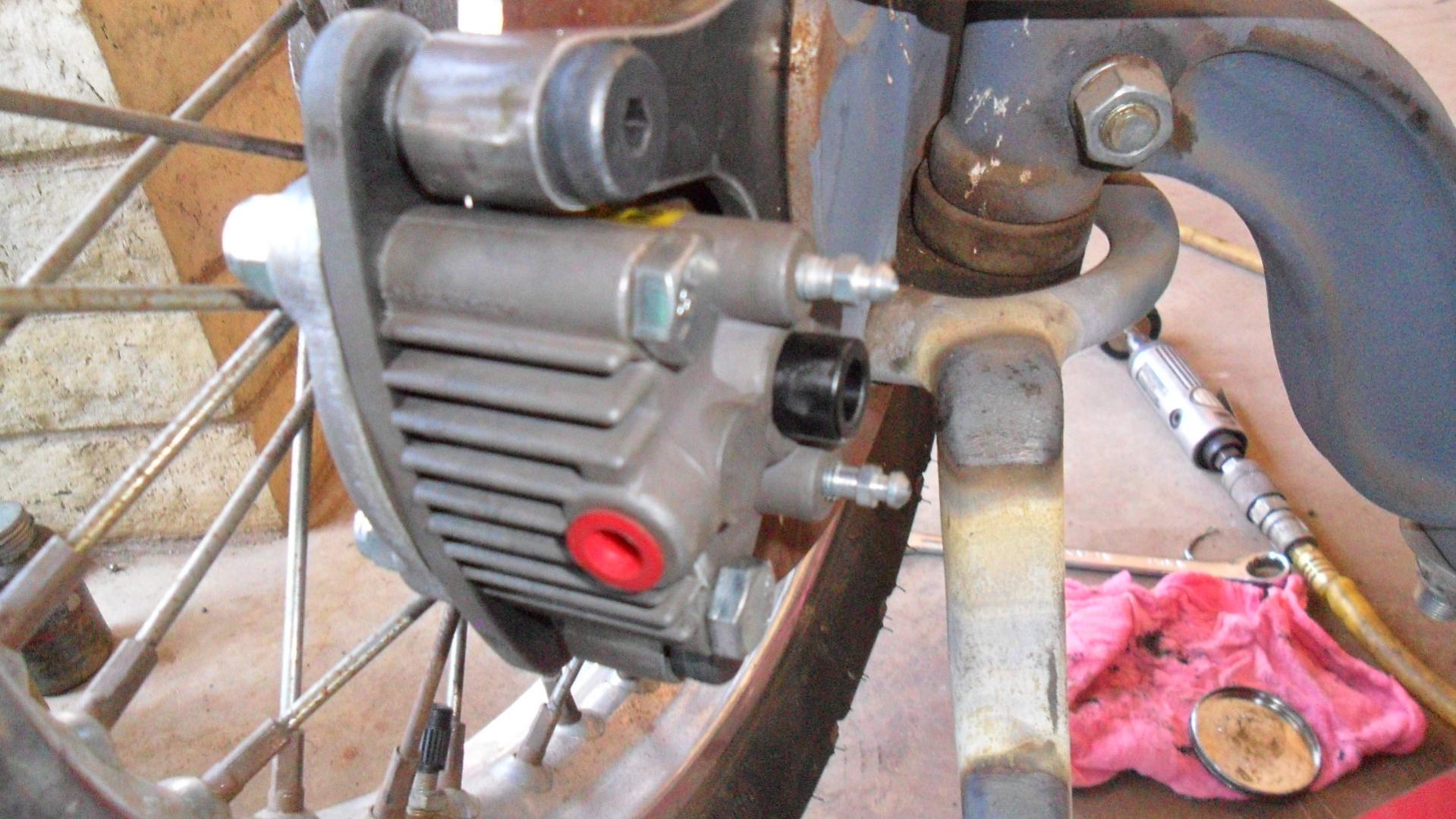

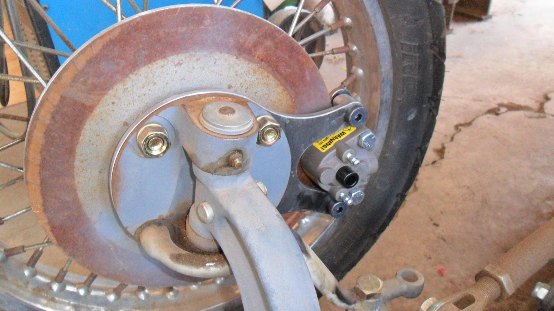

    Here's some pictures of the fabricated hat and caliper bracket. Full size brakes for 12 spoke spindle mounts.
