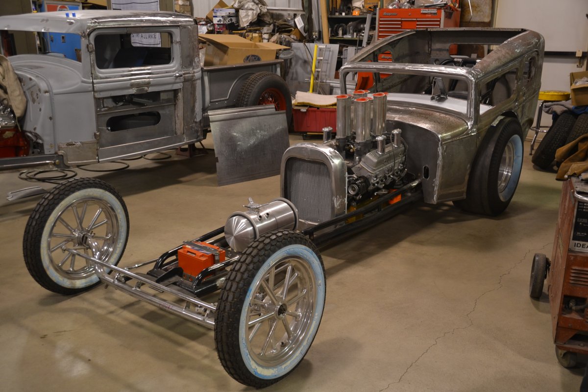

    Bringing this back from the dead..... what have you Radir 12 spokes folks done with tires/tubes/valve stems? I just got a pair of the wheels, and some bias ply motorcycle tires and tubes from Coker, and the valve stem diameter on the tube is rather large compared to the wheel. Are you guys running tubes? What's the scoop? I called Radir and left a message, but the wait is killing me. I want to get these mounted this weekend. Any info is appreciated. Thanks!

    These were financially out of my reach for a long time, but eventually I just came to the conclusion that anything else will be 2nd rate, because I always envisioned my T with spindle mount wheels... I just took the LONG road to get there LOL.
    Anyway, there's some progress going on. I will probably start a build thread on the 32 at some point and update the Belly ****on thread. But it will be awhile. I like to give good, detailed posts capturing lots of things I wish others would capture in their posts, and that takes down time (at work LOL), and work has been crazy busy.
    Essentially what's happening though, is I am cloning the drivetrain of the Belly ****on and putting it in the 32, so I can keep spare parts to a minimum and it's easier to keep straight in my head. Also, all the cast-offs of the Belly ****on are going on the 32. So while the Belly ****on has been an expensive pet project, the 32 is comparatively very cheap. Nice to hear from you. Happy Holidays!
    I think I reached the conclusion after a little digging that Coker sells one type of 18" motorcycle tire (EDIT: tire TUBE), that just so happens to have a valve stem too large for these wheels. I will measure the wheel valve stem diameter tonight when I get home, then find a tube that has that. Any input from anyone who's already been here and done it, feel free to chime in.
