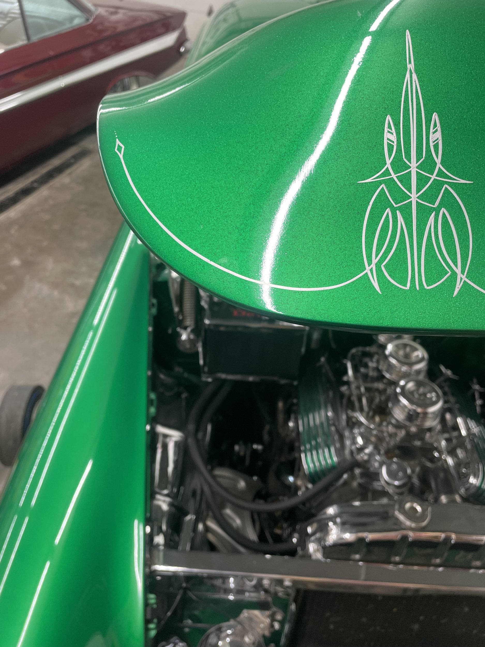

    In honor of the Custom Car Revival this weekend, let’s discuss a how to, on radiusing hood corners etc.
    I get the general idea, but I would like to see the underside of the hood and the inner fenders. Just wondering how these get finished out.

    Thanks Mark, that helps.

    Well I have to say that the fit and finish on Moriarity's Chevy is a lot higher than I did on my 61 Merc where I used metal strips to finish off the corners of the hood and the fender/grill surround and used the piece I cut off the hood as the filler on the fender.
    I'd put a lot more effort into it now than I did then though. I used an old worn chop saw disk for the radius and a saber saw to cut them.

    I have always wondered if most guys only finished the top side of the mod and figured customs are a “hood down” car.
