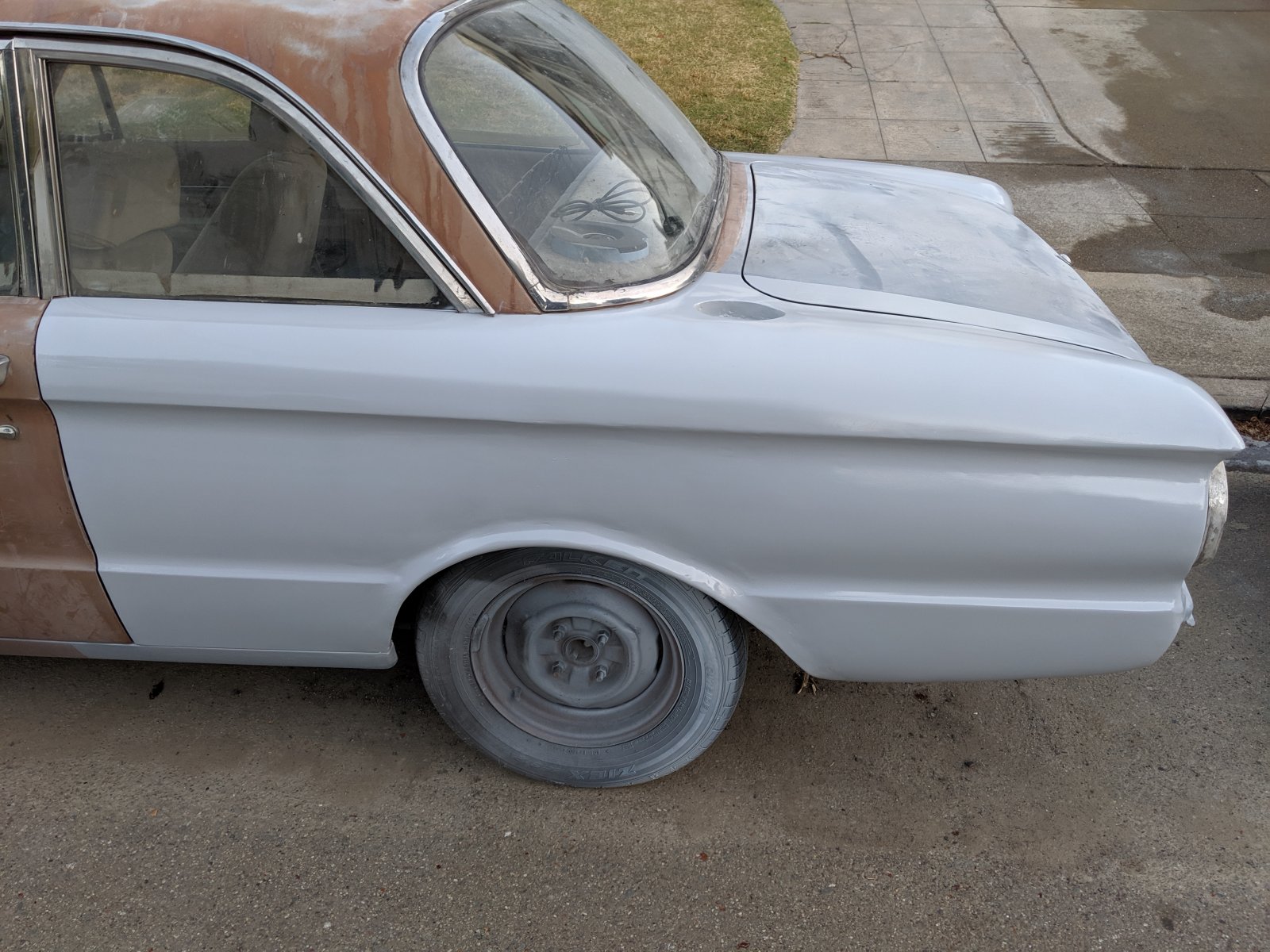

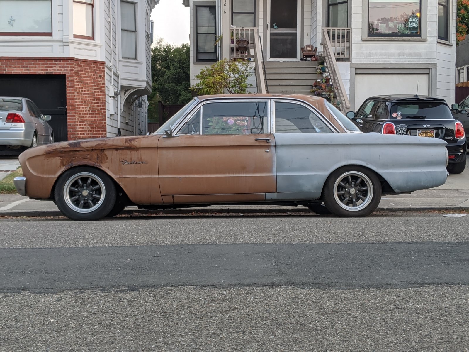

    This junker has resized Falcon wheel arches on the rear. IMG_20190728_201418.jpg IMG_20200802_201540.jpg

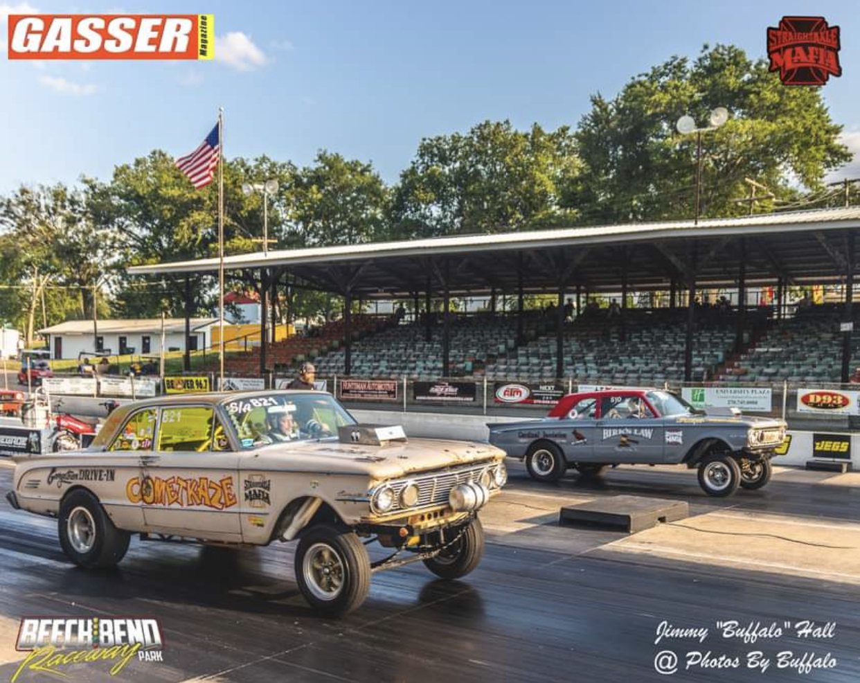

    A pair of Comet’s with radius rears. I’m in the far lane, my buddy Mike in near lane.

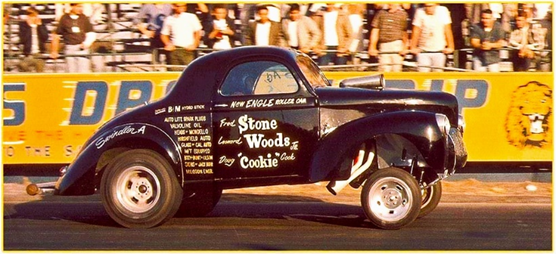

    One day, we sat using our chalk stick on a string to make the rear wheel opening chalk mark slightly larger to accommodate the new, wider slicks. We had already seen K.S. Pitman/John Edwards make the radius opening for his red Willys Coupe and the new M&H slicks.
    Pittman/Edwards Lion’s Dragstrip
    The new wider M&H slicks would have made our 671 SBC 292 c.i. motor get closer to the National C/Gas record. With the 7 inch Bruce Slicks, we were within .20 sec away from the National Record of 12.40 e.t. at 12.60 for our best time. Who knows how much faster the times would have been with the 9 inch wide M&H Slicks.

    That is not to say that any use of part-circular wheel wells is that. I don't think what @gimpyshotrods posted above is the same thing at all. It isn't about accommodating tyres wider than the body plus almost zero suspension travel; it's a completely different concept, all about what those Minilites imply.

  14. I especially like the fact that you resisted to urge to move the rear wheel opening too high.

    I ran them lower and tightened them up a little, as that is the way they appear on modern cars.
    It is what people expect to see, so they essentially disappear, by not calling attention.

    Marty , wise choice.
    Most of us have no clue
    Pics are from Beech Bend. We Love that Strip .

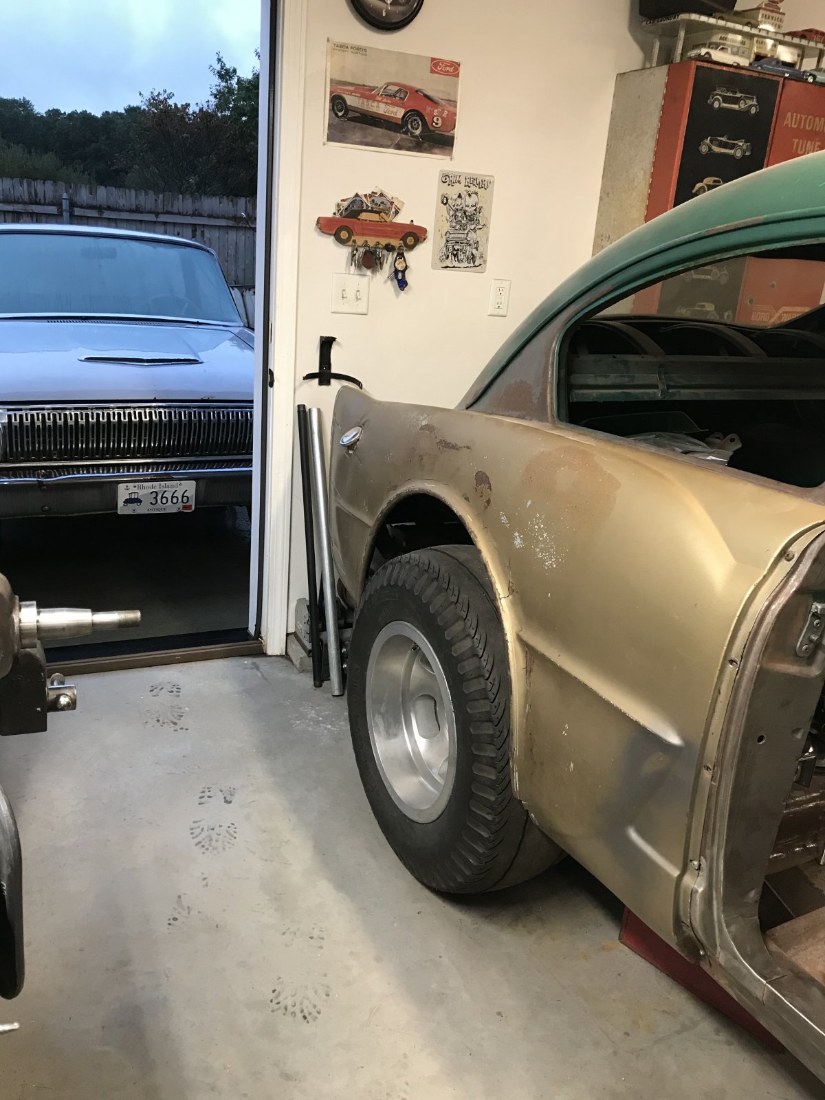

    Wheel openings from my wasted original Front fenders grafted to the rear.

    Nice work, we did the stock cars with twine and a sharpie to make the mark on the fenders. Cut it on the line with a torch, take water pump pliers, bend up a lip all around the inside. Finish it off with a dolly and body hammer. Most of the time it looked fairly decent and took an hour to do all 4 openings.

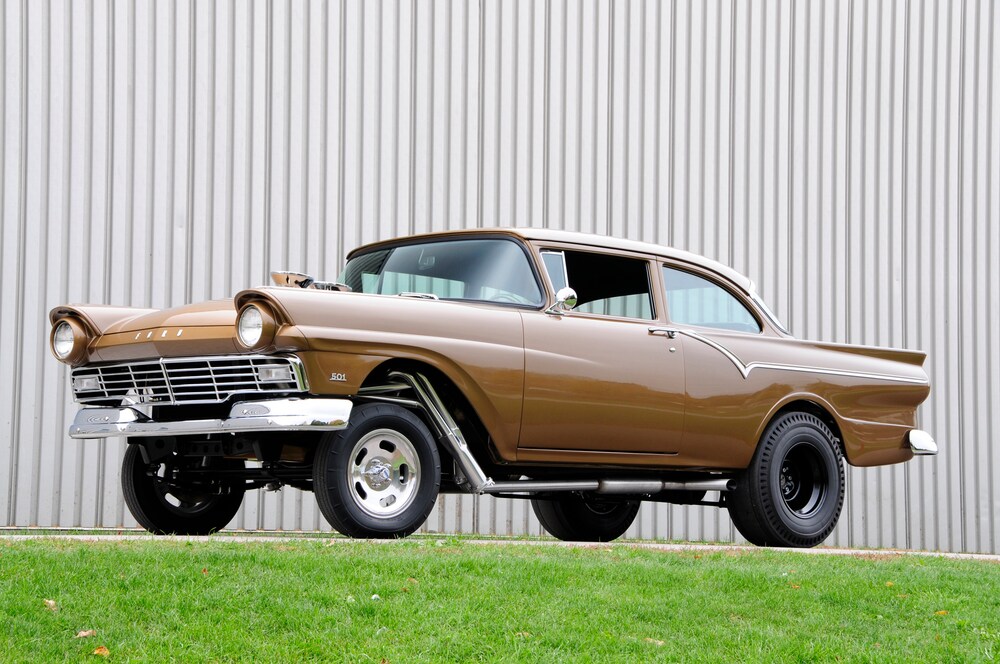

    My Pal Rob did the radius wheel wells on this 57... made a special buck to do them....
    Love everything about this car... except the exhaust.. which always looked like an afterthought.
    But the car is outstanding.

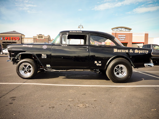

    I grew up living next door to the Barnes brothers and Wayne Sperry was down the road a piece. They always had fast and pretty cars. Their '33 Willys coupe was my favorite.
