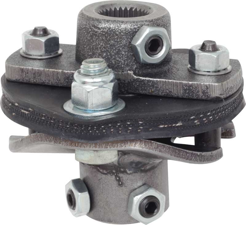

    3. Use an OEM-style rag joint. I'm really leaning towards this as this will reduce NVH as well as compensating for any slight movement, allowing a more 'solid' mounting of the column. This is one reason the OEMs switched over to these. I understand that these can't be used for angle changes, so column alignment has to be right.
    Next choice is which rag joint to use? I suspect that few guys here use these as most early cars are space-limited and these things are a bit bulky. But I do have the room, hence my looking at them. Both Borgeson and Flaming River offer them but want IMO stupid money for them. And I'll admit that I'm a bit spooked that Borgeson offers 'rebuild kits' for theirs. I wasn't aware that these were regular maintenance items, particularly for the hobby market. OEM replacements are available for much less money (and I've found one that appears that it will work with minor mods). I have seen a few OEM ones 'age out' but no outright failures.

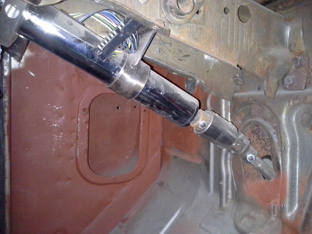

    My '55 F100 has a Toyo 4 X 4 p.u. P/S box, coupled to my modified F100 mast by a Borgeson 'U' joint.
    NVH has been 'notable', and now that my wife and I are doing a mild 'rehash' of the truck a rag joint is at the top of the list!

    Doing suspension work day in, day out for 45 yrs I've got no problems with rag joints. How many have been used and are still in use today?
    As stated above it's usually abuse, oil, or very old age that breaks one down.
    Also factory ones have safety features built in were you can't loose steering if the rubber breaks, lots of play but NO lose of control. Pretty much like the old 60's etc motor mounts with the safety catch.
    I would check a salvage yard for one and just grab a rebuild kit from napa for it. Also as stated above I always replace the nuts in the kit with stover nuts and call it done.
