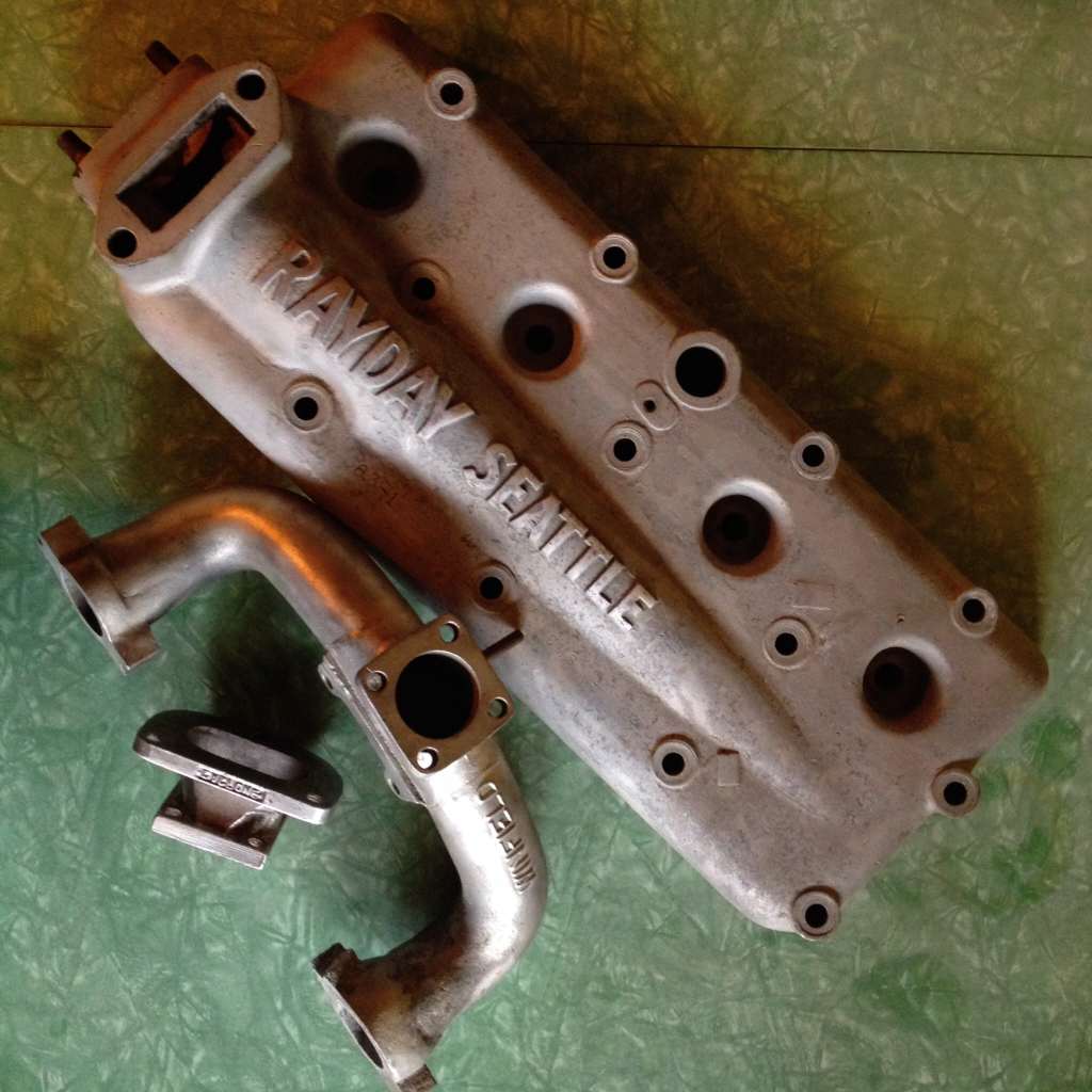

    So, getting down to brass tacks, here's what I will be throwing on the motor in the Phaeton:
    -RayDay Seattle 8.3:1 Aluminum Head
    -Winfield Manifold
    -Cyclone Winfield to Stromberg adapter (he ran a 97, which I also got)

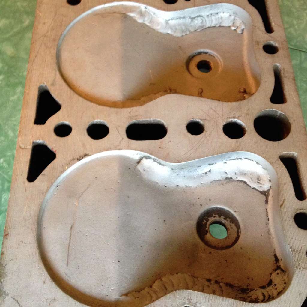

    The head uses Winfield type combustion chambers, that looks like were filled with weld and then ground to match between the four:

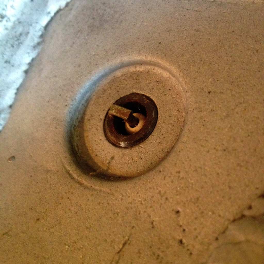

    Now I gotta figure out plugs. They use a 14mm port, but a appear to be a 7/16" or 1/2" reach. Here's what a 3/8" reach plug (Autolite A9) looks like in the chamber:

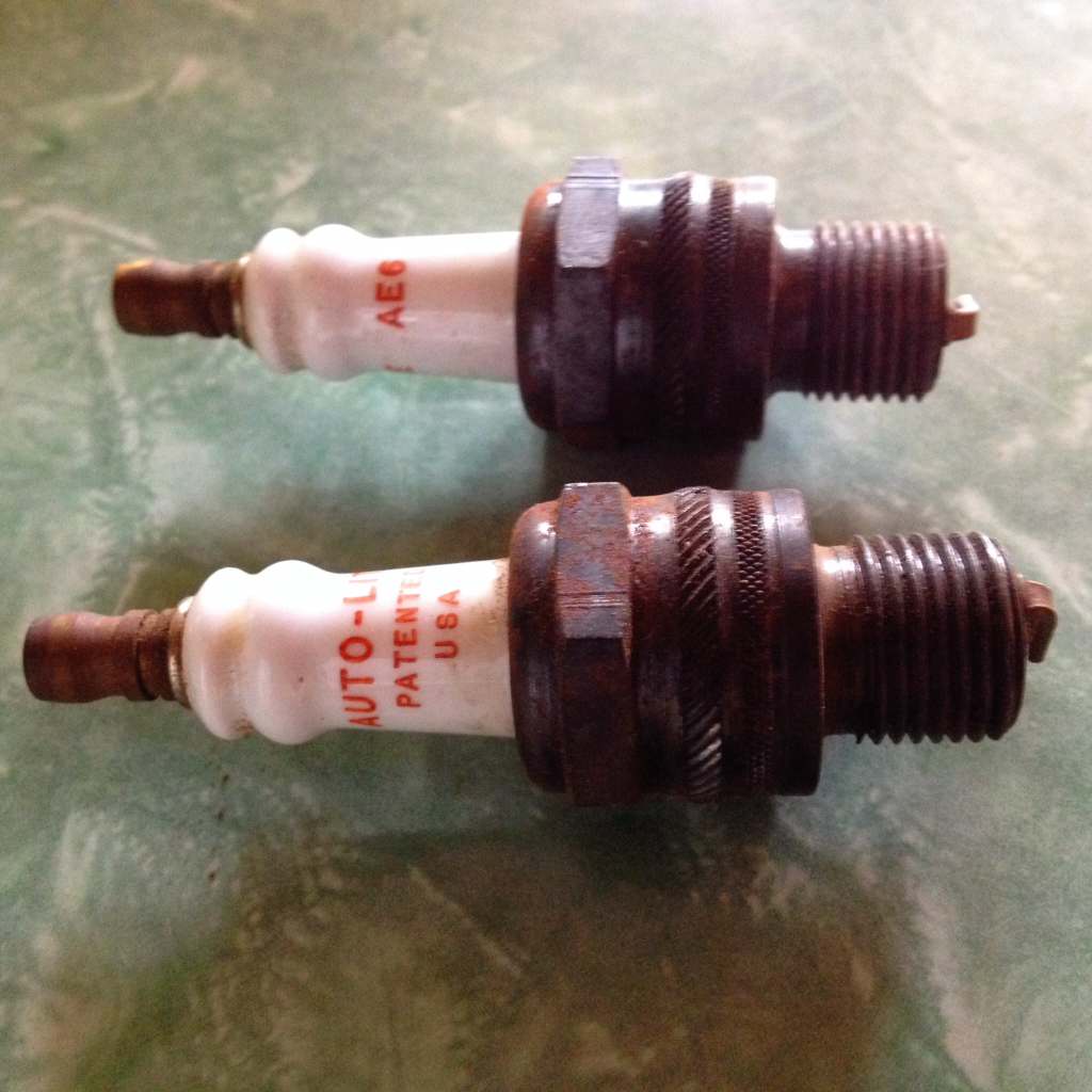

    I rummaged through my plug stash and found that an Autolite AE6 should be just the right size, but I only have three...
    So if you have one of these:
    ...I need it.
    Or if someone has a period chart of equivalent 14mm 7/16" or 1/2" reach plugs, let me know.

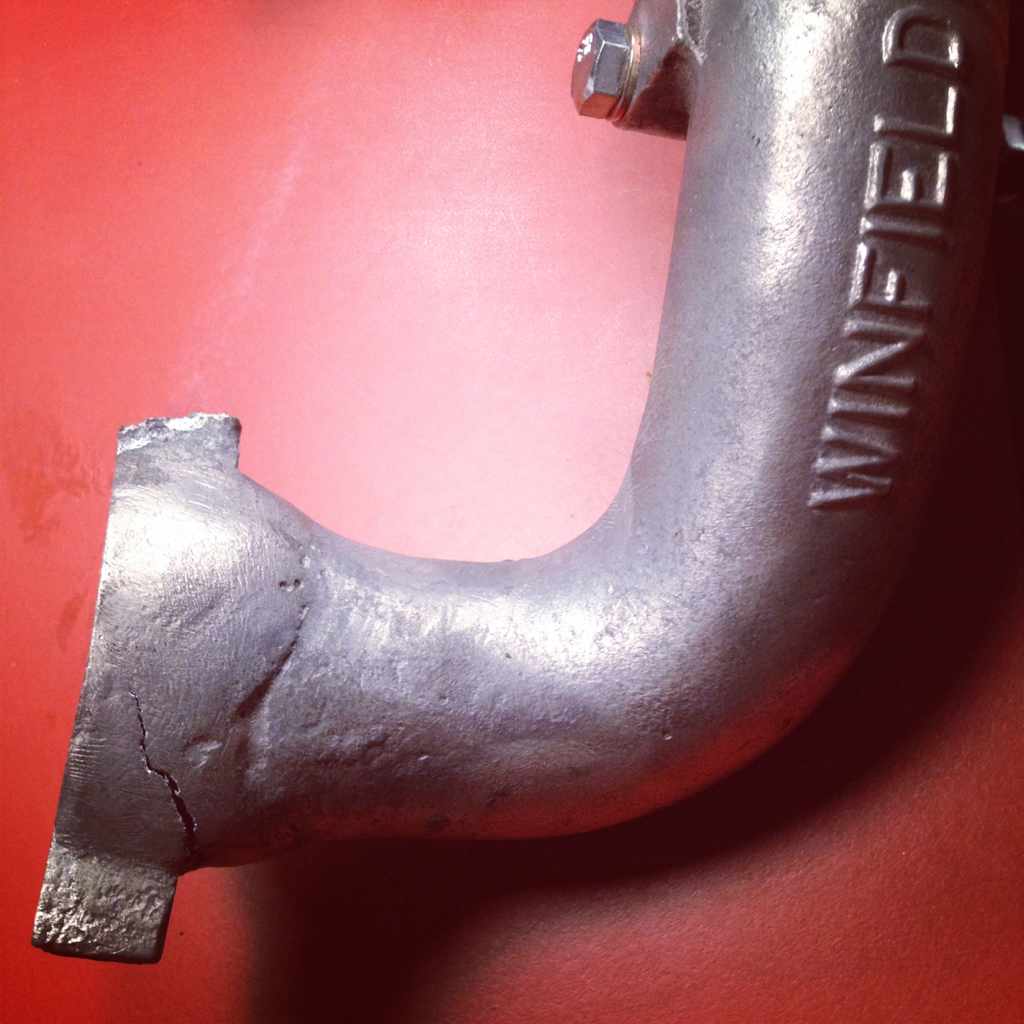

    First time on a hot rod since 1956, and...
    POP!!!
    Fuck...
    Posted using my Lil' Orphan Annie Secret Society Decoder Pin

  16. Bummer.
    Looks like it may have been repaired before?
    If the guy in Auburn doesn't pan out, I have a old guy up in Everett, that is pretty much the master of everything hot rod/machining/welding and is sympathetic to the cause. He's unlisted and backed up for years, but he'd probably fit it in for me. Probably fix it while we wait if we catch him at the right time.
    I've seen him weld a Merlin or Allison back together for a hydro. (Can't remember which)
    Shit, I should take you up there sometime when both our cars are together. He'd get a kick out of them, and I know you would love to see his shop. It's amazing.

    Dropped the manifold off with Dave at Aluminum Head Welders this afternoon. He was confident that it would be as good as new by the end of the week.
    Might do something crazy and fire the motor this weekend...

    Well, the update is that I'm at a work stoppage.
    I got the intake manifold back from Aluminum head welders. They welded it up OK it seemed, but then they surfaced the flanges with all the care of a amateur butcher with Parkinson's. Mating surfaces angled, differently from each other, and at least 3/16" taken off at the worst part. There is no way it could ever mount to a motor. I then gave it to an old timer machinist friend of mine who said he'd try to at least make it usable, if not pretty. Nope. The welds were so porous, and inconsistent that after spending the better part of a day trying to get something to work, he called me and said that it isn't salvageable.
    Needless to say, I'm kinda pissed and de-motivated.
    Anyone got a Winfield Manifold for sale?
