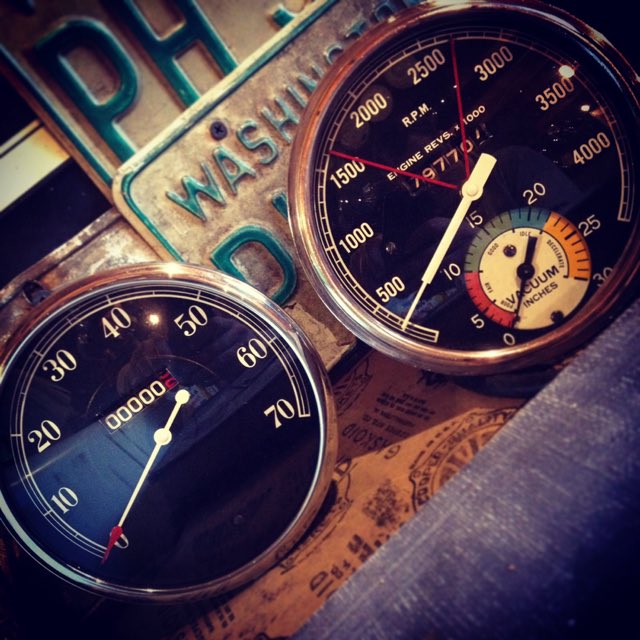

    So you may have gathered from my last post, but the phaeton is getting a new dash. Here's the new jewelry...
    They will be going into a '32 roadster dash once I figure out some fitting and clearance issues.
    Let's see if I can pull this off and keep the cowl tank...
    Posted using my Lil' Orphan Annie Secret Society Decoder Pin
    kiwijeff, Hotrodmyk and gwhite like this.

    Those are really cool. If you don't mind my asking, what did they off of?

    I'm not entirely sure what the original intent of these gauges was, but they are both 5" Stewart Warner curved-glass type. The Speedometer was NOS, in just a plain cardboard box, wrapped in paper and desiccant. The Tach/Vacuum Gauge is really nice used. Based on the low-revs and low top speed, I'd assume that they were intended for Big-Truck applications, but fit perfectly into the needs of a banger-powered rod that will never see more than 4000 RPM or 80 MPH, downhill, with a tailwind.
  20. madfish
    Joined: Dec 9, 2006
    Posts: 1,364
    madfish
    Thanks for responding. They're great looking. I agree with you about the truck application, it's similar to a
    tractor tach. By the way, you have a great looking car. I've enjoyed the thread.
