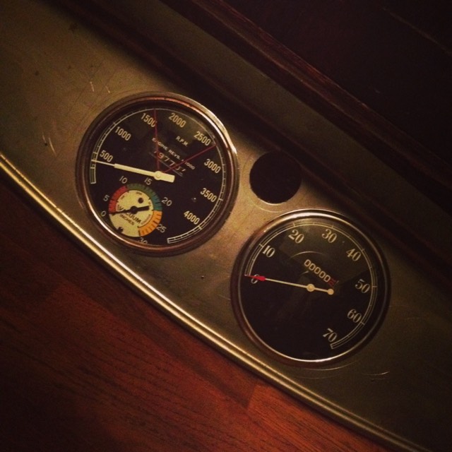

    Got the last few holes and adjustments done. Waiting on a couple warning light lenses, and it'll be done, save paint.

    snot275
    needs a cigarette lighter

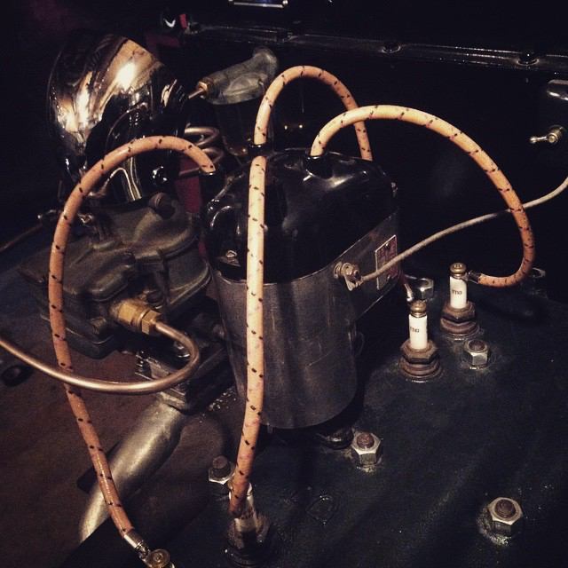

    Thanks all and sorry about the, again, stalled progress. I've been in Alabama for about a month for a course for work, and will be here until August. I'll be sure to give an update when I return. Not to mention, I have been kinda distracted by my '39.
    I did notice that I never posted this...
    A friend picked the WICO magneto up at a swap and offered it to me right about when I was having some issues with my distributor. Near as I can figure, this thing was built in 1945 or 1946 so it may or may not fit my timeframe perfectly, but if it helps my timing woes, I may be inclined to keep it even after I get my '32 dizzy rebuilt.
