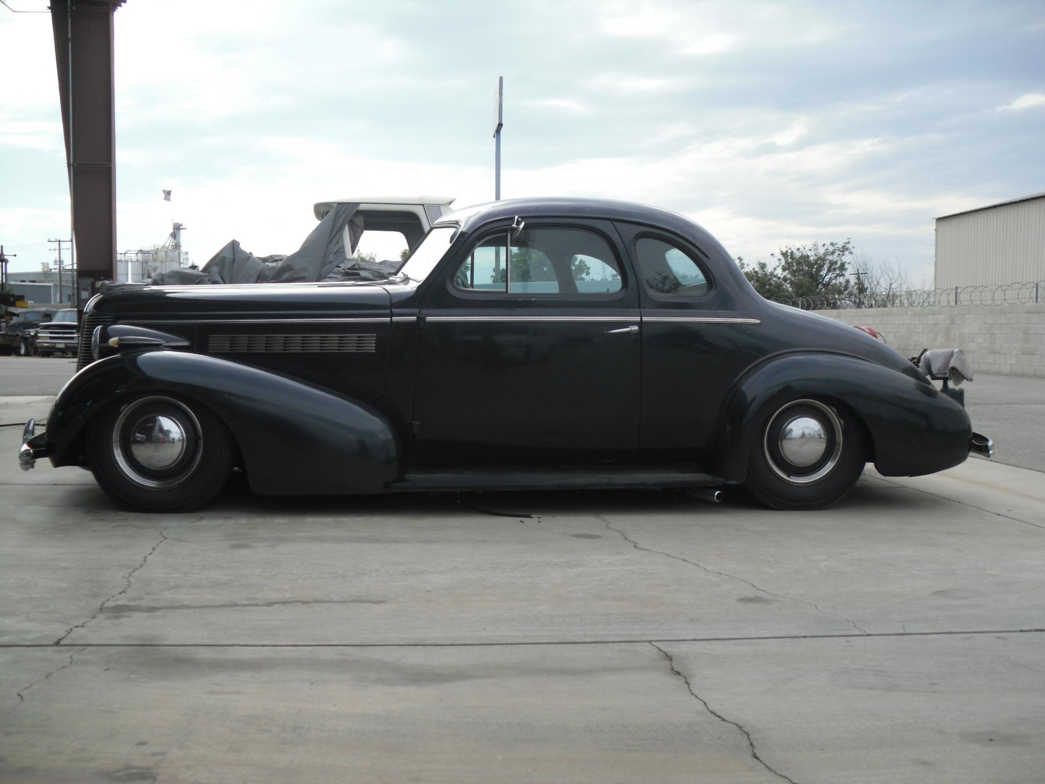

    Great looking car. Personally would love to see it as a mild 40s custom with slight nose high stance, teardrop skirts, appleton spots, and wide whites, leaving the rest as is.
    But 50s hot rod may be cool too, just seems like a car as elegant as a 38 buick would make more sense as an early custom. Just my opinion though.
    Im sure it will look great however you plan to do it.

    I guess my terminology was a bit off in my earlier posts. I guess by definition that the look I'm going for is late-40's to early 50's mild custom. In the end, outside of an altitude ajustment and maybe some skirts (I've nixed the visor plans since my innitial post) the exterior is going to remain fundamentally stock. Maybe some 'interesting' wheel covers too.
    Really, the big plans are going to be confined to the engine compartment. Califorina Bill's "Speed Manual" has become something of a bible to me. I've just got to find a few more Holley 94's...

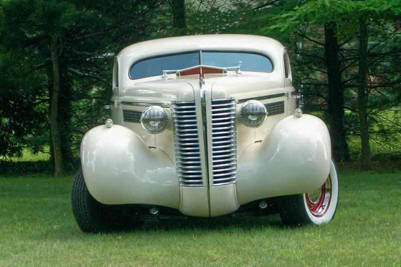

    Here's some proof that blackwalls can look good on customs! (as long as they're bias ;) )
    I would ask Rikster or James D for a photoshop in your vision so you can really get all the perfect details worked out.

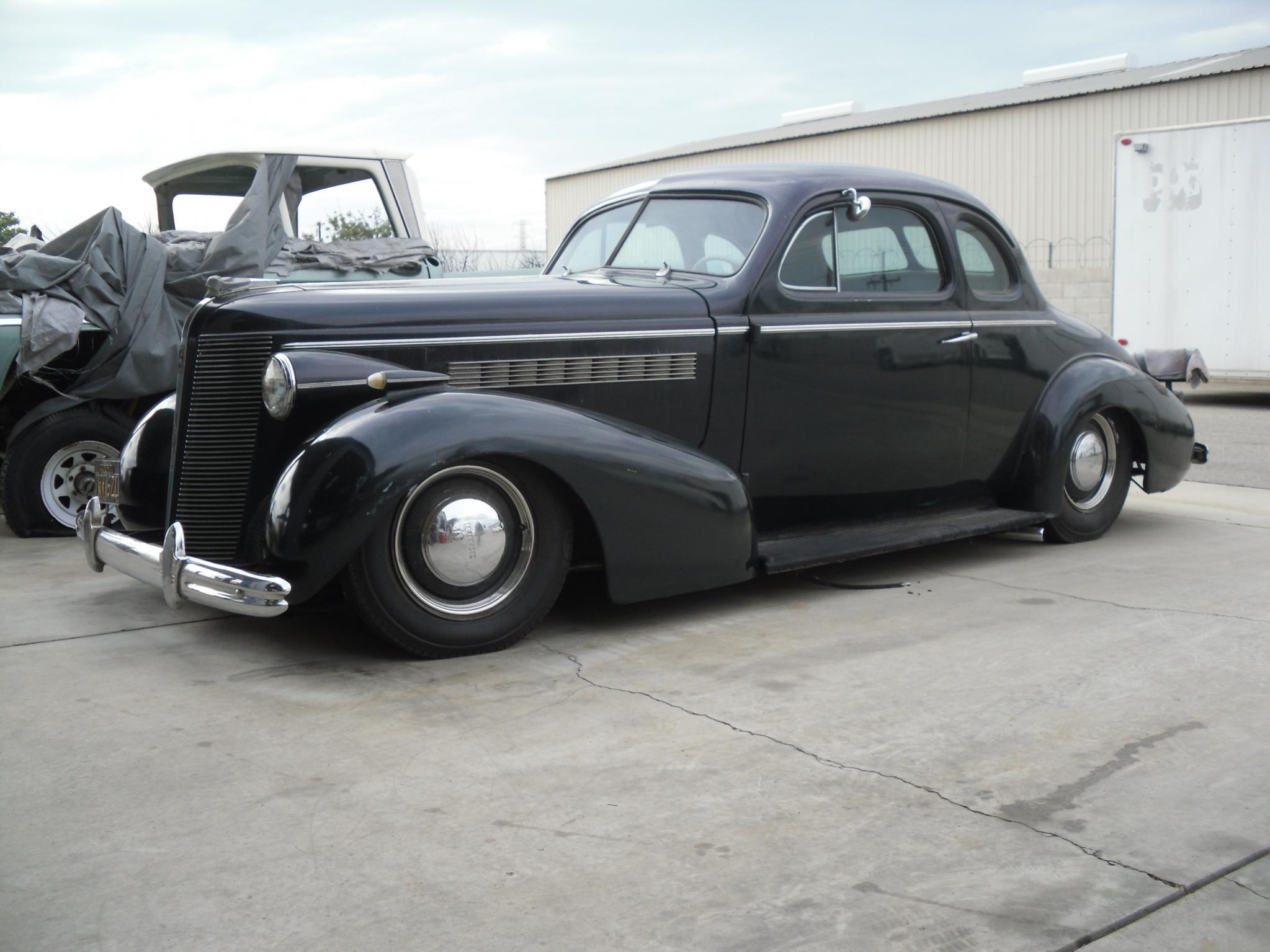

    Anyway, one of the original brochures for Buick's 1938 line up has my car's model shown with the same color scheme as mine had when shipped out the factory door as evidenced by the firewall tag...
    That's the color scheme it will be returning to, Whistler-Grey on Dante-Red wheels. At first I was hesitant to do the oft done grey on red wheels, but hell, I've got a great excuse in what's stamped on the firewall! Its a cool grey too, its an almost black charcoal grey with a very, very, very fine metallic. Envision the above pic, without white-walls, a little lower stance, amber fog-lights, and red pinstripping on the beltline, grille, and anywhere else it suits my fancy without going over-the-top.

    would love to see this photo photoshopped with a roof chop and wide whites...anyone? I know it takes time though... thanks in advance to anyone for the help. The illustrations always make 'em look lower in the roof than in reality i think too

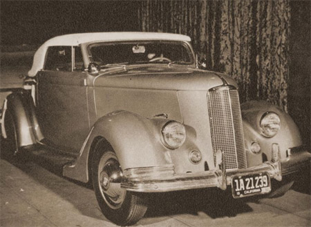

    It's not that picture, but here is two that I was playing with of mine, chopped and lowered.

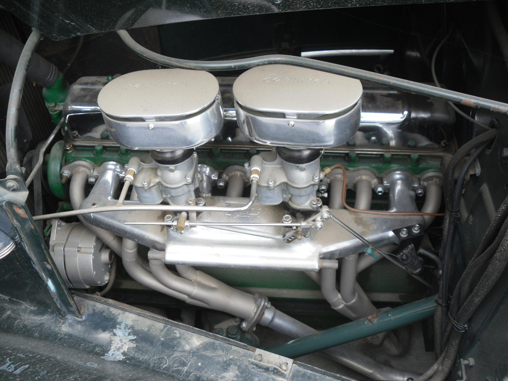

    My project.
    Yourse is in good shape :)

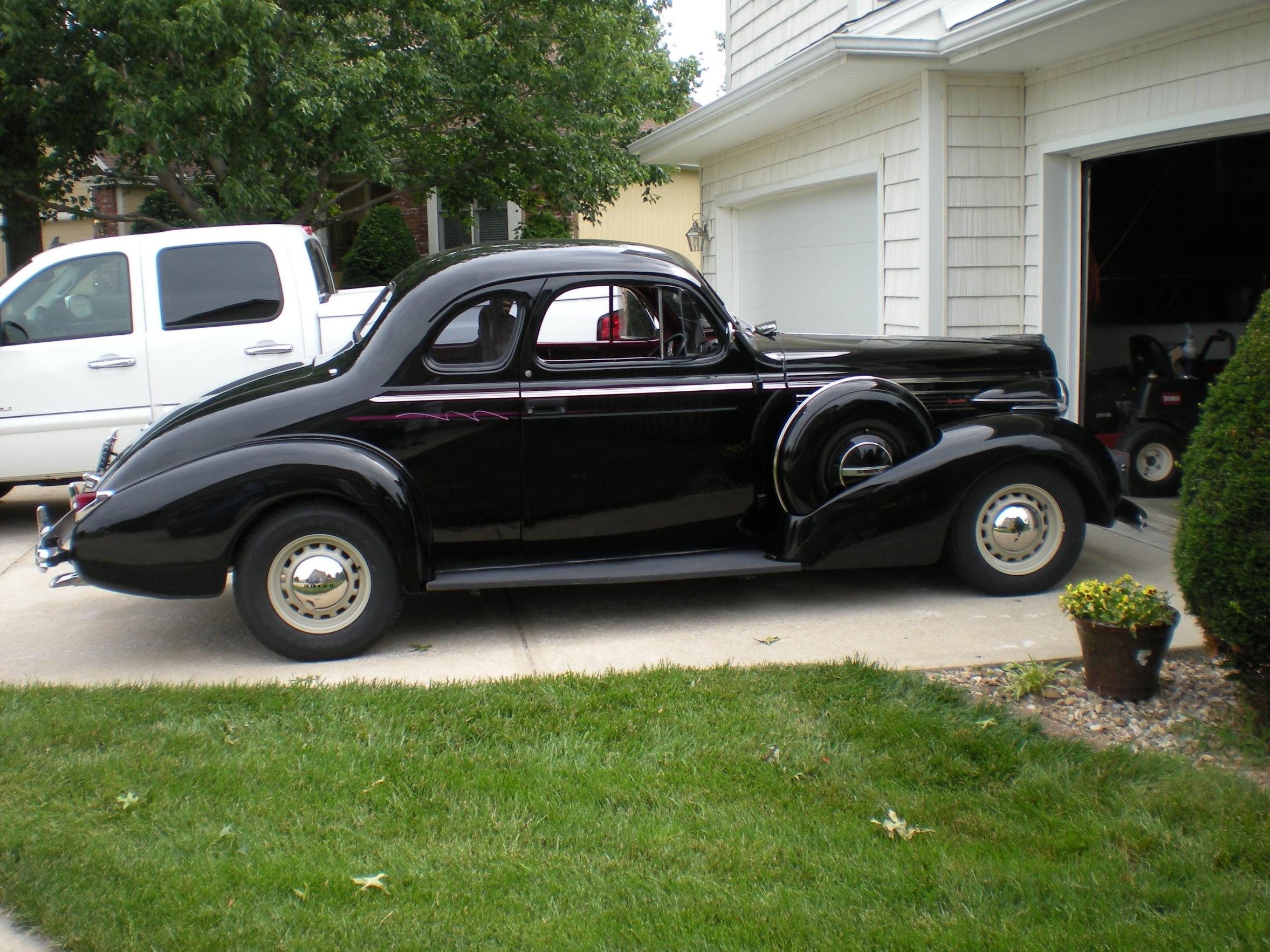

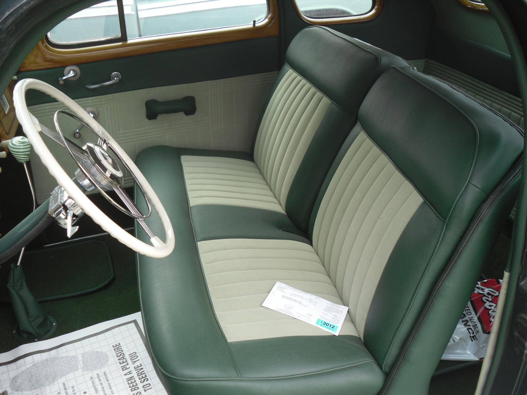

    Here's some pics of my 37 buisness coupe.Sorry for the dirt it's been covered up for the winter it's never been this dirty but just don't have room inside.It's the original paint so not too big a deal.It's a 248 with edmund intake, dual carbs, pertronix ignition,custom tube headers,700r trans,disc brakes,S10 rearend and air bagged.I like the blackwall look just thought I would show you what blackwalls look like on one of these.

    Car looks good. Your pipes don't look like they have much ground clearance.
