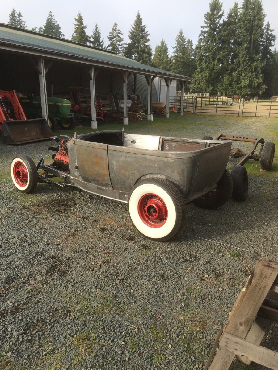

    I'm going to post a couple of pics of Ralphy's tub. it's a project that has taxed all my faculties, and will continue to do so for at least the next couple of months. What makes this car special to me is that it is comprised of either ancient Ford parts or hand fabbed one-offs. Though far from perfect in design, style, or execution, these hand made parts started as raw materials, including the frame rails.

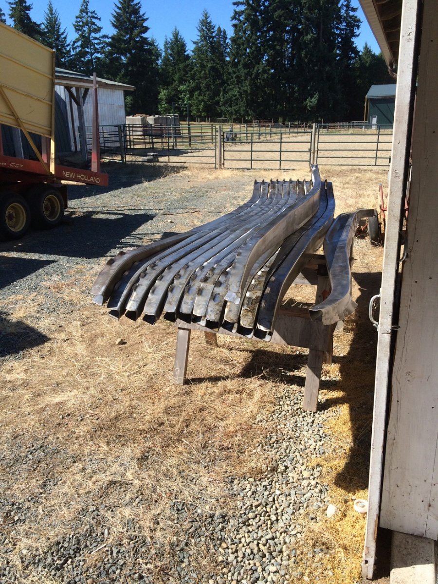

    Frame rails pressed from flat 11 gauge p&o flat stock on Ron McIntosh's old press.
    The rails used for this car have a 4 degree up-sweep starting at the cowl, achieved by installing a wedge into the press tooling, and alternate dies. Pretty awesome machine for its size.
    The rail on the far left in the bottom pic are of the "modified" or up-swept persuasion.

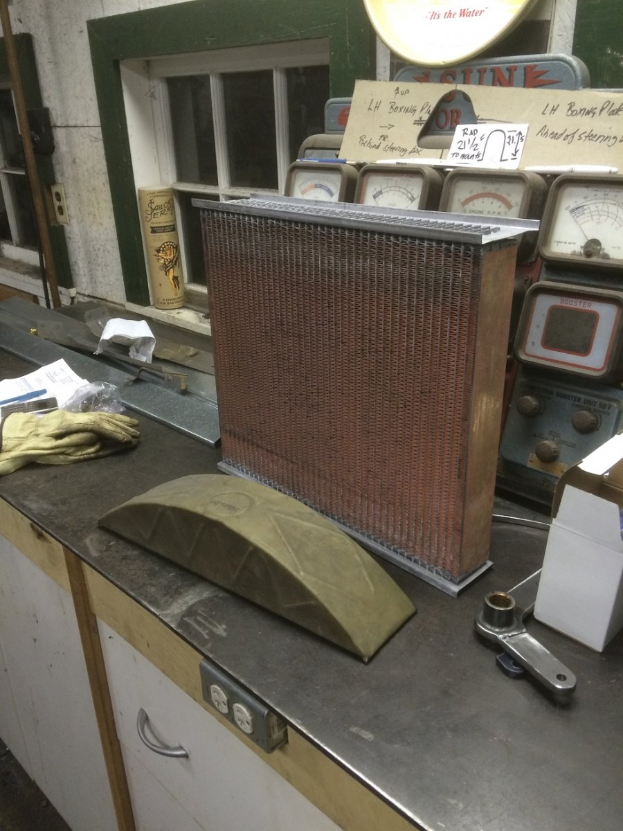

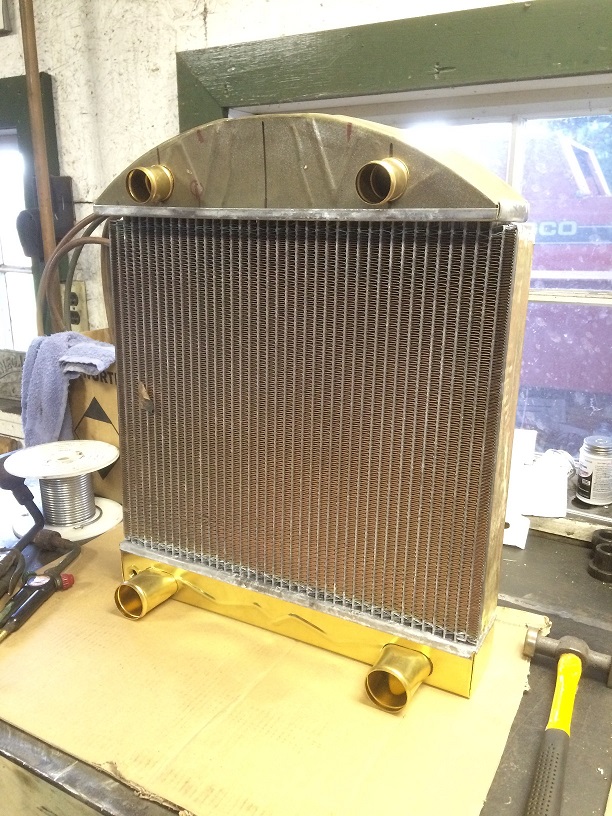

    Rad stuff was purchased at a reasonable price. Found not one but 2 guys getting out of the rad business nearby. Bought torches second hand and the one fellow supplied me with all the tinning paste, flux and solder to get a couple of rads going. I'll laugh if this thing DOESN'T leak right out of the gate!

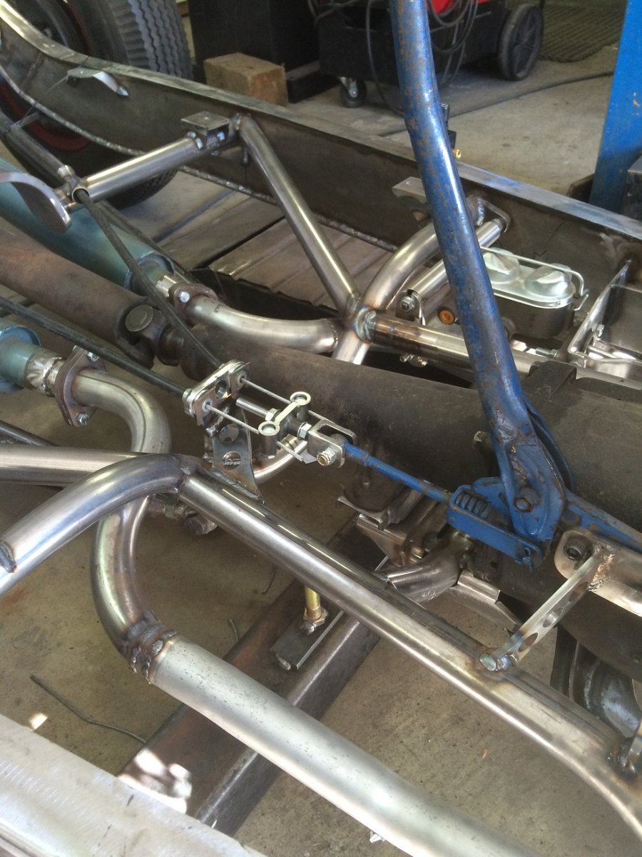

    Spent the entire weekend hooking up the e-brake (or park brake technically). Welded bungs into the '39 or '40 backing plates from an old set of 9 inch ones I had in the back room. Would rather have taken it all apart and done it on the bench but I'm starting to panic - it's August already!

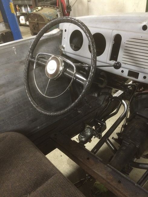

    38 Ford dash - 50 Ford mast, wheel and shifter. 239- 3 speed. OD in the works.

  19. kidcampbell71
    Joined: Sep 17, 2012
    Posts: 4,756
    kidcampbell71
    Hell yes ..... you are the man !!

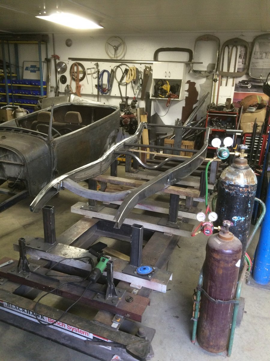

    blowing it apart this weekend for all the final welding. All builds that require a BC ***igned VIN also require a motor vehicle inspection as part of the process. The MVI will require a structural integrity test, which has a box to check off for weld inspections. Welds cannot be dressed (within reason - you can clean them up as long as no appreciable material is removed) so I will be doctoring up all visible (with the body on) welds with the tig.

    I like the E brake set up, thinking about a similar approach on mine.
    What are you using for a pivot on the rear radius rods, Hiem joints?

    Yup. I got a pic somewhere. I also made quasi-ladder bars out of the radius rods. JustplainJ said these things will break if you don't have an upper member to stop the twist. I went a little over board on them.
    You can kinda see the heim joints here - as well as the DOM tubing. I cannot weld permanent web members in the radius rods - cause I'll never get the rear end out! I was thinking of making webs that welded to the Ford part, and bolted to the DOM. I think they are strong enuf for that 239.
    Don't laugh at the pinion angle - it's textbook - though Matt laughed at it! Machinists!
