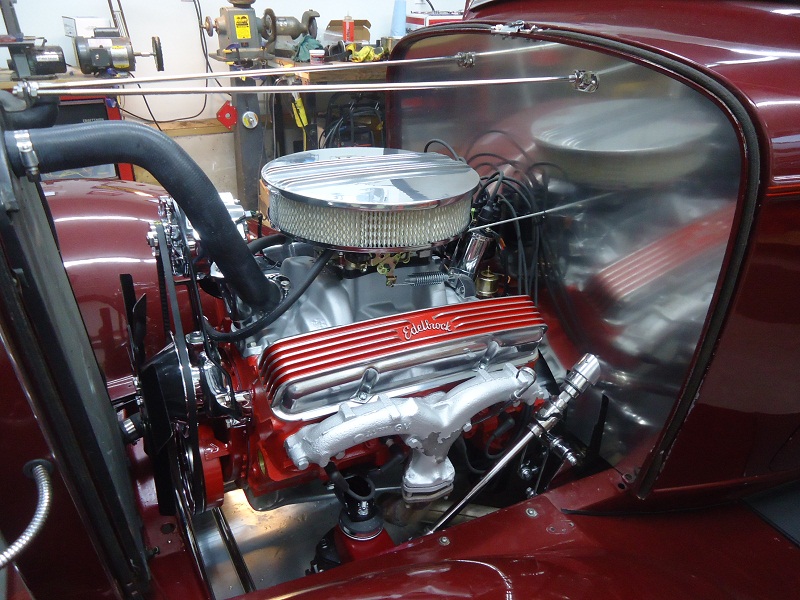

    Here's a shot of my motor with the GM "ram's horns". They fit pretty tight and look good IMO. Except for the damn 1800 Deg. VHT paint that has flaked off twice !!!!

    Same here, ram horns fit well, no leaks no BS. Also this is 2 year old VHT. Blasted then, baked in an oven and then installed them a few days later. No fading or flaking.

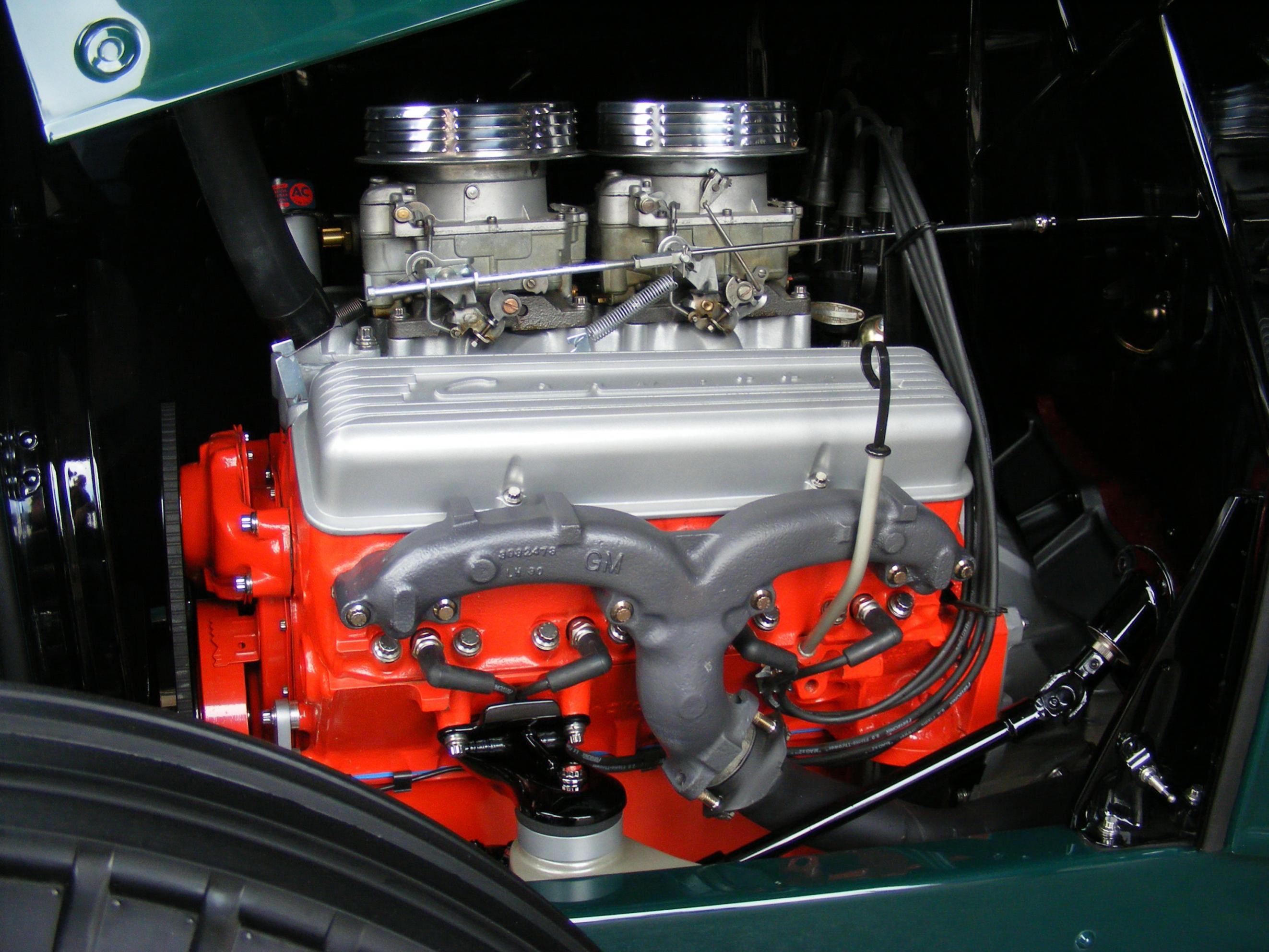

    I save this picture that I got somewhere. It shows how I want my engine to look. I think the stock ram horns from a 68-72 Chevy truck have the turn up like this to clear the steering shaft. I remember my old 56 Chevy had a 58 corvette engine in it and the ram horns went straight down into the exhaust pipe. I don't think you can beat a good looking set of ram horns.
    1Nimrod and pecker head like this.

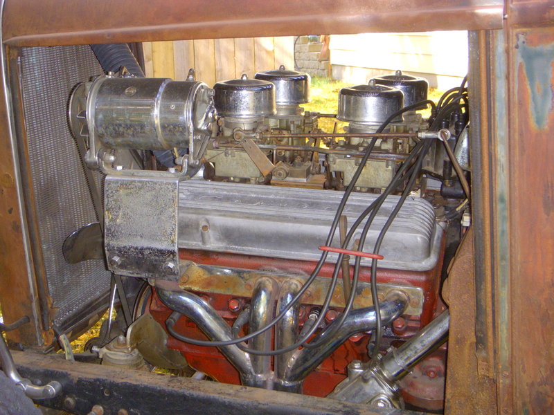

  16. i ran into a header issue to with my build,nothign would fit between the frame and my steering/clutch likage so i am going over teh frame and out the bottom of the fenders

  18. Man I'd like to find a set of these...The best I can make of the casting number is 3932473 (?)
    Online application charts show '69/'70 Chevy "B" body, 307/350" for that number..
    Anybody else got more info on this type of rams-horn manifolds...
    xhotrodder : Can you look @ the casting number for the manifolds in the pic you posted???
