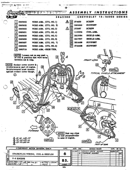

    Found this....... hope it helps

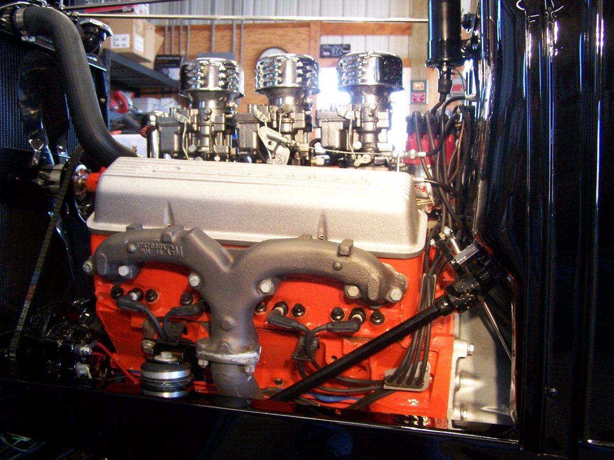

  10. Blake 27
    Joined: Apr 10, 2016
    Posts: 1,554
    Blake 27

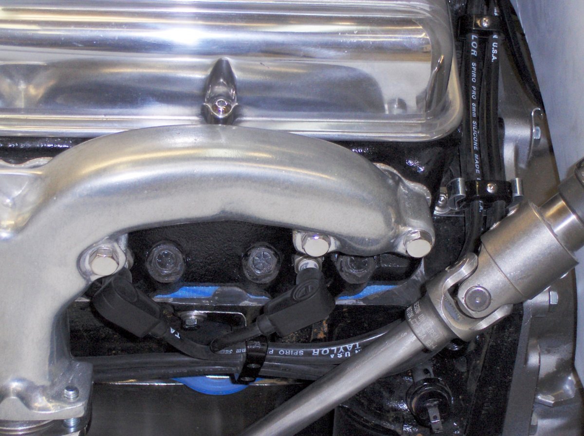

    Just as Squirrel said, run the front wires behind the motor mount pad.

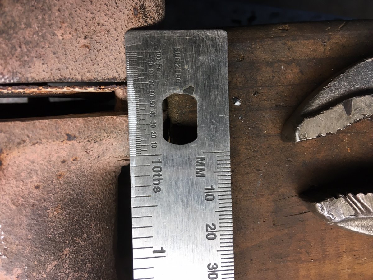

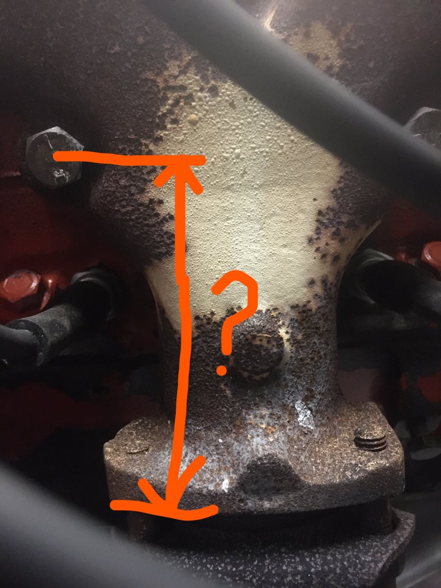

    I want to install the smoothie manifolds on my model a with a 350. Driver side is extremely tight. I am including a picture of a dimension i need to be sure it will fit my application. Can someone provide that? Or are they made to exact size of the OEM manifolds?
    Thanks

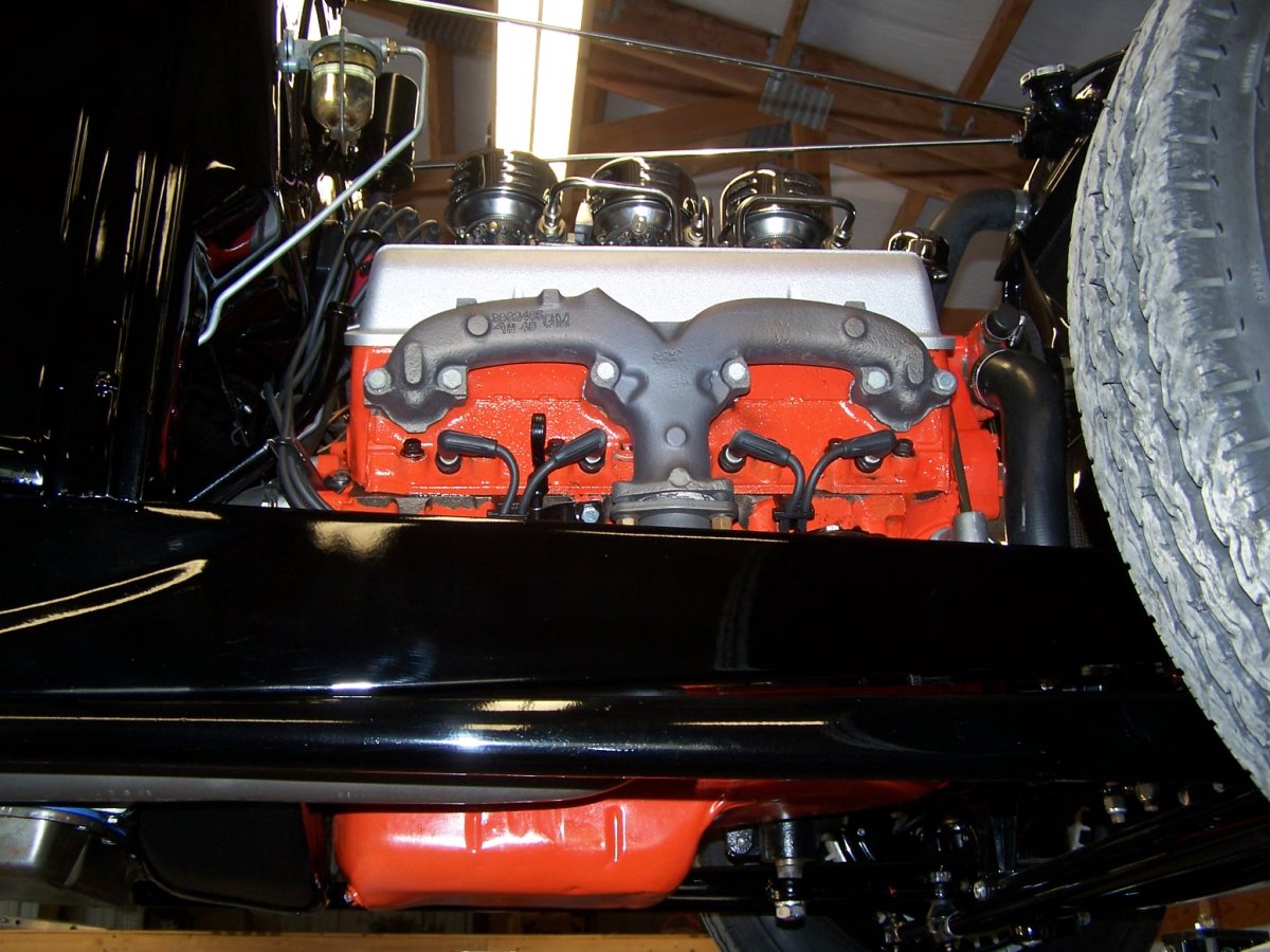

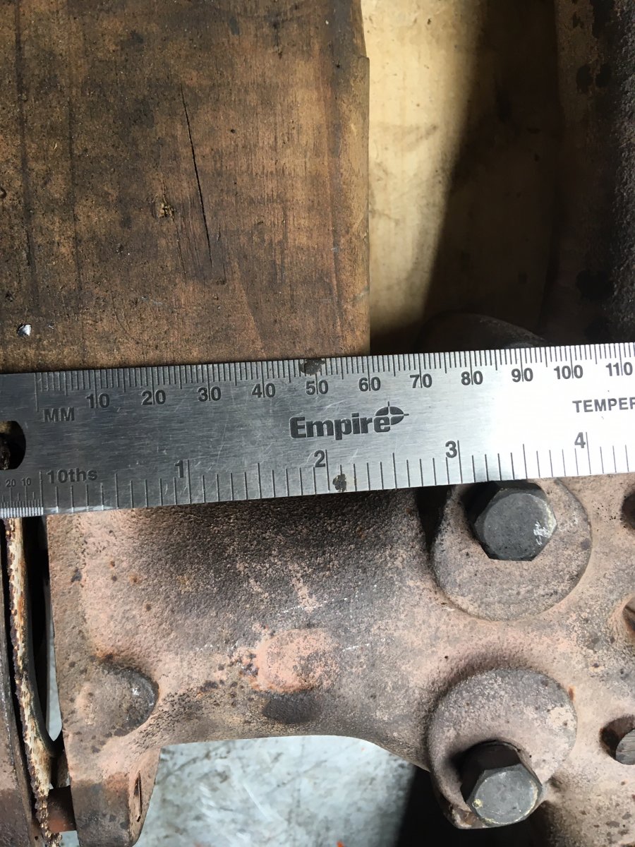

    Looks like 3.4 inches. These were stock manifolds off a 66 Corvette (of course ;))
    Phil

    Never liked the look of wires over the valve covers. Look at the info. Shorty provided. You can't go wrong doing it this way. Everything looks very tidy.
