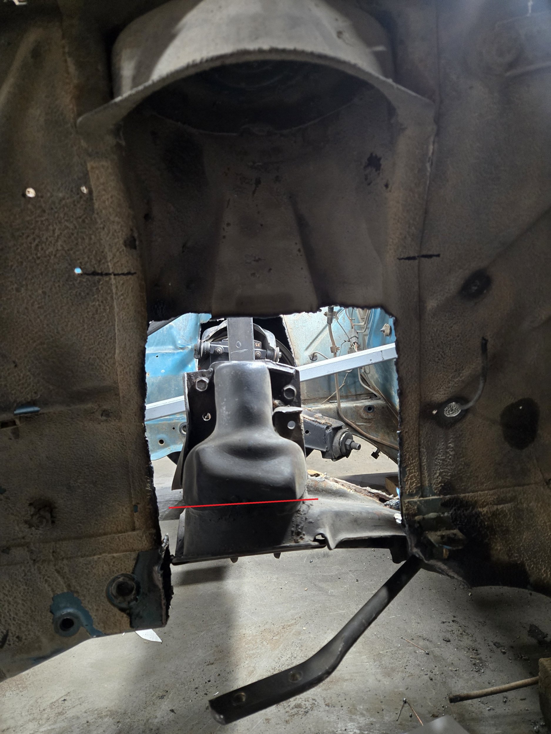

    I started by clipping the front crossmember in half and taking 5 3/8 out of it.
    As you can see from the engine in place, I’m sizing up another 2 barrel intake for it.
    It may get the carb off the T roadster if I get the four carb manifold on it soon enough.
    I then started slicing into the Strut-type-towers, and figured before I cut too much I should add some structure.
    Now that I have structure in it, I started slicing a big enough hole to fit the upper A-arm through.
    So full mockup again, with half the crossmember.
    Once I’ve mounted it fully, I’ll box it all in with plate.
    Then I cut the driver side strut tower out, and welded the crossmember together into one piece.
    After figuring out where I thought I needed to have the front clip, I did a bunch of measuring and tweaking to get it as square as possible.
    Then I put some tacks in, and installed a brace to tack it to the center support
    Then it was back to another mockup. this time, with no wood blocks holding the crossmember!
    Its a little further forward, but it has really good steering clearance.
    It puts the upper A arms at a little steep of an angle, but I have a couple ideas for that.
    It may move back a half inch and up another smidge.
    we'll see.

    I had a slice of time in the shop last night so I cut loose the front clip after supporting it on blocks again.
    I moved it back 3/8 inch and up about 1”
    Once I got it squared up again, I set to tacking the crossmember back in.
    The side view is much better now, with it further away from the front of the fender, and with the crossmember one inch higher, it makes the angle of the upper A arms less extreme.
    I also spaced the wheel out just a little to clear the disc brake caliper, and it made my steering angle just a little bit better.
    still remains to be seen what steering box I use for this, but there's pretty much no chance the tires are gonna rub.
    and it looks killer too.
    I am planning out a trip for this Saturday to pick up a bumper, and some coils for my MII coilovers.
    I have a lot of welding to do.

    Got a few minutes to work on it last night, had some visitors in the shop for a bit, and didn't get started very early.
    I decided I was gonna start filling in the holes.
    so first step was a multi piece paper pattern
    I made the top part but then remembered that I had to get the a-arm through the hole.
    I used the p***enger side that is still mocked up to get an idea of how high I could put the filler.
    and roughly cut out:
    It looks like it fits worse than it actually does, I have to get it shifted a specific way and do a little t******* to make it sit nicer.
    And right after I drew the above sharpie marks on where to trim the plate, my angle grinder decided to take a dump. It was only sometimes running when I hit the switch. I took it apart to see if it was a rebuildable part and I cant find anything wrong with it, and when I stuck it back together it didn't work at all.
    So I'll have to buy another one of those today.
    but progress is progress.

    Since it looks like the lower is going to be fairly flat, but the upper is angled a lot up and out, would it be possible to cut and lift the 'hat' so the upper mount is more aligned? Maybe source another hat and weld it on top?
    porkshop likes this.
  25. BigJoeArt
    Joined: Dec 12, 2011
    Posts: 978
    BigJoeArt
    well, actually, the main reason that the upper arms are so angled, is because the spindles have been swapped for chevelle spindles. a common swap for these front ends, but it comes with a taller spindle height.
    I'm currently looking at aftermarket "short spindles" to see if they would help.
    It will work in its current configuration, so for now it will stay as is. if I needed to I would add tabs above where the current upper arms attach rather than raise the whole hat.

    This last weekend was eventful, with me and Kid #1 going on her first long distance parts run.
    As you can see we picked up springs for the mustang 2 coilovers I'm using for the front of the rambler.
    I also picked up a rear bumper, which could be used as a front or a back depending if I found another nicer bumper or not.
    currently my rear bumper is homely, but still better than the non-existent front bumper.
    now I'm on hold while cleaning for company this weekend. but If I need a place to relax for a minute, it sure is comfy.
    more progress next week probably.

  28. BigJoeArt
    Posts: 978
    BigJoeArt
    oh I agree its not optimal, but I was just saying it would drive with it set up this way.
    the tall spindle is the instigation of the problem, since the bottom control arms are pretty much flat in their current placement.
    but if I cant figure anything else out, a set of braced tabs above the current set would solve it.
    RodStRace and porkshop like this.
