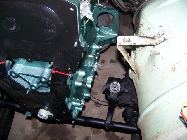

  5. ramzoom
    Joined: Apr 25, 2008
    Posts: 382
    ramzoom
    Hi guys,
    No enclosed driveshaft on the Americans...
    The biggest problem you will have is the overall size of whatever you want to install. The humps can be cut yes but you cannot do anything about the steering box and tie rod unless you eliminate the front end..Not much will just drop in. Again, it is becuase of the front steering.

  11. ramzoom
    Posts: 382
    ramzoom
    Olds Quad 4. To give you an idea of fit...
    Quad 4's are 19.250 tall, 18 inches wide. 21 inches from belhousing flange to front pulley.
    Not sure how long and wide the Ford is?
