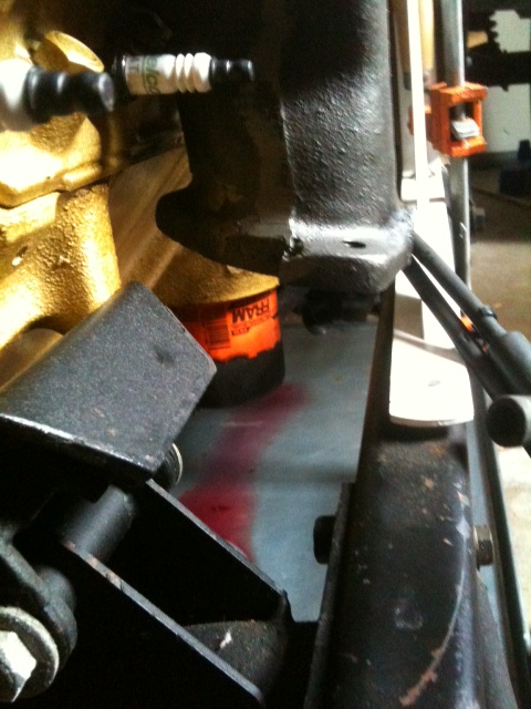

  1. So i got my 2 1/2" rams horn manifold, but its a super tight fit. If i can use a 2" pipe with a slight bend it should fit with some clearance. I got a 2 1/4" pipe with a flange on it and it gives me about 1/4" clearance but ive got a bit of a cam and the engine needs some clear space.
    So can i put a 2" pipe to a 2 1/2" flange, or any other suggestions on how to do this.
  2. Muffler guy can neck down the 2 1/2 to 2.

    Instead of bending tubing, how about fabbing a 2-1/2" S shaped mitered joint, probably do it in 6 pieces.
