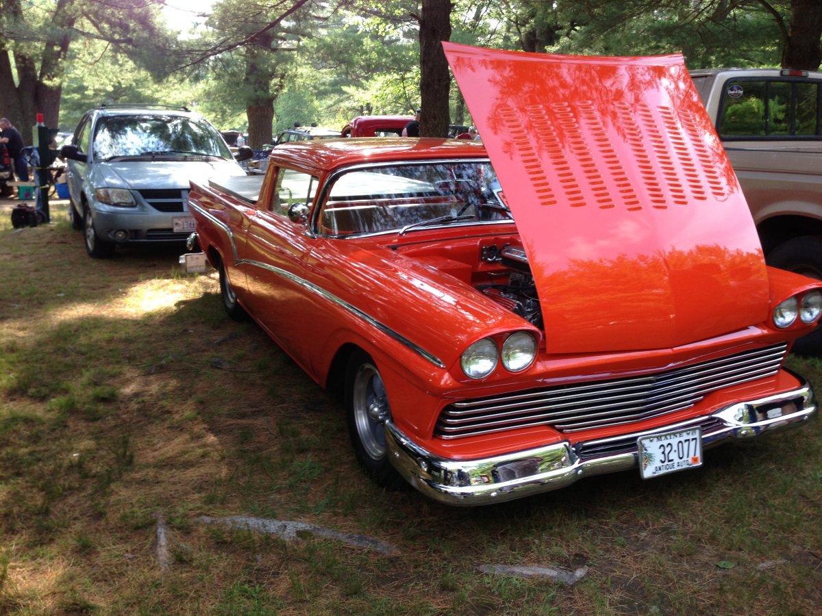

  23. Ford blue blood
    Joined: Jan 4, 2009
    Posts: 801
    Ford blue blood
    I am watching. Rancheros are my favorite, building one right now. Have a thread over on the 57 site. Love the stance of yours. I cut 1 3/4 turns out of the stock coils. Was a 292 car.
    Hit that braze with a course grit sand blast and epoxy primer will stick with it all day.
  24. Here's a little inspiration iphone pictures 226.JPG iphone pictures 226.JPG iphone pictures 222.JPG .
