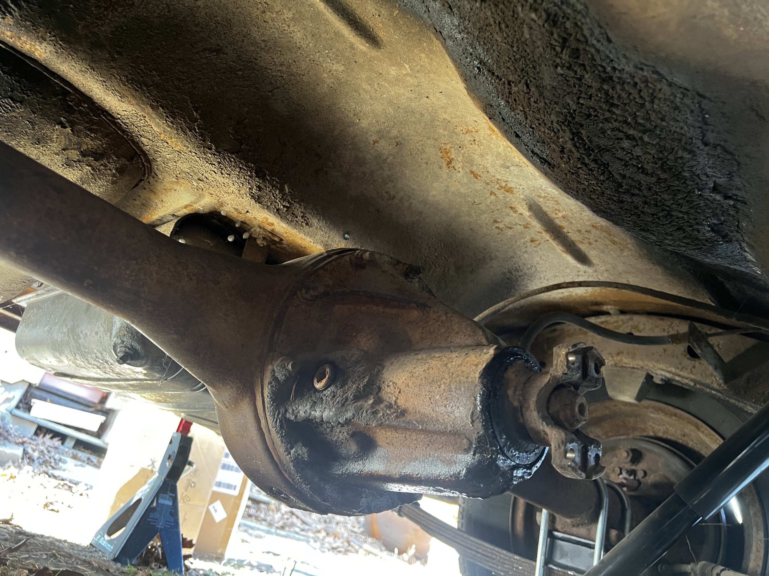

    Is this the stock 1949 Ford rear end? I thought that would’ve been a Dana 44, which has the bolted cover on the back. This looks like an 8 inch Ford rear end to me. Opinions? facts?
    Also, I have to loosen those U bolts to install my wedges. Turns out that’s quite a chore with a regular combination wrench.
    What do they call those hex head air ratchets that would slide up onto that nut?
    It would take an extra deep socket to get onto that thing.

    Stock rear - Ford used it '49-'56 - only wagons and t-birds got the Dana....
    seb fontana likes this.
  24. Leave an inch of threads and cut off the extra threaded length of the U-Bolts. Then you can use a standard deep socket.
    Rand Man and VI Lonewolf like this.

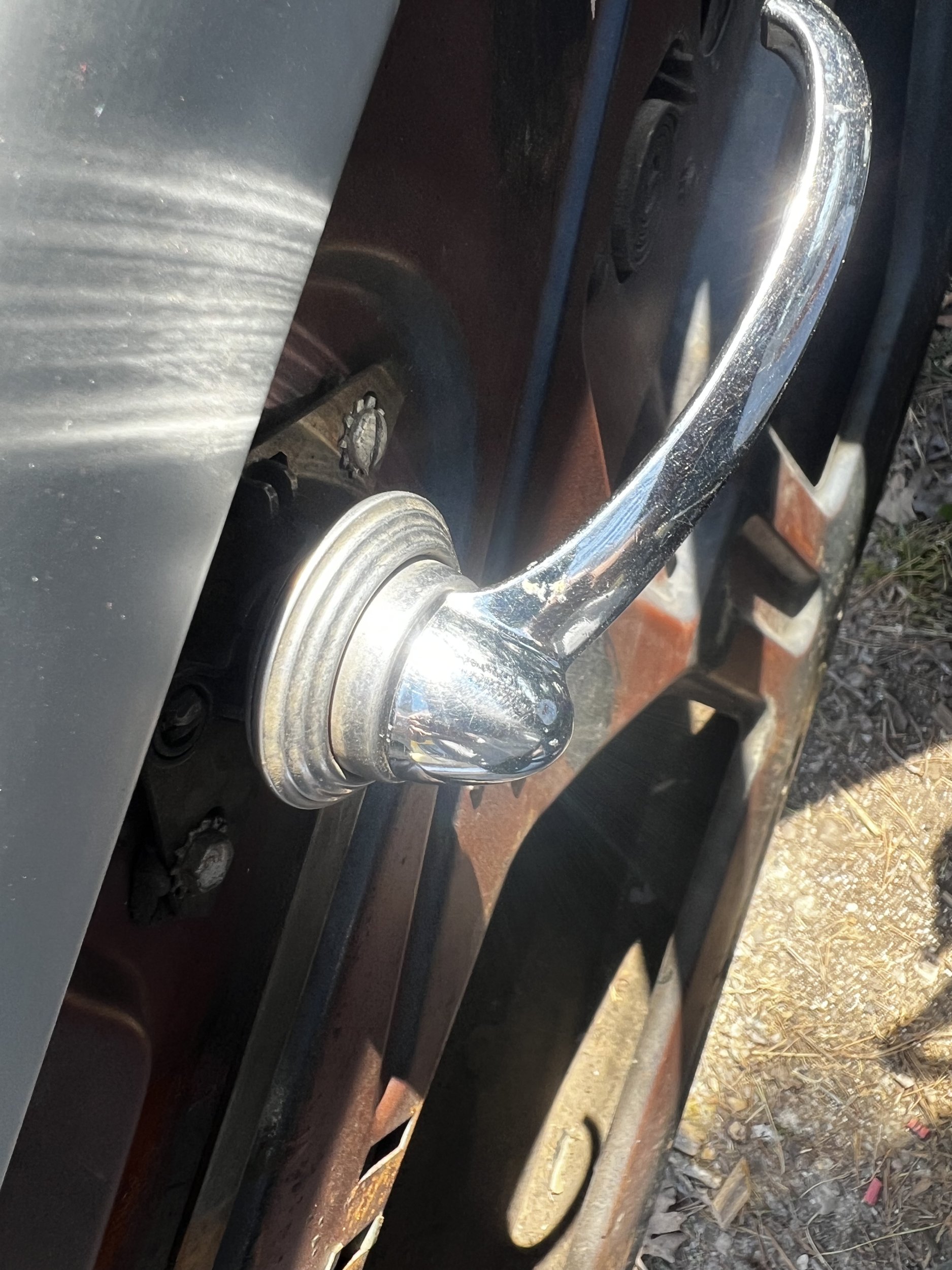

    Turns out I have 1950 and above round shaft with splines and a pin. How far up in years does FoMoCo use that style handle?
  27. Rand Man
    Joined: Aug 23, 2004
    Posts: 5,405
    Rand Man
    No, the interior door handles and cranks don’t have splines. They’re just square shafts. I don’t know what I was thinking, but IMG_1747.jpeg when you look inside the door handle it looks like it has some splines on it.

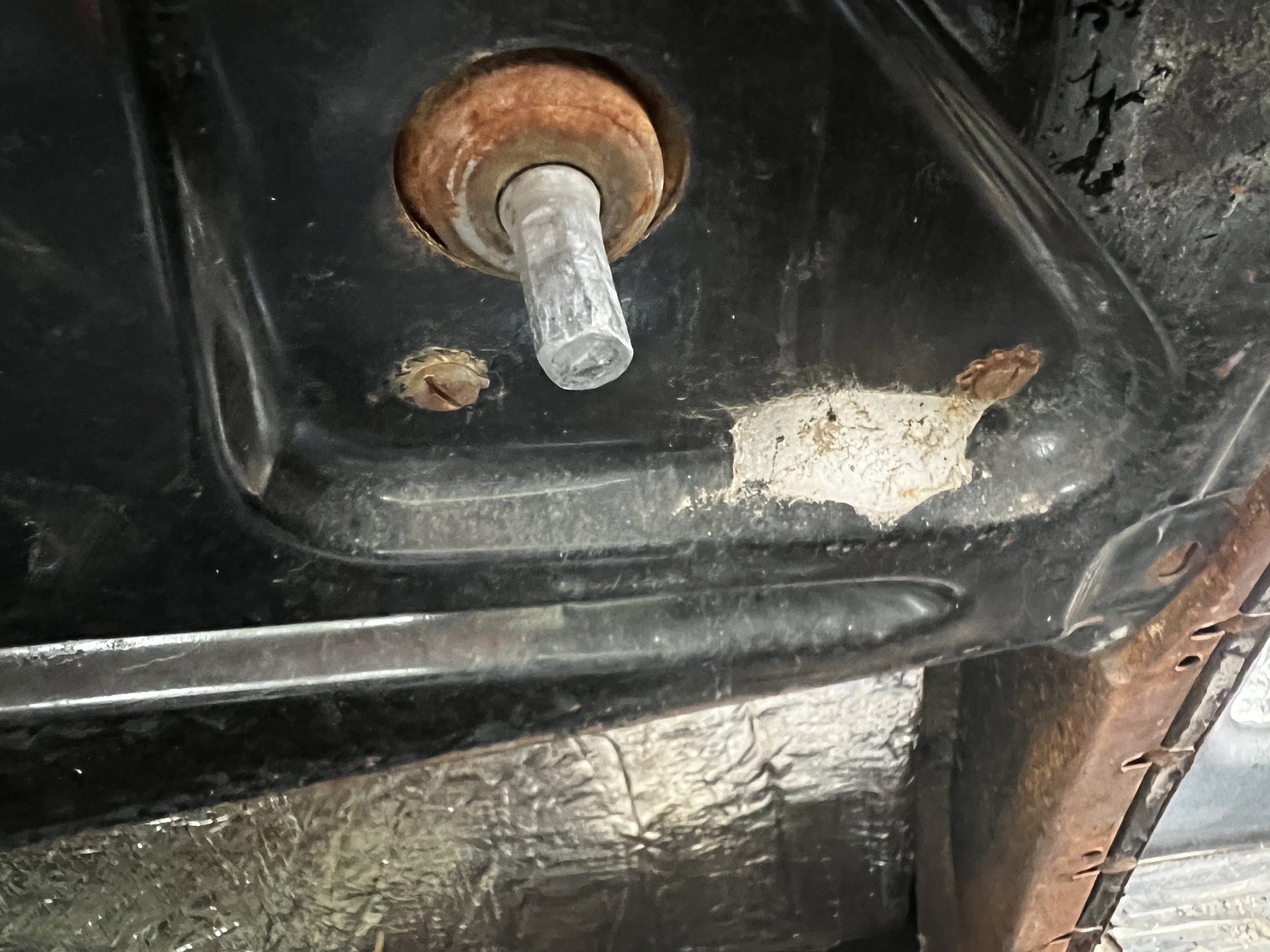

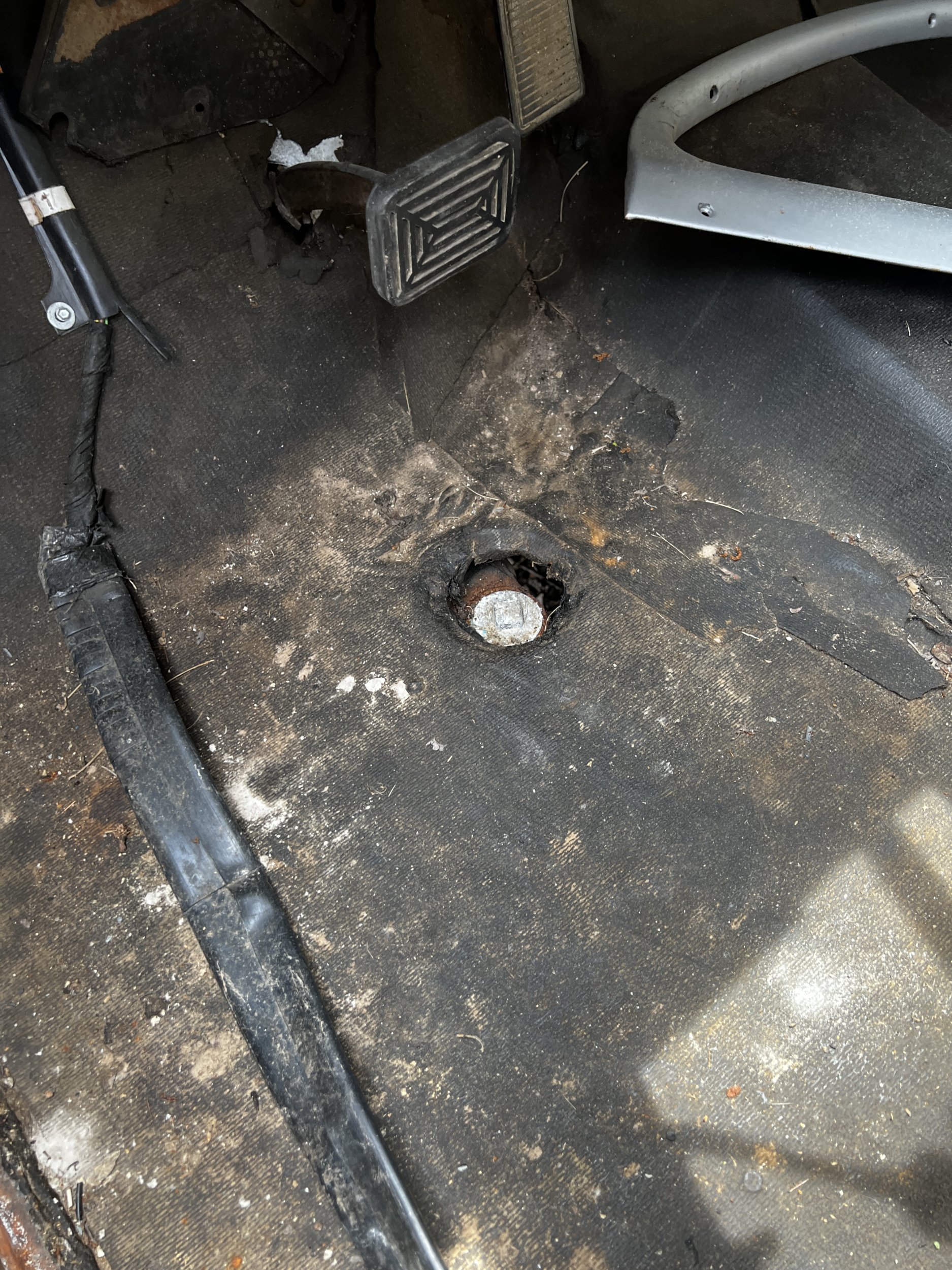

    I need to bleed the brakes because we had to unhook the brake lines to put in the new springs. Is there any trick to getting the top of this master cylinder off? Jjust an odd angle to get a 3/4 wrench down in there. IMG_1746.jpeg
  29. There are actual 4 AND 8 corner sockets for that job. Old gas stations actually had a T handle wrench for that job back in my younger days.
    dwollam and BigRRR like this.
