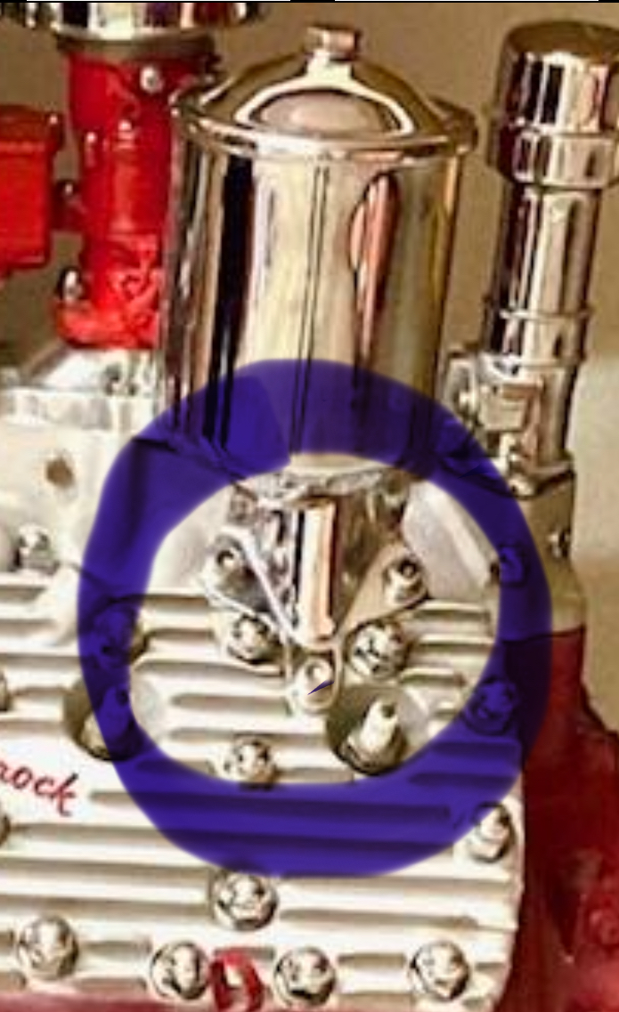

    Also, I’ve never seen the remote oil filter mounted like that before. Definitely not the “standard” hsg I’ve seen mounted using the head bolts.

    If you look closely, it appears to have a 4 BBL manifold with an adapter (bolted on backwards) for two 2 BBL's. I initially thought it looked OK, but the closer I look, I'm starting to wonder. I think the weird oil filter mounting is a piece that Offenhauser used to make to mount an late 8BA filter to the head bolts of engines that didn't have the special filter mounting bosses; see this thread https://www.jalopyjournal.com/forum/threads/un-identified-flat-head-accessory.1330802/#post-15508678.

    At least the 8RT truck engines had the oil filter mounted like this.
  16. alchemy
    Joined: Sep 27, 2002
    Posts: 23,005
    alchemy
    48 and older has the filter mounted to the studs. 49 and newer has bosses in between the studs like shown.

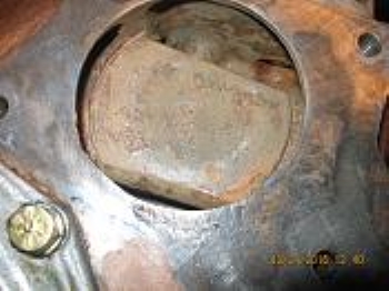

    I think I over paid for a can over sprayed wire wheeled door stop. 20250316_193934.jpg 20250316_194200.jpg 20250316_194444.jpg 20250316_194824.jpg 20250316_194831.jpg 20250316_194849.jpg

    At least I can't see any "Part number" cracks (at least on this side). Every block I've ever had without them turned out to be good. Looks like stock 3/8" reach spark plugs were used with aftermarket heads, which ain't good. Who was it you said built this?

    I don't see cracks either,I'm going to slap the head on again and do a compression test after work.
    The seller is supposed to be the daughter and her husband,really nice people.
    Randy was an avid racer even raced in boneville.
    I got antsy and took the head off before doing the compression check.
    I'm going to do a compression test then I'll open the other side and take a look.
    Maybe I'm just freaking out.
    I expected to find new pistons and new valves but everything looks ok,cylinder walls etc..
    I'll do a compression check and check the other side for cracks.
    I don't have time to make a stand to test run it but maybe after the car show in April.
    I measured the cyl stroke(?) And it looks like 4" so at least that's good.
    What should I do with the peeling silver paint? S****e and re paint the gasket?
    Or just bolt it down and run it?
    thanks in advance.

    You now know what you bought is a thrown together painted rebuild, NOT as advertised. I would NOT try and start it without a full tear down, to prevent any damage caused by improper internal ***embly, based on how the external ***embly has been done. But more importantly, what is the seller going to do to make things right?

    I’d clean up the head and block surface, check for flatness of both surfaces, throw some copper coat on them and retorque.

    I agree with @V8 Bob about a full tear down and find that his advice is usually spot on. Also, looking at the last picture, it looks to me that the block needs a good cleaning. Compare it to the picture below of my '51 Merc after I finished two good soaks with Evapo Rust solution followed by a couple of regular flushes. That was a good used engine that I didn't dis***emble. If you tears yours down, you have the advantage of a thorough mechanical cleaning first; also magnaflux and pressure testing.
    It does look like it has a merc crank, so that's a nice plus. From what I can see, the block looks real good, so it appears you are ahead of the game. I sold my next to last good 8BA bare block 6 years ago for $800, and the guy was very happy to get it after going through 6 that tested bad.

    After looking at the heads,it seems like they aren't usable...lots of porosity everywhere.
