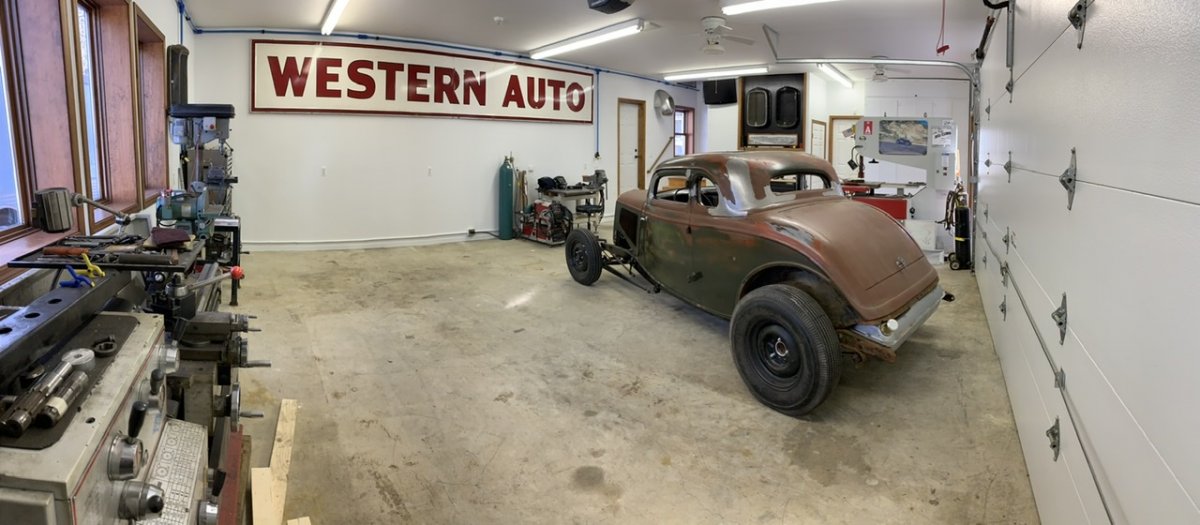

    RapidAir also offers a hard line kit. I liked the idea of the hard lines to prevent any sagging between drops.
    For a few bucks more, I got this 1” OD aluminum hardline kit, with 3 manifolds for the drops. The kit includes 90’ of tubing, and wall standoffs to mount the tubing.
    rod1 likes this.
