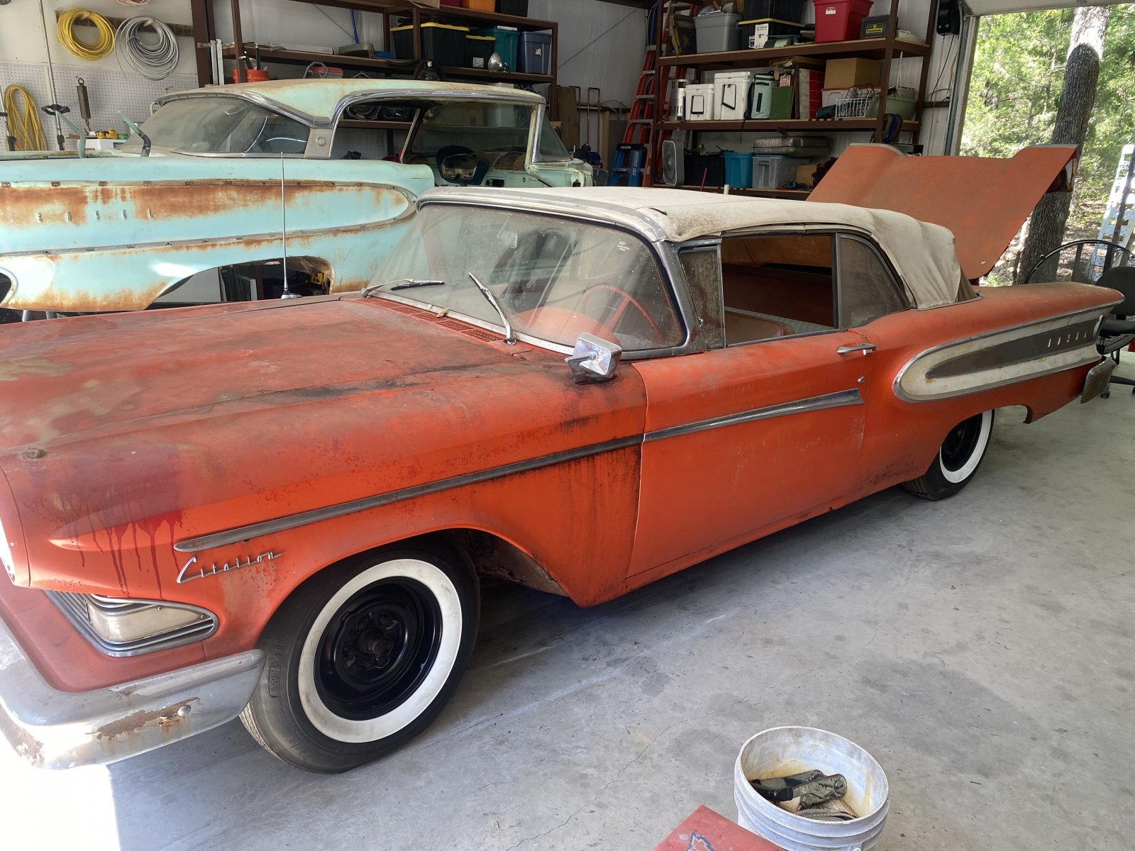

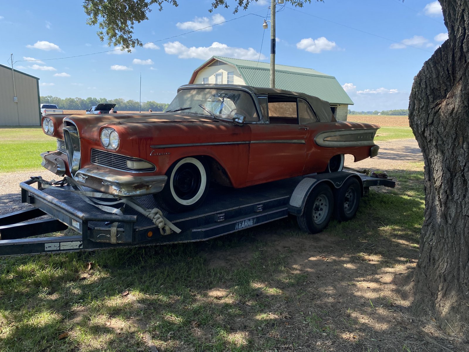

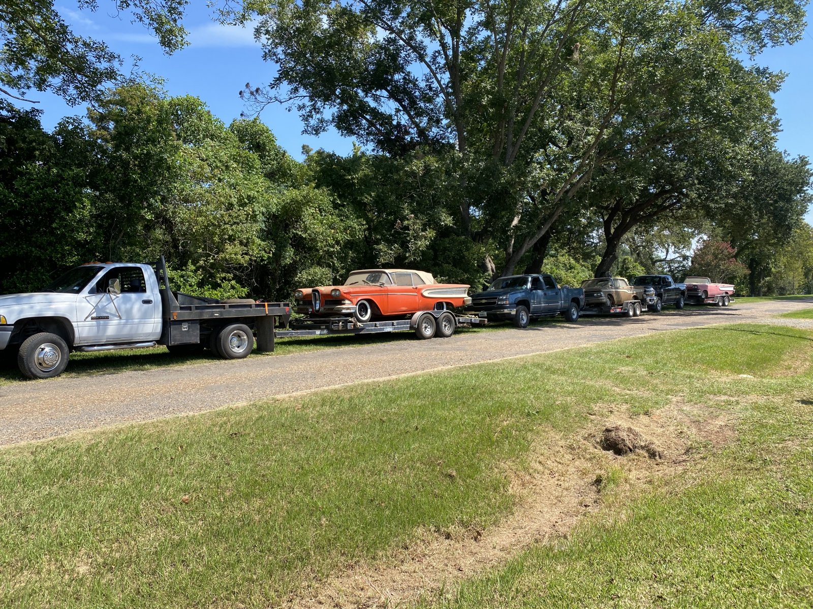

    Picked up 3 more edsels today. I really think I need help lol. Picked up a rare 58 citation convertible, 59 4 door Corsair, and a chop top 4 door pacer. Just couldn’t pass them up. They have been sitting since 94. 0E98CA7D-5678-4B3D-B1B9-42BB090E2D63.jpeg A37469C8-BF2A-4A1F-97A8-CB8D1A8189AB.jpeg

    Love it, quite a parade you had there. I'll bet a lot of gawkers!

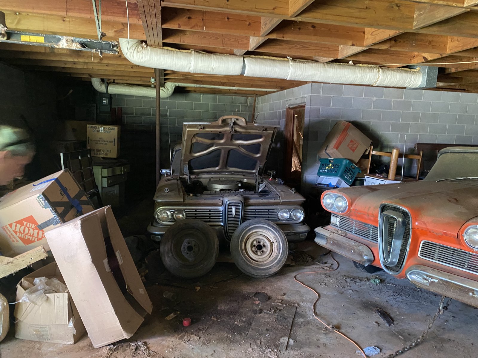

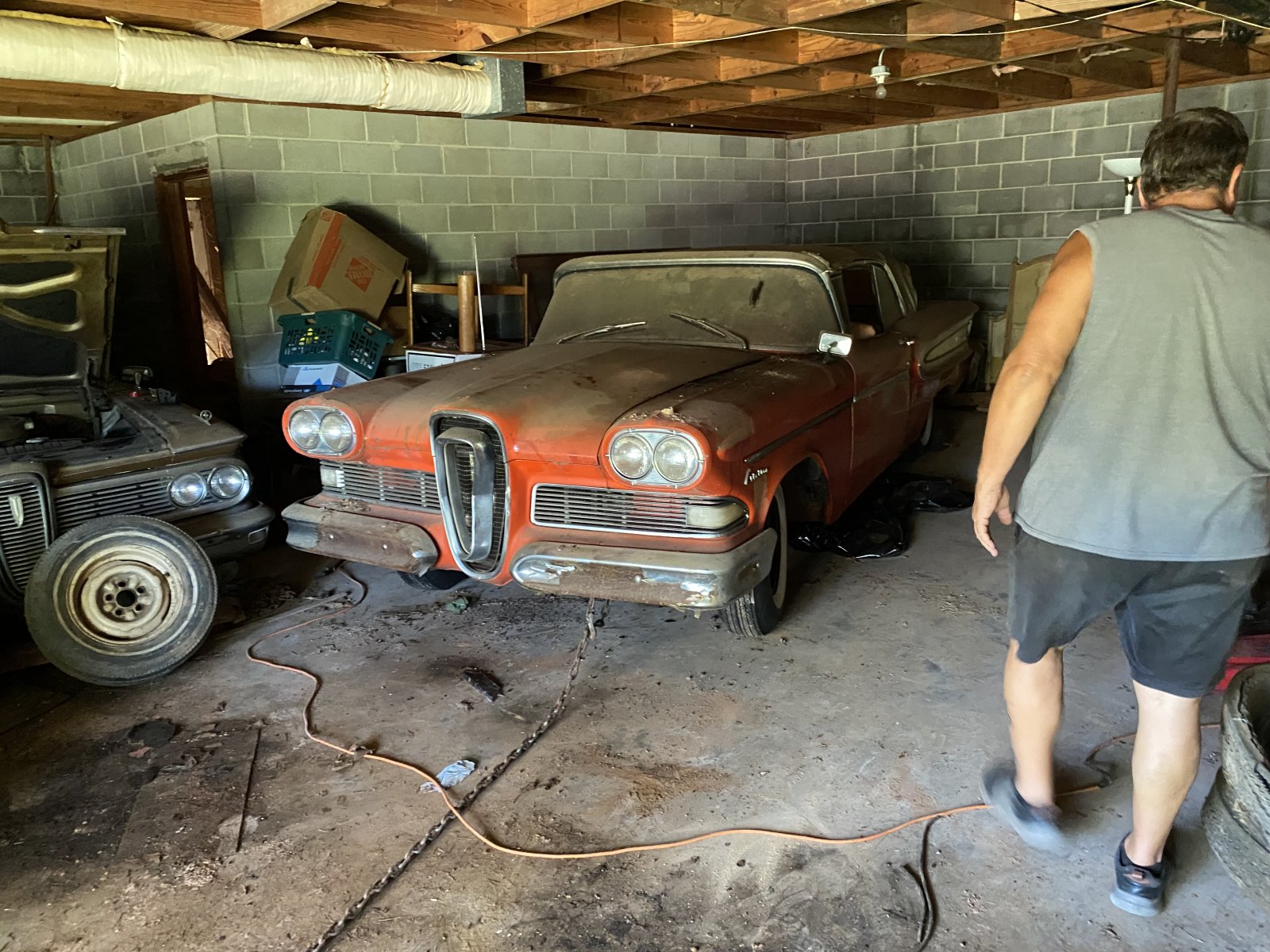

    backstory, met this fellow while buying his 59 wagon. These cars was his dads and he had passed. Last registration is 94 on a couple of them. After purchasing the wagon the son showed me the rest of the cars in a different building. Come to find out the dad bought the citation in some town middle of Louisiana in 1966. It was sitting in a field with the top down. Been garage kept ever since. Not sure on how he bought the rest of the cars. The 59 Corsair 4 door I think will clean up nice. Motor is free no spark (according to the previous owner) seems to be all original including the paint. Very little to no rust that I can find. The pink one in the rear of first photo, had a tree fall on it so the owner cut the top of. It actually drives and has the rare 3 speed manual with OD. It does have some rust in the floor and a pillar.

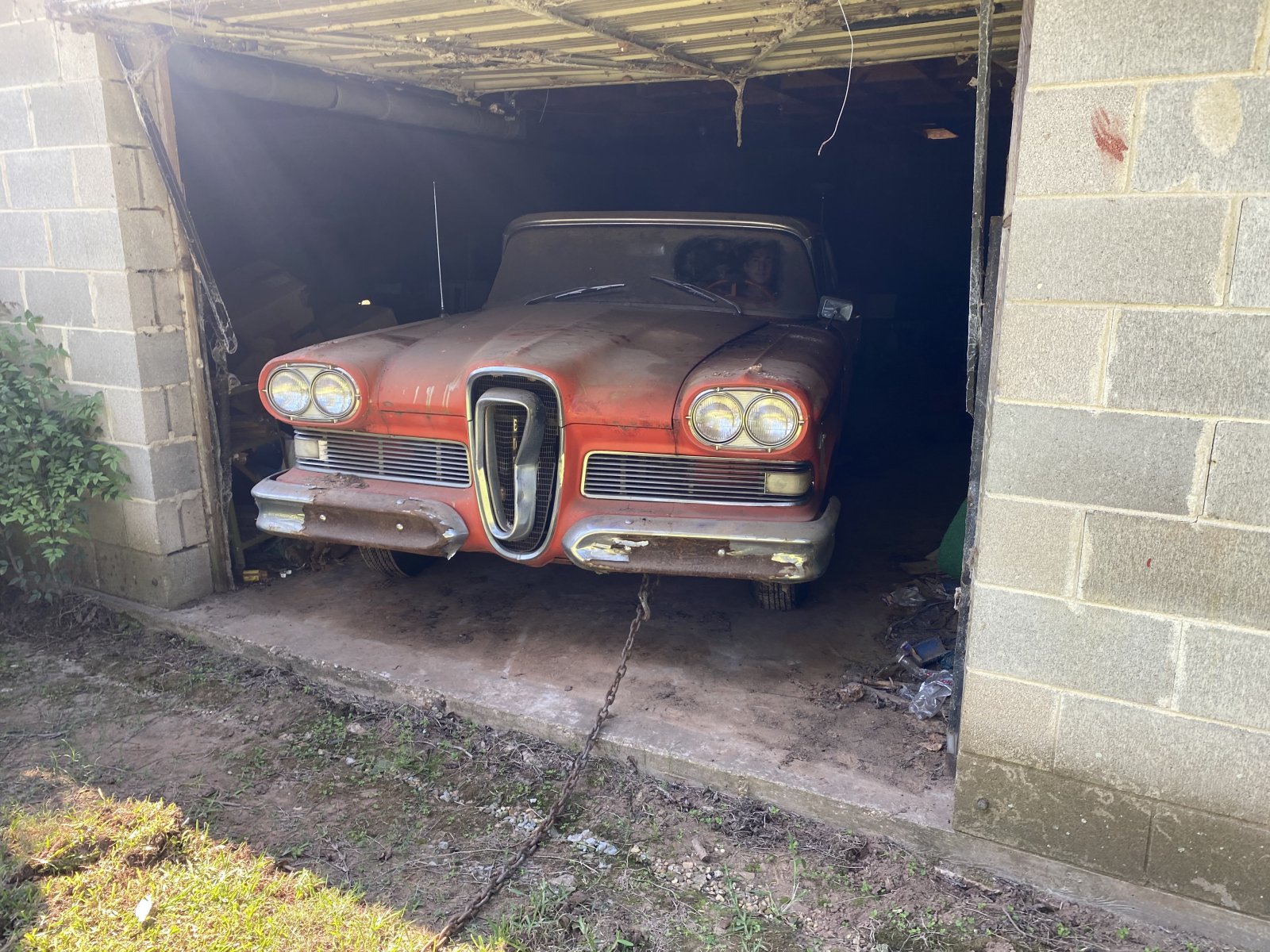

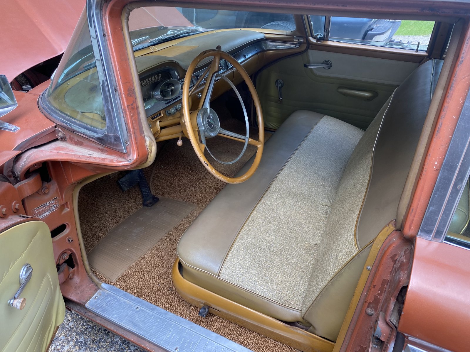

    First time to see light in 30 years

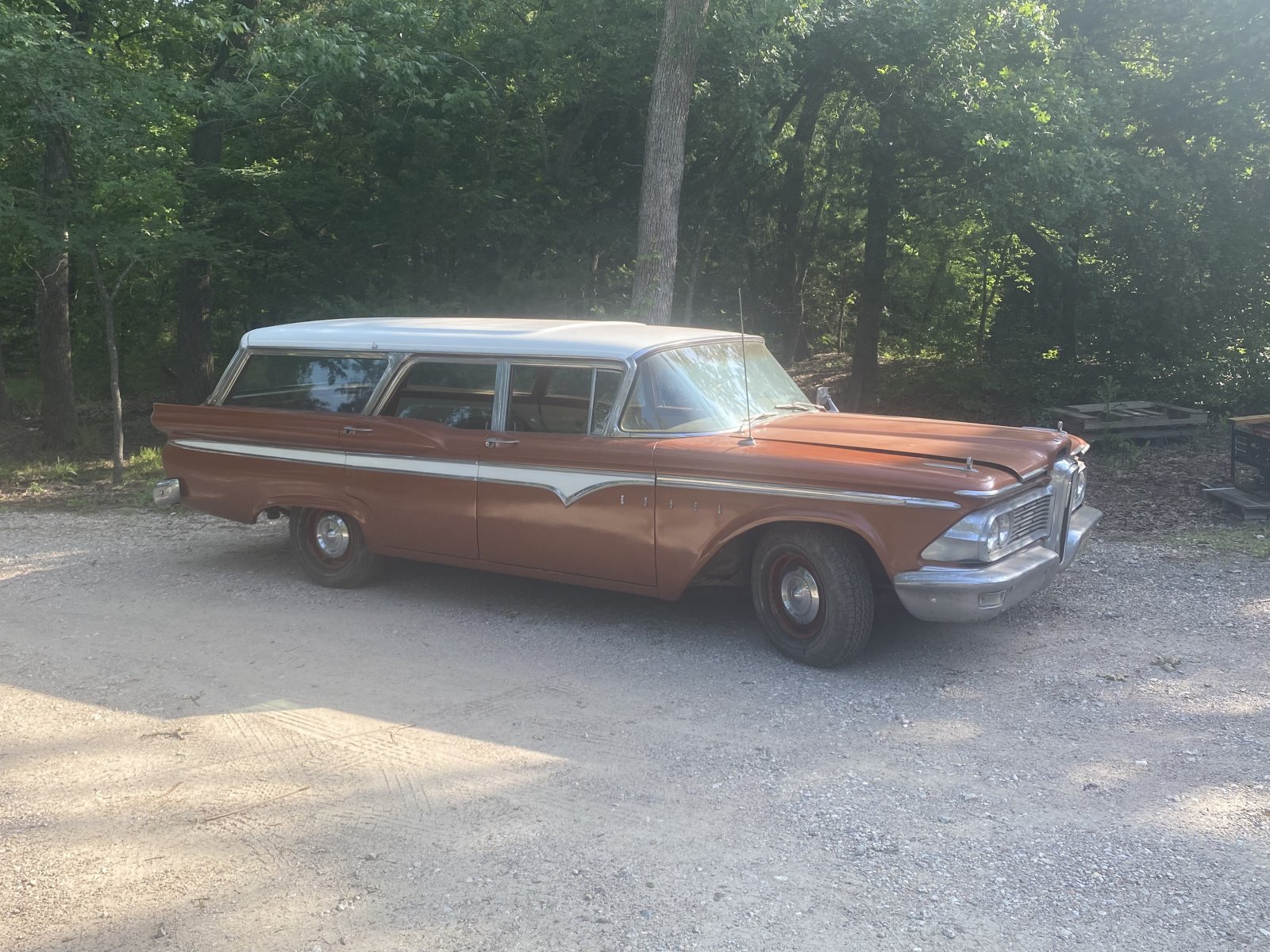

    Here is the first one I bought from him. 59 wagon. All original interior in great shape. Put new carpet in it. All new brake system, fuel system, cooling system cleaned, and ignition runs great. Getting new tires then it’s road worthy.

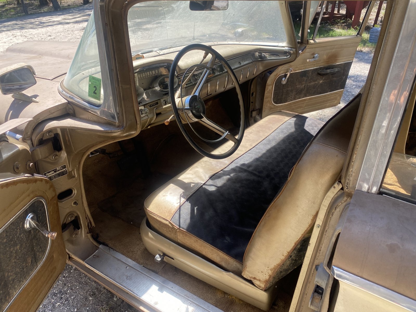

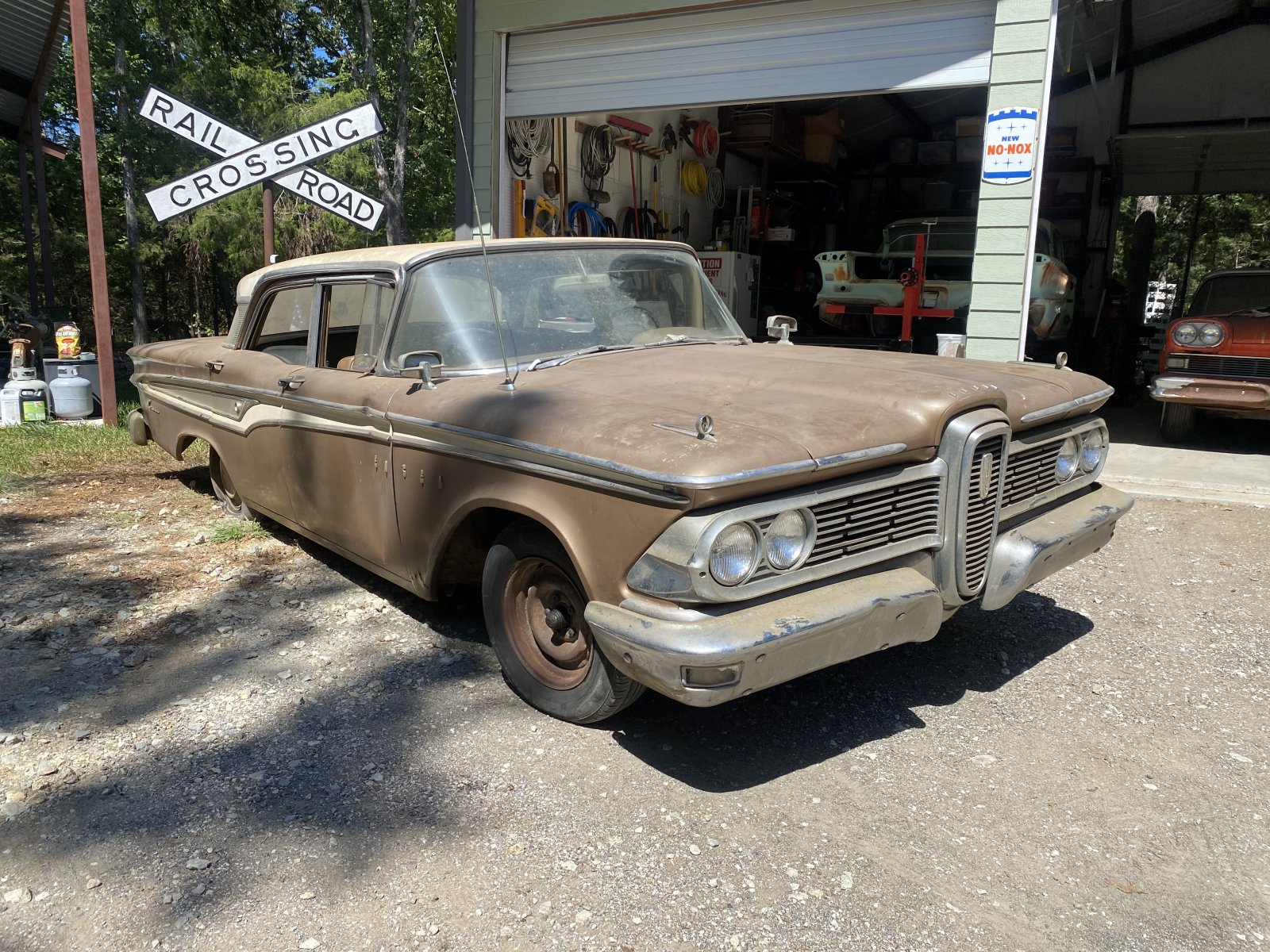

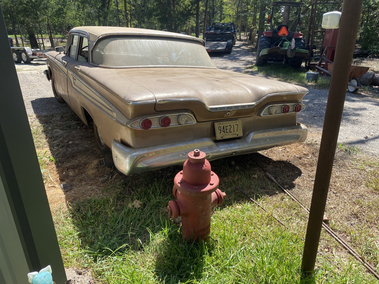

    Got the 59 unloaded. In pretty good shape minus one pole dent on the pass side front. 43BB43B0-39FB-4FBD-8237-17E423A70A80.jpeg 095D4717-3424-4357-94E1-1C745B3F0F92.jpeg E1855C7C-3209-4D7D-8207-991EE08CA6B9.jpeg

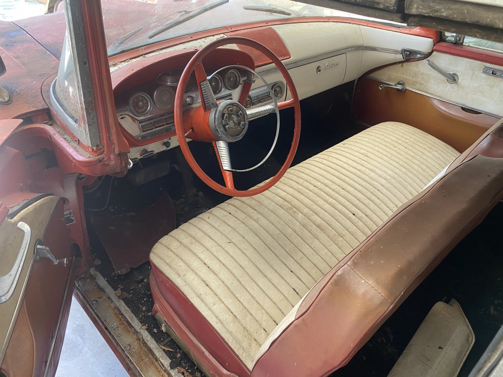

    I have a couple of suggestions from my experience when my clients obtain or get their cars from deep storage invest in Armor All or a quality like product Ilike Chemical Guys products for rejuvenating dry upholstery stitching before you sit in it I'm sure you hear the crunching when sitting in the seats that is the stitching thread dryed out and breaking and same goes with headliner it though is real hard to work with so I suggest when at speed you roll windows up for now when you feel the wind coming through you start compromising the stitching in headliner also but everytime I spray a headliner it comes undone anyway but the door rubber seals need some liquid life I use silicone in a tube a non-alcohol or acetone product . Straight silicone in a tube no not the glues just Silicone .If not to be found I would use the Chemical Guys Rubber rejuvenating and Armor All second though I think the Armor All has acid type chemicals in it and most rejuvenation products do but basically some rejuvenation is better than none . Upholstery is alot of bucks to replace so if you can give it some life it will last alot longer

    Murphys oil soap is great for old dried out upholstery, cleans and gets some oils back into it, very gentle.

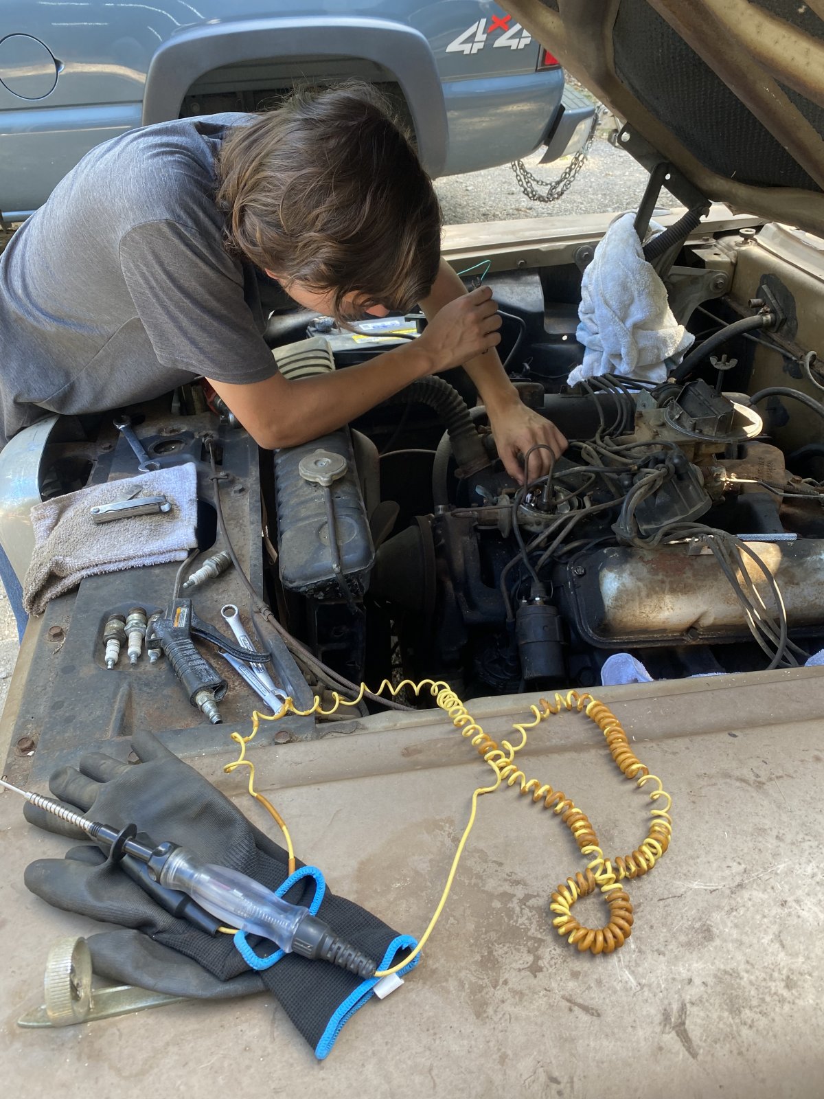

    A0862E44-322E-4598-B3F7-8A484FDEC54F.jpeg Flathead you are more than welcome to come by and any time. I’m actually east of Dallas by 45 minutes. And I’m a pretty Anal guy when it comes to these cars. We try and not to sit in the seat if we don’t have to until it gets 2-3 rounds of the chemical guys vinyl treatment.
    we did try and start the 59 today. (Before you give me a hard time, past owner had already and turned the motor over last week) we pulled the plugs and soaked the cylinders. Also pulled valve covers and soaked valve train. My son changed his first set of points. And got to set the gap. It tried to fire and did but the throttle blades are stuck closed and will not open. Got the carb off and soaking in diesel for a couple days while I’m at work. Heat and PB didn’t free up the blades.
    I’ve never had a carb that the shaft has gotten frozen up in the carb.

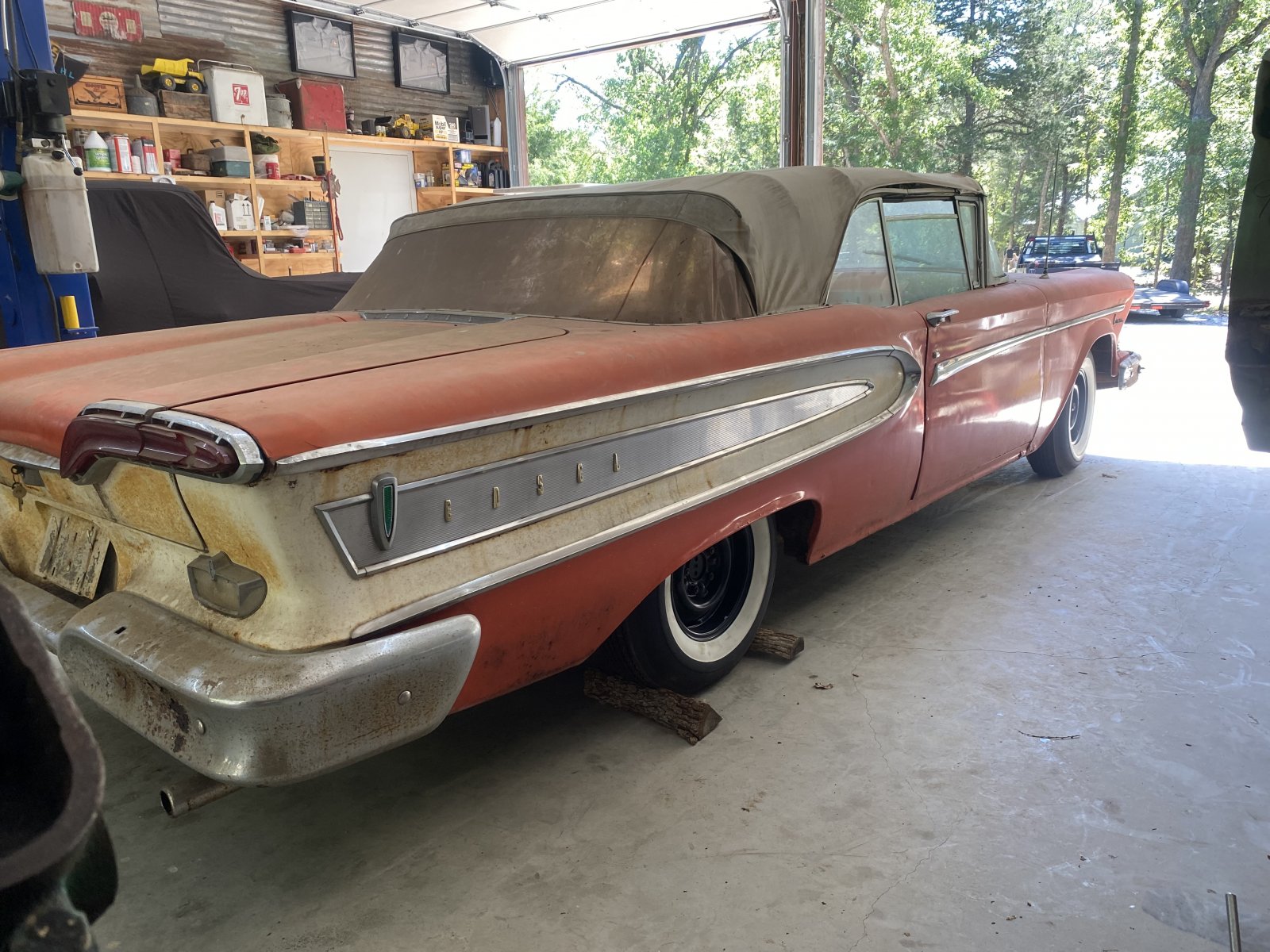

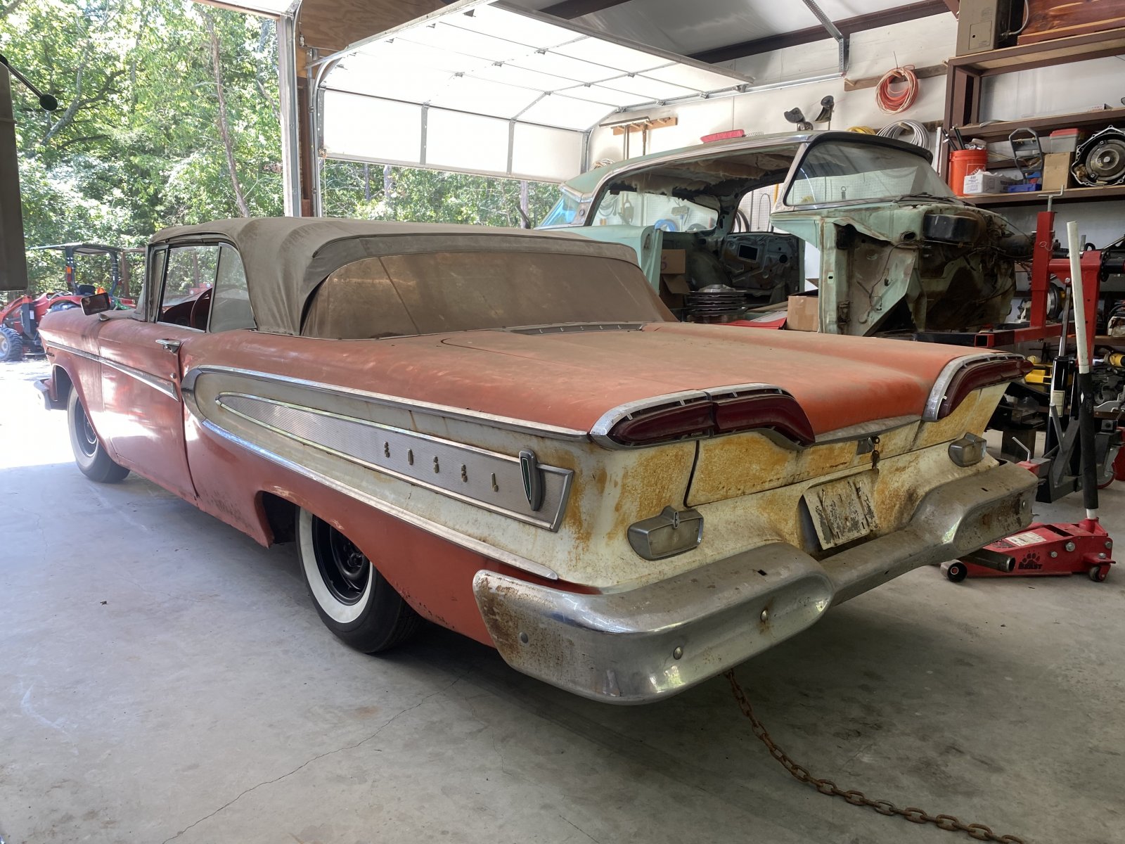

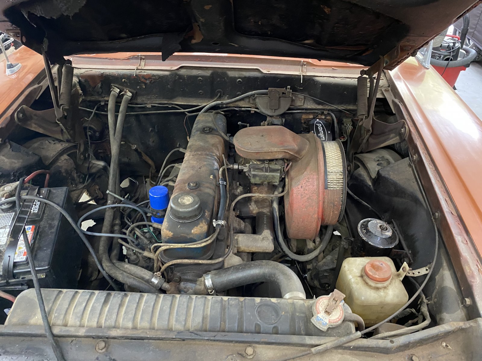

    Soooooooo, got the citation in the shop. Previous owner hooked a battery to it and tried to start it and just heard a click. Motor probably has 3-5 k miles on it but been sitting since 94. We pulled plugs and used a full can of PB in the cylinders. Also pulled valve covers and soaked again. We’ll let it soak for a couple days then try to turn the motor over with a wrench.

    AND before you ask the green one on the rotisserie is my sons. We’ve been waiting for an engine for 6 months. Correct MEL pistons take 7-9 months to make from wiesco. It’s an original 58 Corsair 2 door hard top. Frame and all other components are done. Just waiting on engine and trans so we can put the body back on.

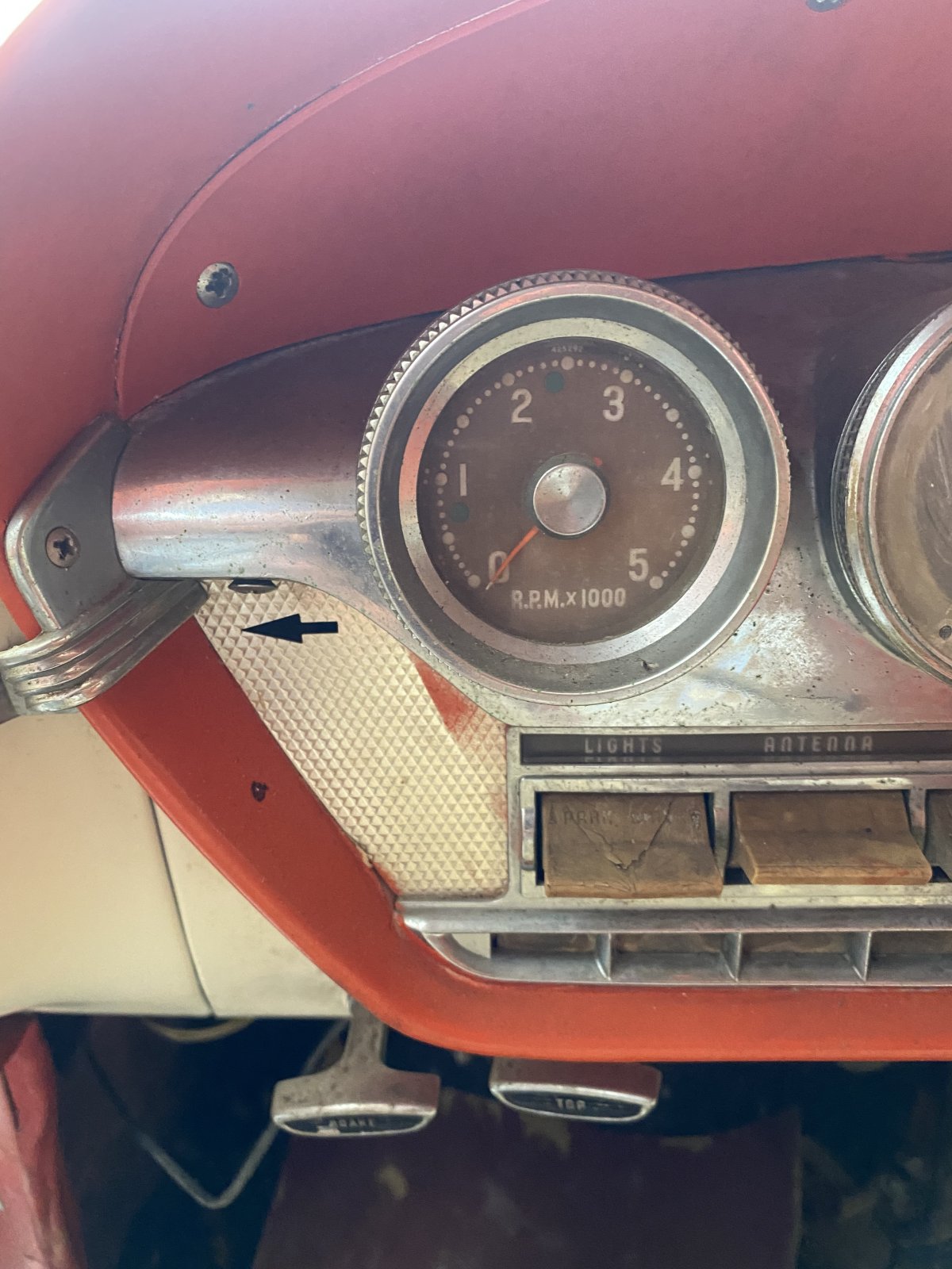

    The '59 looks like it'll clean up nice, and the '58 convertible is a real treasure, with factory tach even! Is that a custom rear window on the convertible top, or did they all have a wraparound like that? Never saw one like it before. I could see how it'd be useful.
    Shame they hacked the roof off of the 4 door '58 but if that one could be combined with the convertible to make a nicer convertible it wouldn't be a shame to me. A stick convertible would be pretty cool, although the Teletouch in '58 is also a neat piece.
