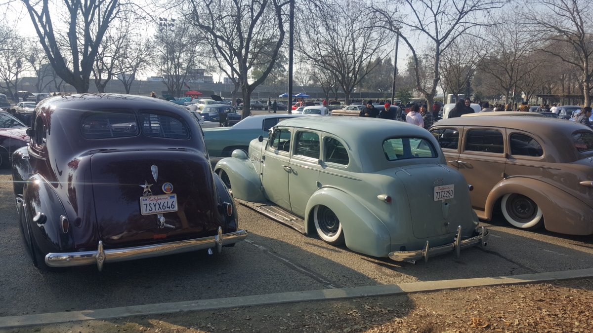

    The slight difference in tire height from my calculation would add only a few rpm, and that's not a bad thing.
