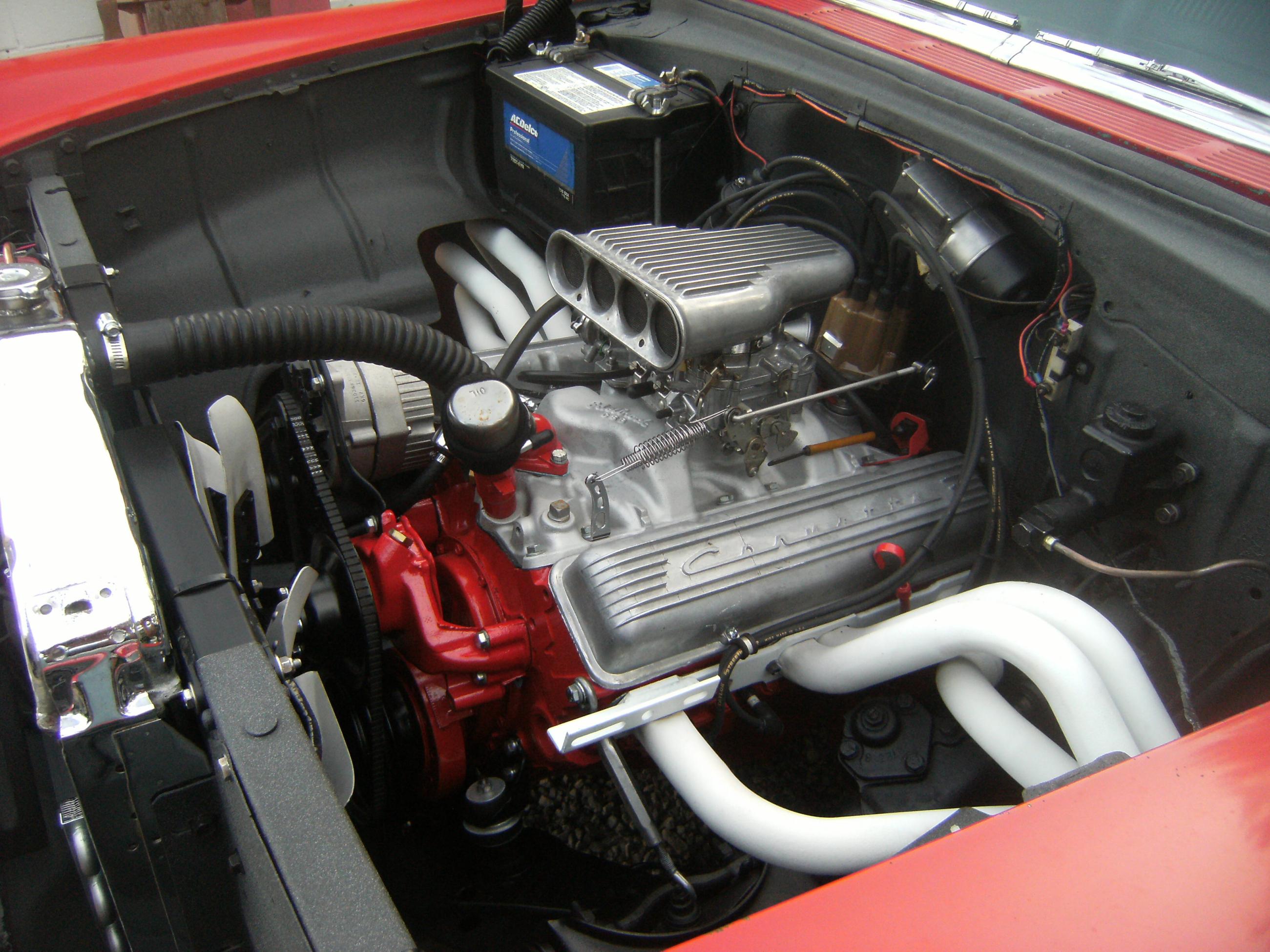

    paul55
    from michigan
    all spray bomb. Used rustolium textured multi-color on eng. bay called aged iron. Looks similar to trunk splatter paint, but finer speckles, and no need to clear. Used textured black on battery box, hood hinges, etc. Semi gloss on pulleys, frame, etc. Barbeque white on headers, cheaper than VHT and works better. All paint from Home Depot, except chevy orange. Has a period look to it I think.

    Paul...I really like your engine bay! What kind of alternator bracket is that? It looks like one of the ones I used but trimmed down.
  26. paul55
    Joined: Dec 1, 2010
    Posts: 3,491
    paul55
    from michigan
    thanks! brkt is 69 camaro, a little trimming. Paul
