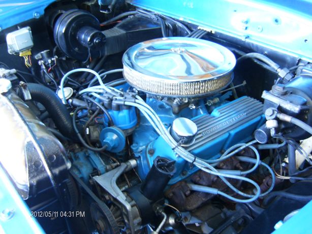

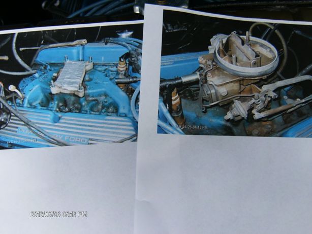

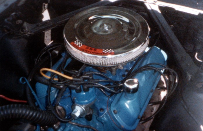

    I had to have the carb rebuilt and this is what I saw. I just did a little clean up brushed the intake with Ford blue and touched up some brackets, anything had to be better than it was.
    The 55 Chevy is a nice looking car.

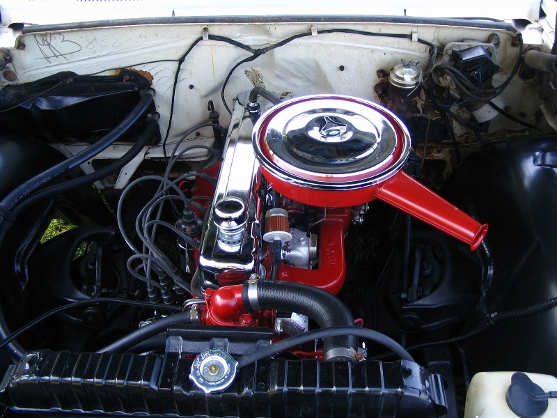

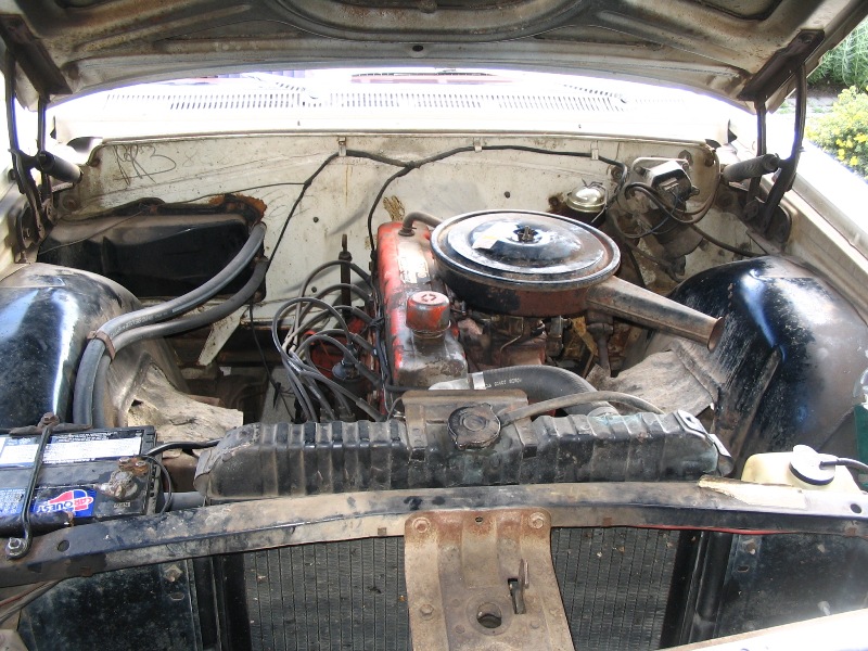

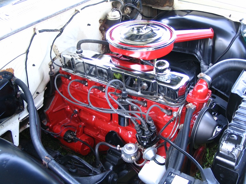

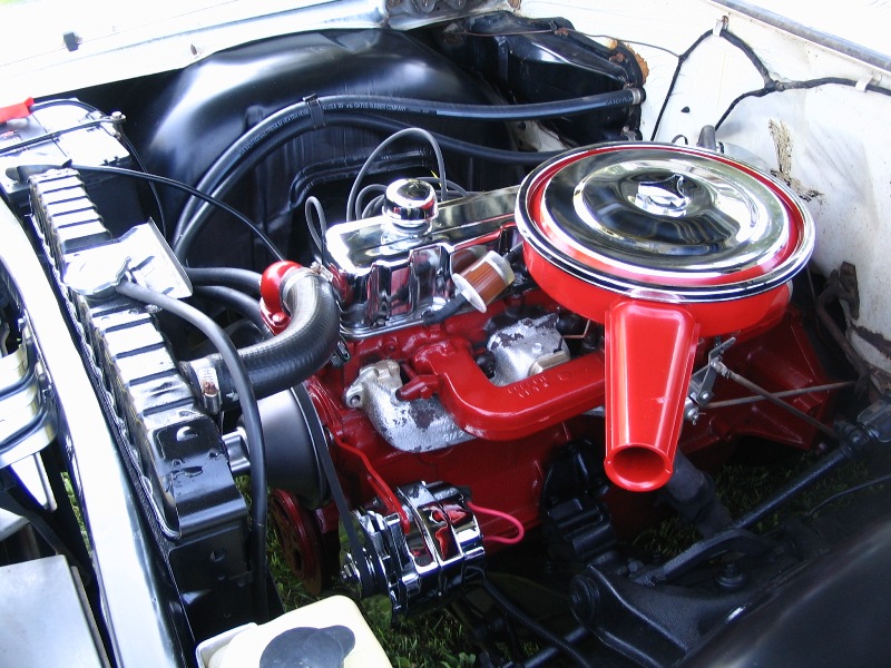

    Rustoleum can't be beat at $5 a can and requires minimum prep to look good. Co**** scotchbright pads is all you'll need - just prime the bare metal. Safety Red will match the firewall to the body pretty close. Apple Red on the SBC - it holds up well to heat, no need for engine paint. Metallic Gold will look good on the booster.Semi-gloss black on the fenderwells and misc brackets, flat-black the altenator. Do your Pop's a favor and replace the fruit-jar master with a dual unit.
    Take your time not to rush - his smile will be worth the results!
    Good Luck, Tim

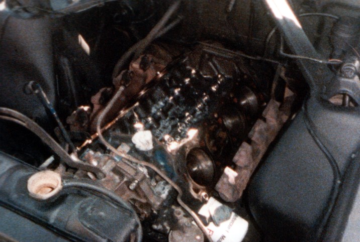

    Take your time and the end results will be worth it. I did this in a day and that included putting the engine back together.
