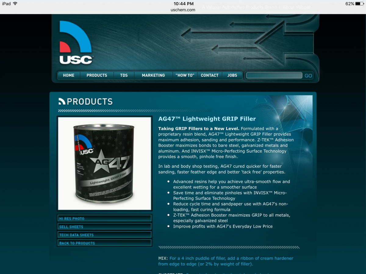

  20. You're going to fill low spots with rattle can lacquer primer????
    Get yourself a gallon of this AG 47
    - It's 18 to $25.00 a gallon depending on where you get it. Very nice to work with, sands super easy and no pin holes. I think it should be 2.5 times as much money compared to the other stuff out there. If your time is worth anything and you want a decent job of it use something decent.

  22. Notice I was specific in brand and product. That's because that stuff is the bomb and you dont need spot putty, you dont get those lows and it sands almost like icing but you can get decent fill with it. Finish sand that filler with 400 if you want to. You can just about Block it like primer. Icing is $30 a quart and you can't really fill much with icing. That stuff is $25 a gallon. Rattle can primer is 10 a can. All you need to do is get it on without spreader gouges.
