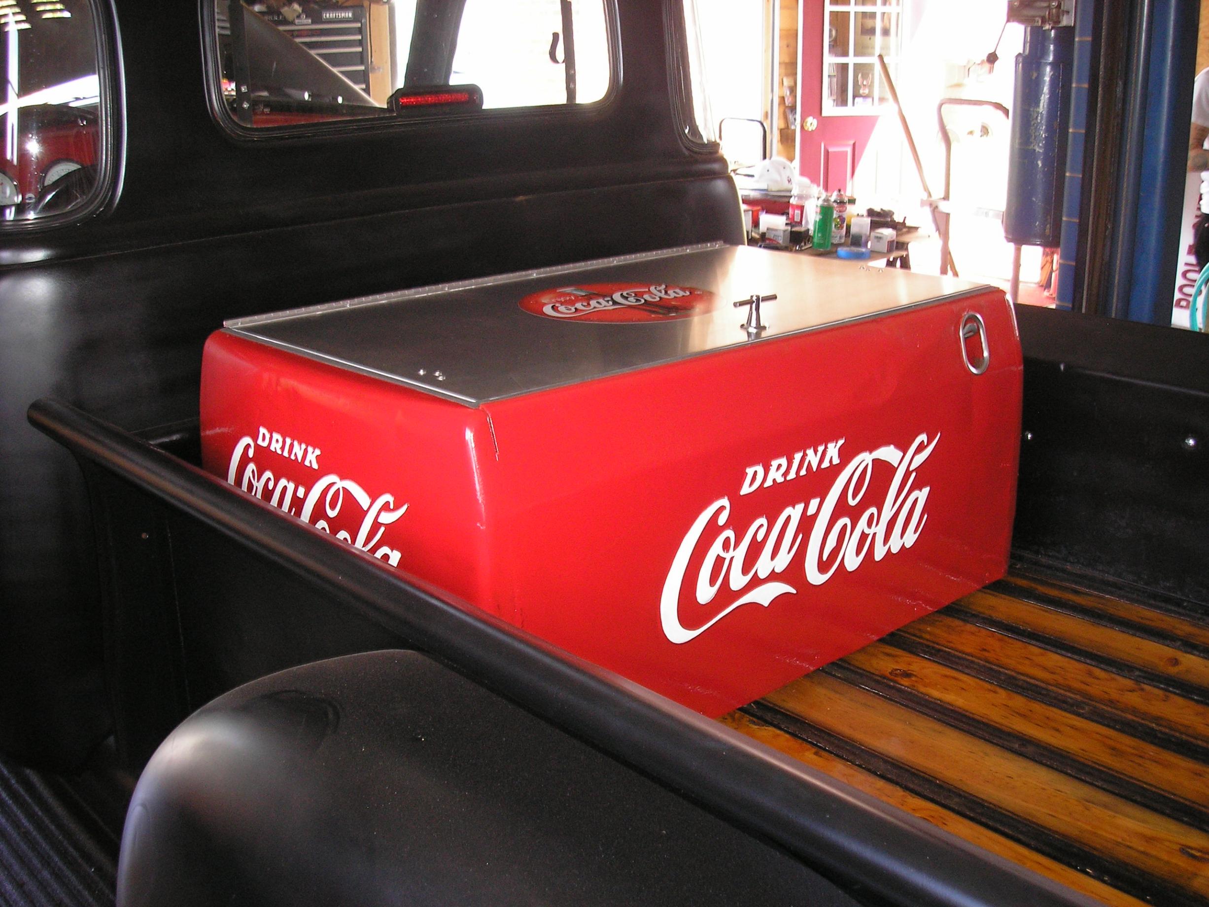

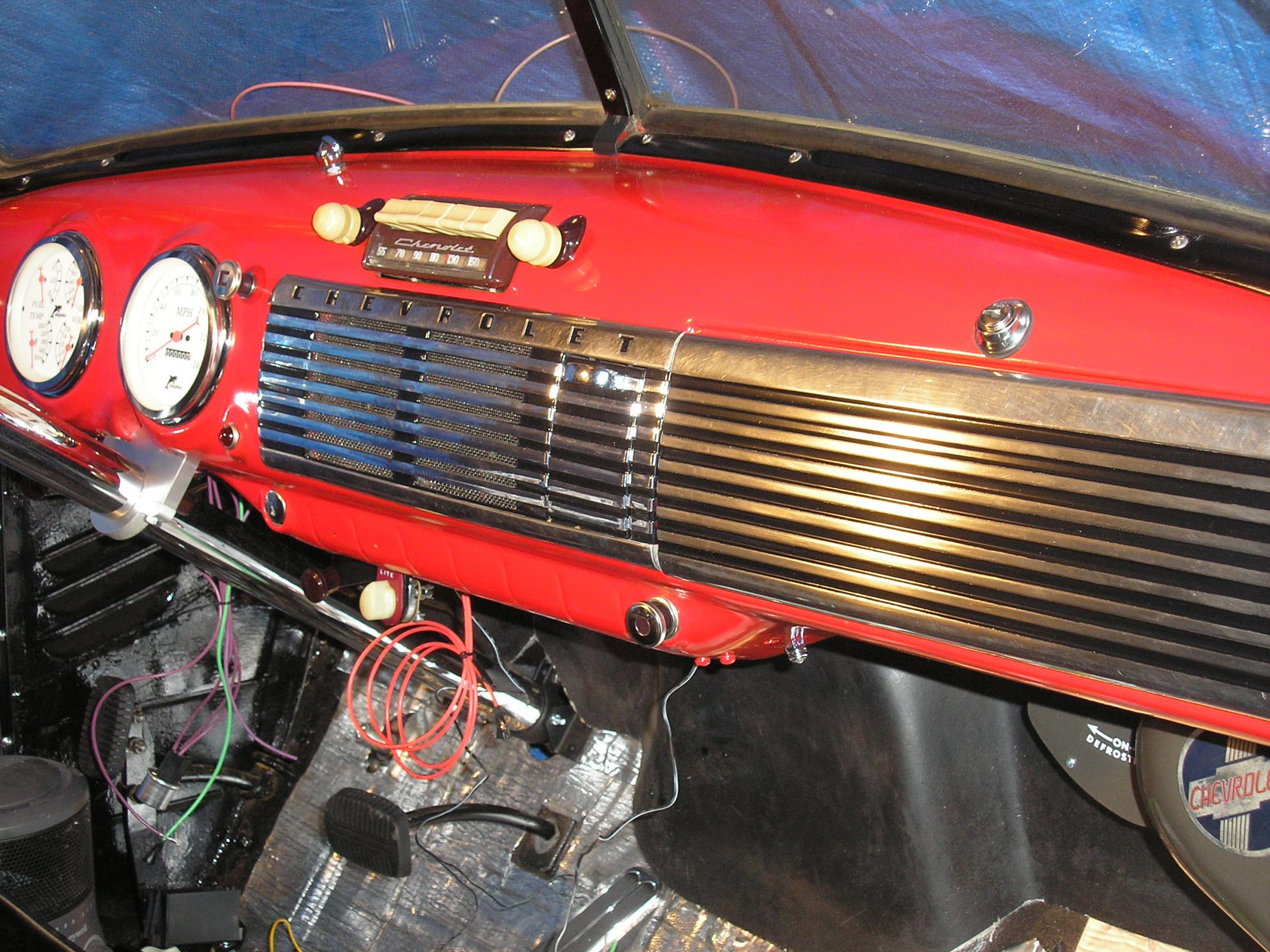

    Thought I would chime in.......... My truck frame, kickpanels fender wells, motor, headers and intake are brush painted w/POR15 (blk,red,alum) and the dash is rattle Duplacolor red and the rest of the inside is gloss black
    The wheels are Rustoleum Red Gloss and the outside of my truck is Valspar satin black.
    Harbor frt. supplied the orb. sander and paper and Lowes the paint except for the Duplacolor it came from Advance Auto.
    I'm like fleetside66, I just want to have fun and drive, not worry bout scratchin the paint.:D
    even my COKE trunk is hand painted w/New Holland tractor paint.

    I'd love to have a Coke machine like that as a trunk in my '55 Chevy truck. What is the right name for that type/shape machine? I'd like to search eBay or Craigslist for one.

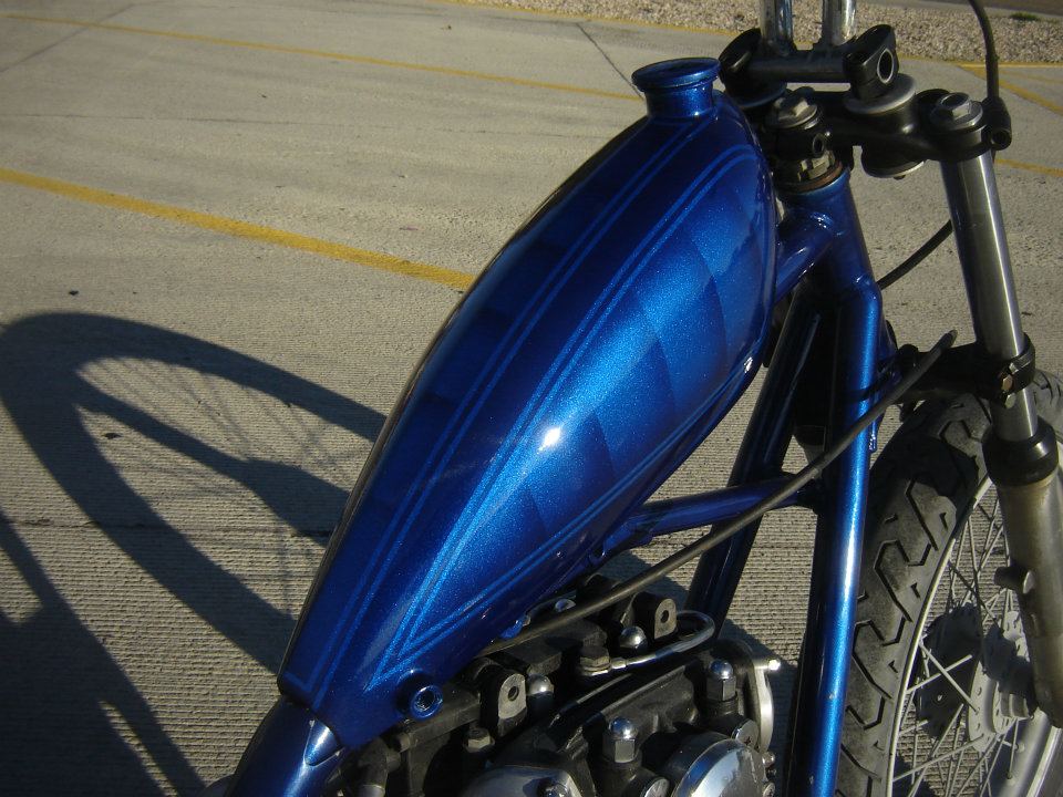

    Duplicolor and Rustoleum spraypaint on my old bike.
    Duplicolor sandable primer
    Duplicolor Metalspecks silver
    Rustoleum Metallic blue
    Duplicolor Anodized blue
    Duplicolor clear
    This is shortly after painting. I polished it later. I could have done it with automotive paint, but I wanted to see what could be done with rattle cans. I've also done other lace, fade, candies and flake just for fun since this. Looking at them you would never know! The wheels are gloss black Rustoleum and the silver pieces-not the aluminum, but the chainstays and washers on riser bushings-are Krylon Brushed Nickel. Also the motor is Rustoleum Textured black
