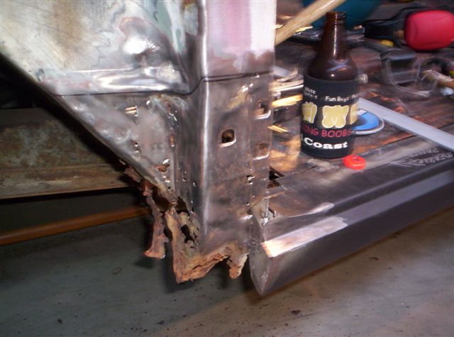

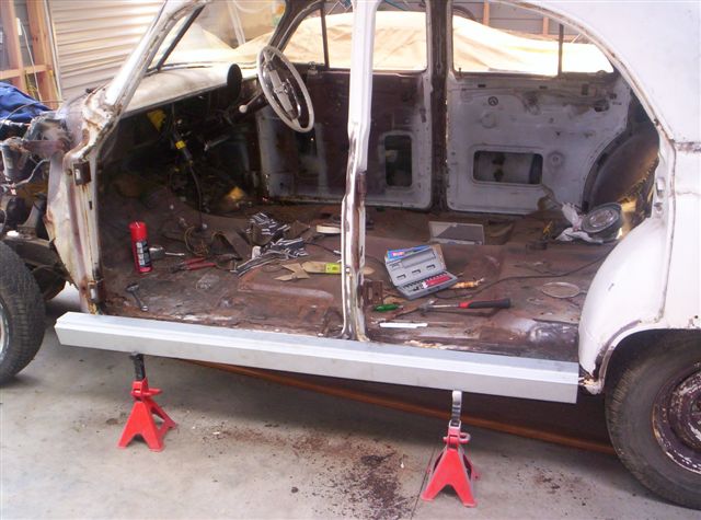

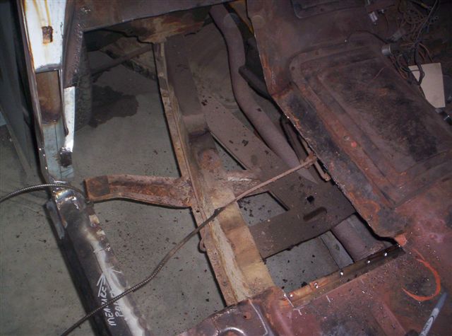

    Hoping to build my skills up and get better as I go. Have learnt heaps from this site and I hope the old timers (hehe) on here are happy to keep sharing the knowledge.
    Just a few short pics........

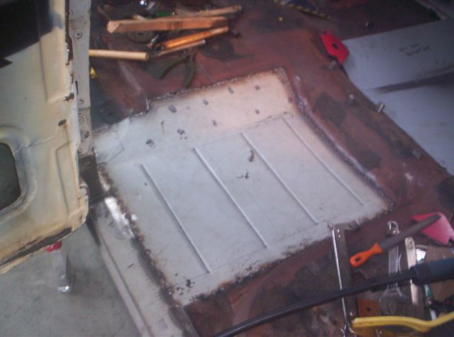

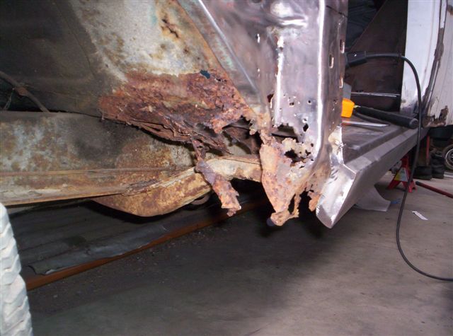

    Way outta my league too. Some floors I did in a 55 chevy.

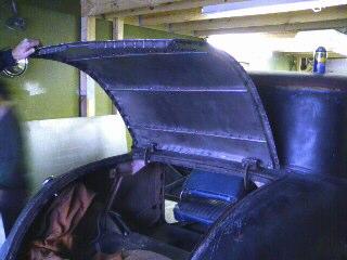

    Deck lid I made for a Plymouth.

    Yes, More info on the deck lid please. did you shrink the upper and lower part of the panel?

    The car at least had the hinges on it so I started there. I used some 1 " angle for the outside of the frame and 1/2 " square tubing for the cross bars. I made cuts all the way down the angle to get the curve and then tacked them into place once I got the right shape. The cross bars I bent over a tire to get the curve. The sheet metal pretty much just needed a little tacking here and there to get the curve. I cut the skin just at the bottom in the middle to make it fit. Kinda like chopping a top. The last pic is after everyone in the shop and cutomers touched every inch of it , and the rear lower panel I made as well. This was the first decklid I made, I learned alot doing it.

    Looks like it fits good. I'm going to try and tackle one for my sport coupe. I've made a smaller panel for the back of my sedan. I rolled it on my wheel with just a flat wheel to give it a little curve both ways. Seemed to work well. Thought about making the deck lid in two pieces. Not sure yet.

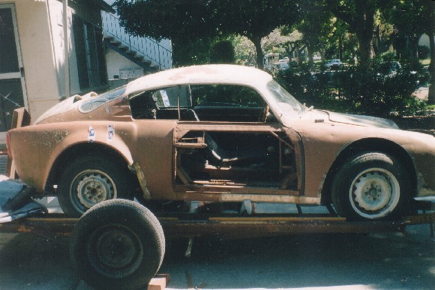

    I've been working on a late '50s Abarth Zagato.
