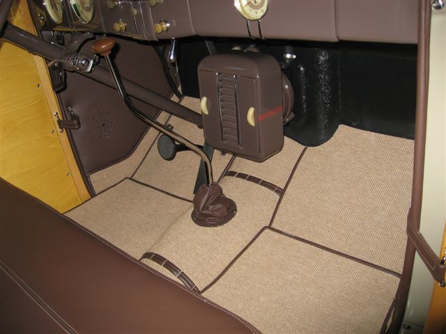

    Hello everyone.
    I'm just wondering if the below heater is a stock Ford heater or if it is an aftermarket item. I checked quickly the last time i seen the car and I did not see any names or logos on the piece. It will most likely need some parts to get it back operational again and I'm wondering where I would find them. A quick look online turned up a wide variety of styles, some mentioning them as a Ford accessory and some mentioning that they were aftermarket so I thought I would turn here.
    Thank you,
    Thomas

    looks like Ford to me. might not be the correct one for a 40 though.

    Damn near...that's a '41 Ford heater!

    I think so...do some searching on Ford Barn V8. You also need a switch that is different from any of the '41-48, and you need to figgerout differences from '39 (the first hot water heater from Ford), which is similar. I think you may also locate drilling templates there.
    The '41 is identified by the little pull-out knob for defroster butterflies, which was replaced by a cable up to switch plate after 1941.

    I may leave this one in the car. It's installed and works, and has been in there since at least 1957. I may try to locate a 1940 one, but won't empty my pocket book to do so. Thanks for the information.

    I believe that the 39 heater had louver grill between the two doors because of the floor shift.

  10. The colors on it make me think it is a stewart warner one ?

    Don't know who manufactured the '41 filter in the car, but it is a proper Ford accessory one from 1941. The basic design (with mods as noted) was used '41-48 and came in various colors and stripings to match standard and deluxe cars and different years.
    Fan is between core and defroster manifold, reversible with 2 speeds in each direction.
    I rebuilt one for my '48 and nearly went mad figuring out the wiring for that!

    I thought to only difference between 39 & 40 was the door pull color. They can me ran with the 41+ switches, I think they are better than the 39s

    As mentioned above, the heater shown is a 41-48 Ford dealer installed accessory item which was very common in the day. Here is the correct heater for a 39/40 Ford. They both work good.

    I was able to track down a 39-40 heater complete and at a reasonable price. I like the style of the 39-40 much better. May donate this heater to my Father's Model A build. Thank you everyone for your help.
