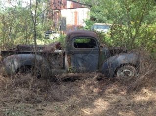

    This were taken when Oct 2012 when it was still in AL

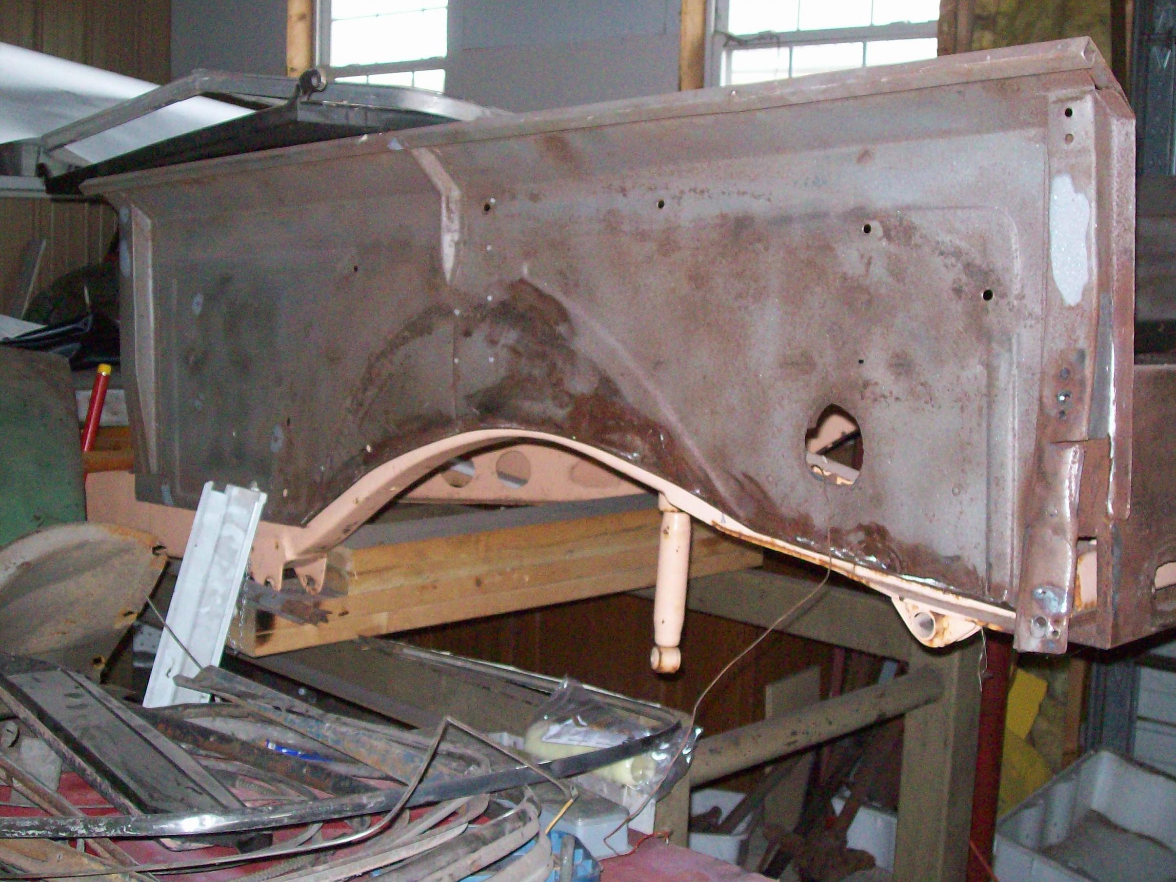

    Here's some more pics..

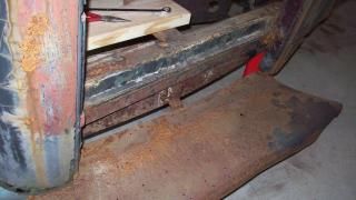

    The top was not cut in sections for the chop they reworked the area of the door jams to make up for the roof taper. It wasn't beat up just the elements made for alot of lower rust and pin holes above the windsheild and rear window were the moisture collected.
    The cab, running board and the bed were all welded to the frame, and the front fenders were welded to the cab and leaded in at the top edge, it also came with a 39 deluxe grill and hood
    It may have had a Olds in it at one time, ( there was a Olds with 6x2 on it in the garage but we didn't bid on it ) the motor was missing but had a 39 ford trans and banjo rear end, someone was hard on it, we have alot parts to replace in the drive line

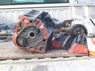

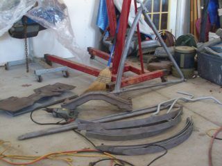

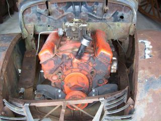

    bed was shorten and rivet back together
    283 sbc off to the machine shop

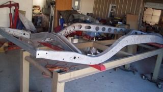

    clean parts to work with.
    boxing plates made and welded in the rear frame sections

    We are alot farther along, I'll have to post the rest of the pics, We got a good deal on powder coating and had the frame and all chassie parts done. Picking up the frame tomarrow, and Kyle had a 283 motor rebuilt and it's ready, It took 3 banjo rearends to find enough good parts to build one for the truck.

    We picked the frame and the rest of the chassie parts up from the powder coaters yesterday 1-5-2013
    and started putting it back together
    later kb

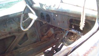

    HI; I think the steering wheel it is off a EZ-GO golf cart or a boat
    I'll take some more pics an add updates later today

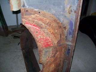

    We have all the powder coating done, motor is done , rework the dash to fit all the SW gauge that came with it and done alot of rust repair, still have to finish the front inner panels and mock up the grill,front fender and cab so we can section the hood, PO had the parts stashed in the garage but they never got finished

    We made and plates to lower the mount postion of the running board in the org build they were welded to the frame with angle iron, this way we can bolt them on.
    dash reworked to take a full set of old SW gauges that came with it.
